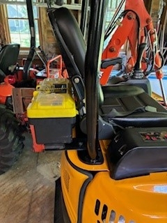

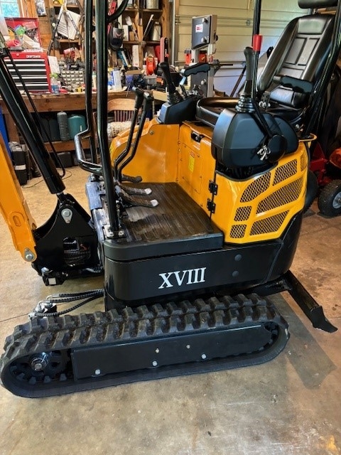

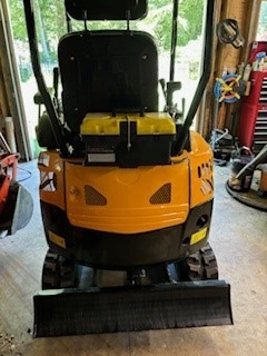

I got the Chinese Mini Ex Typhon 18 with the Kubota Diesel - weights in around 3500 lbs - no cab with Pilot controls. A cab is really tight on these small machines and hot in summer.
I have also switched the travel around sticks now to make more leg room (pics are before) as im 6-3 240 lbs
The other thing - these are SLOW moving so if you have a lot of area to cover it takes time
But for the $10K new (on EBay) they are decent machines but not the caliber of your JD50.

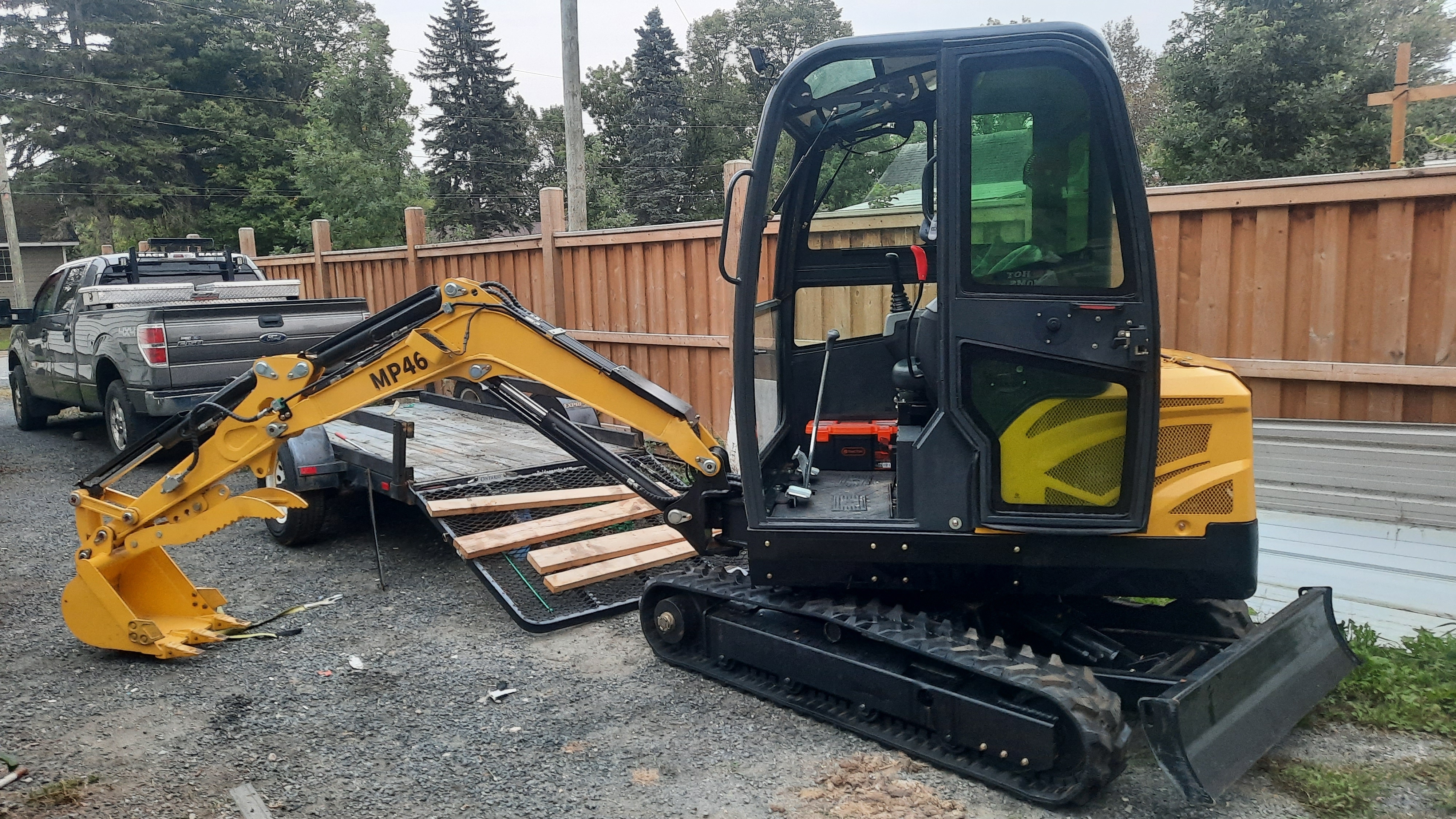

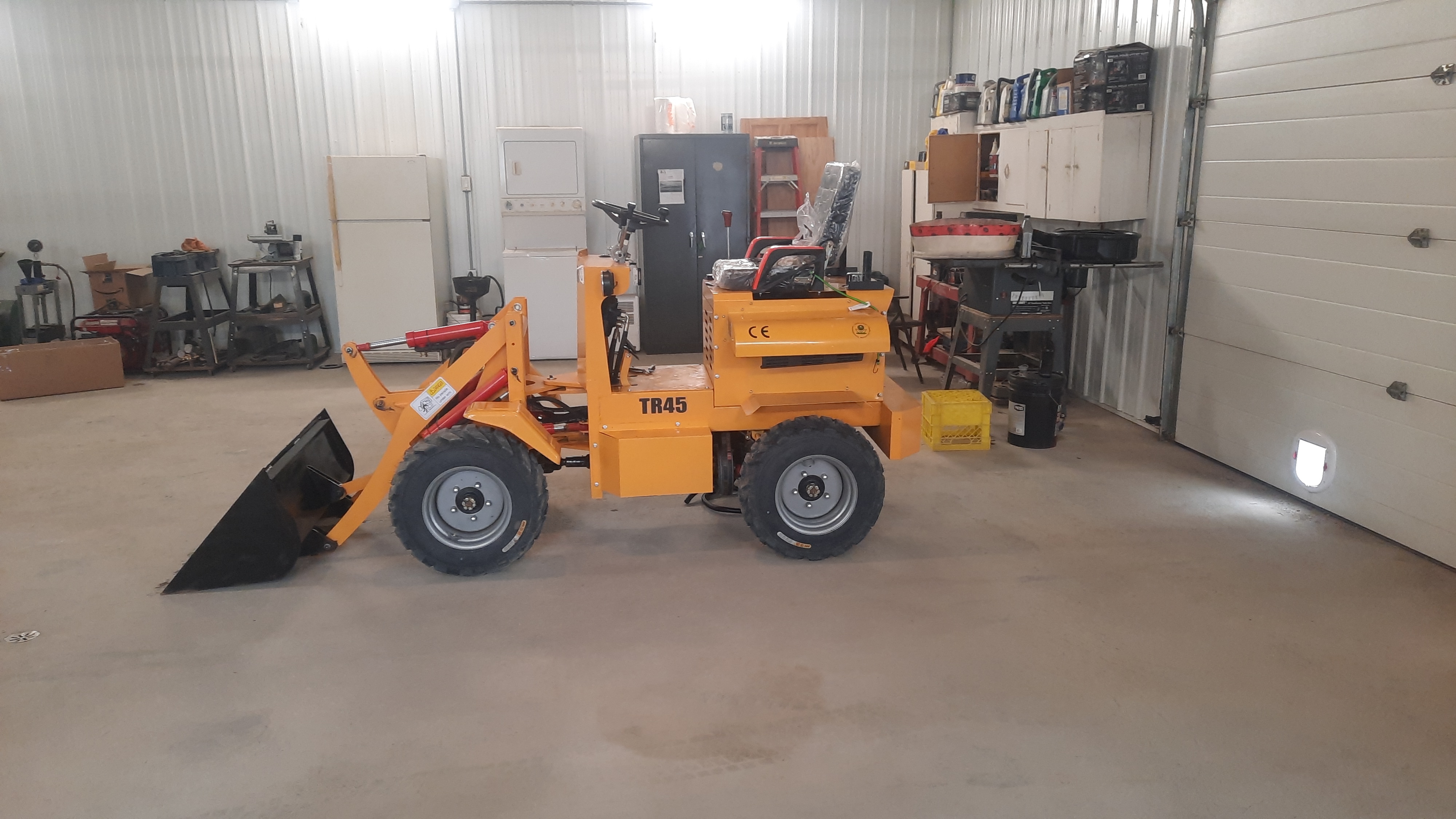

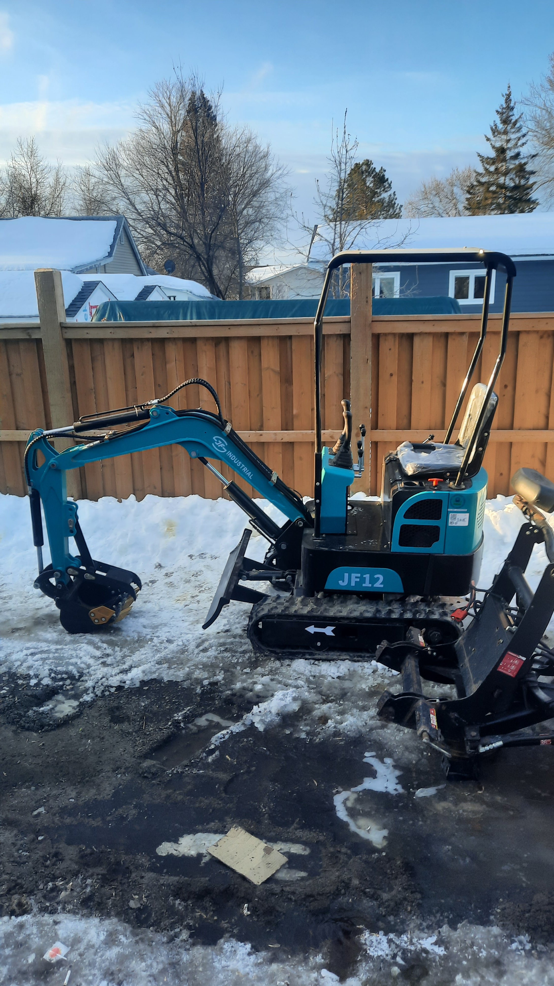

Have a FF12, 145 hrs, NO Cab! Hotter than the Sun (imagine) It has done alot of work at the Cabin, Trenching, Casings, Stumps, but yes Slow as a Turtle moving.
Had a MP46 2.5T Big Cab. Way more power but tore up any yard I drove it over. Need a Tandem Axle trailer to move. Motor wasn't a RATO but V Twin gas, a lot smoother than the 739cc Rato V Twins.

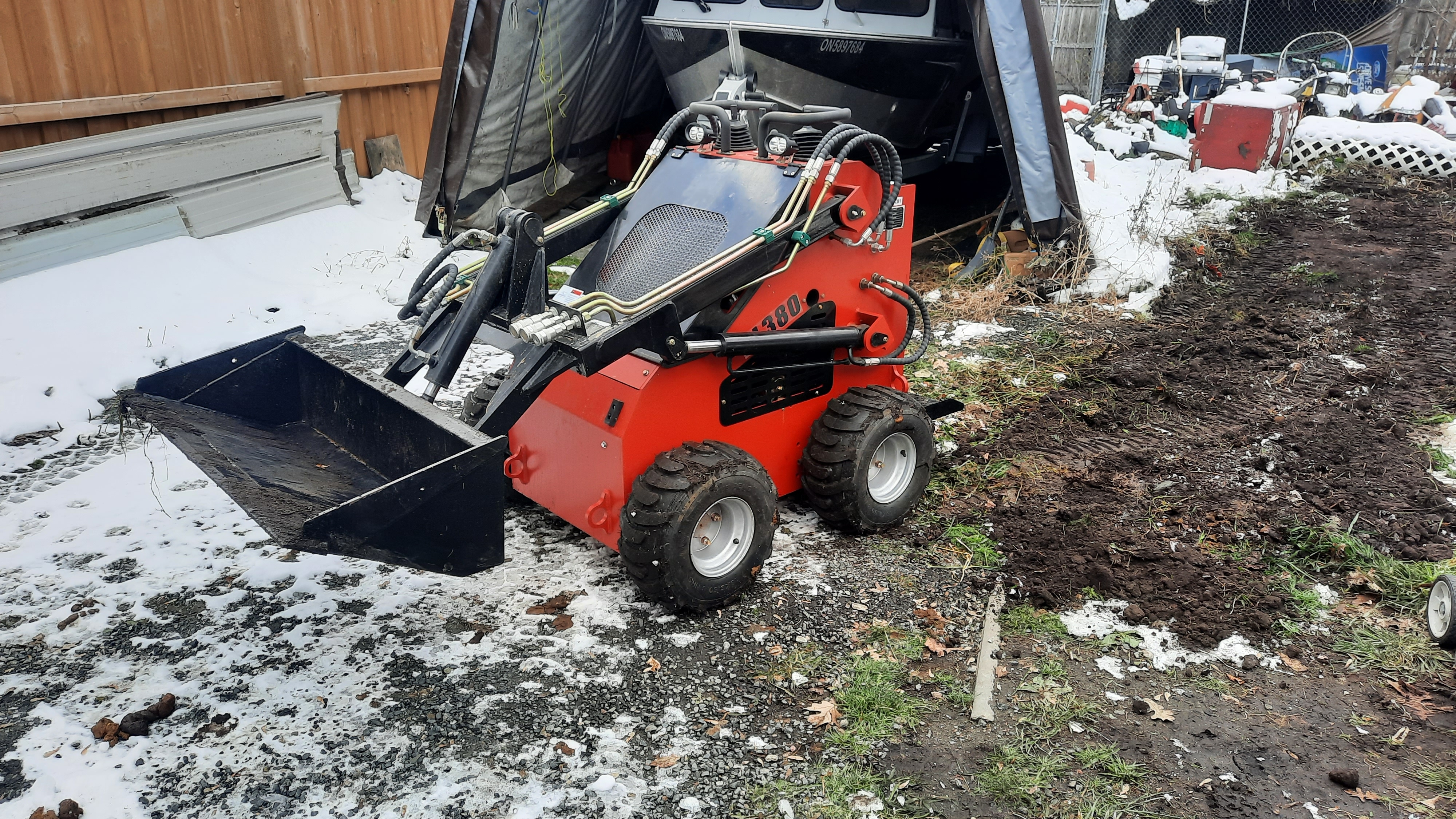

Have a SL380 Stand On Skid to move the Dirt and debris at the Cabin, much faster than the Mini Ex. Tires so minimal ground disturbance, but can be hard to Ride On, on uneven ground. Thought I would like a Sit On machine so I tried a Mini Wheel Loader. Gearing was Way Too High, Open Axles so it didn't have much pushing power.
Now I just picked up a Tracked Stand On Skid. Haven't used it much yet to speak of, but I think I prefer the Wheeled one so far.

So I assume the MP46 weighed around 5,000 lbs. I think it is about the size I would like if I could find a good used one. They want as much for used any thing as a new one. Will probably have to settle for one around 3000 lbs.
The MP46 came in around 3000lbs (estimate) Carried it on the pictured 3500lb Single Axle, but not far.
I sold that one for $17,000 CDN (maybe $12,000 US) with 5 hours of "Testing Time"

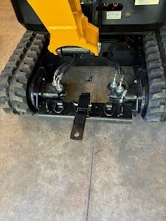

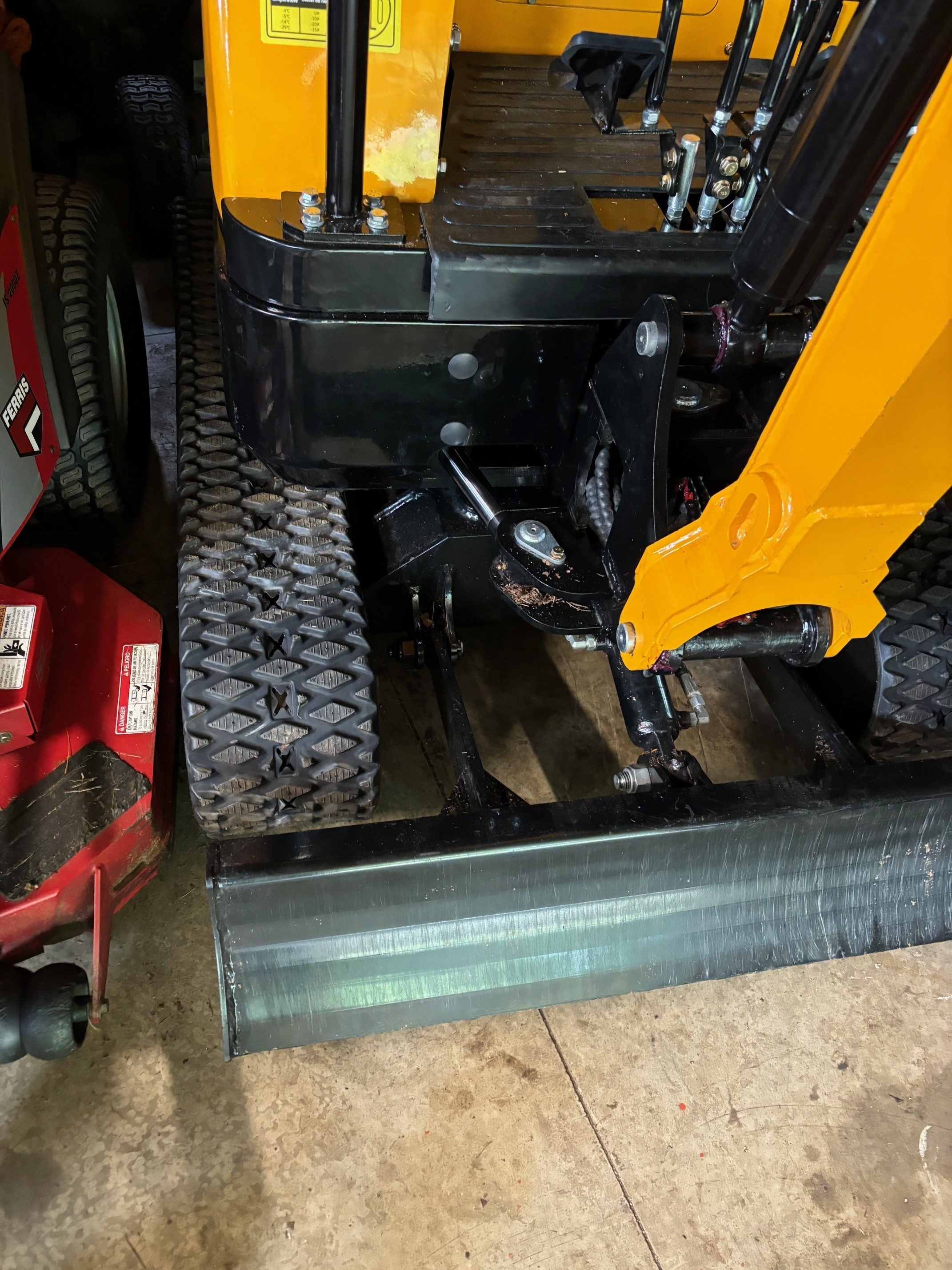

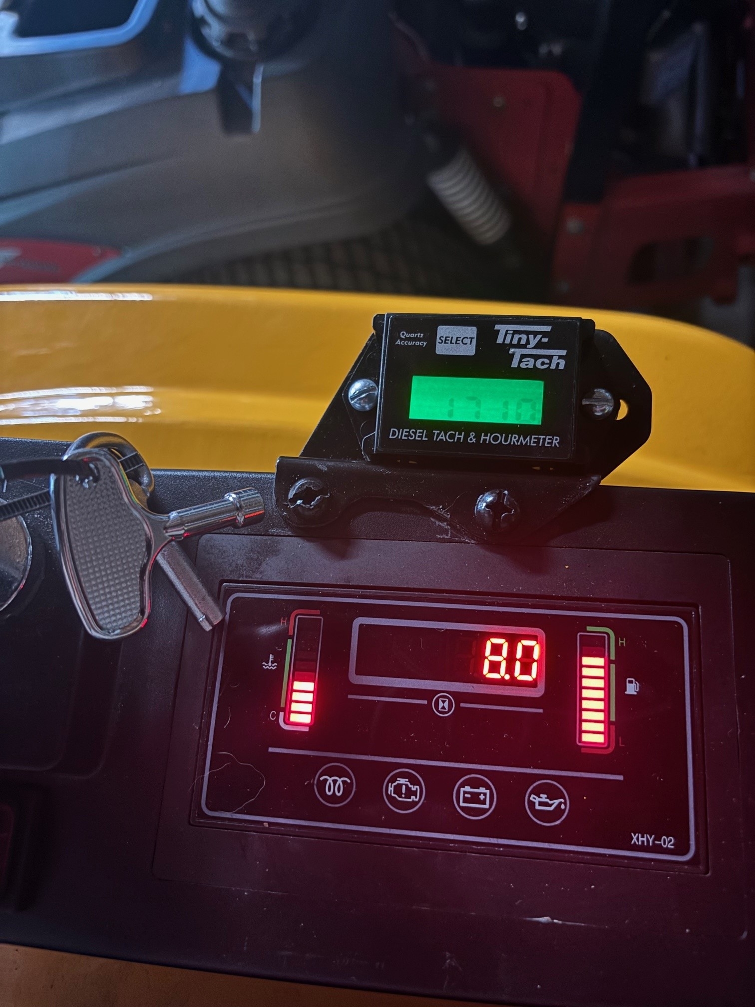

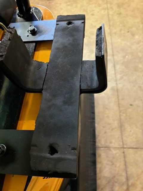

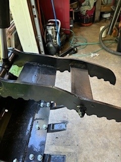

Yes, definitely get Pilot controls (thats all these 1.8T diesels have anyway). On my updates - spent about $600 total.
- Added a Tiny Tach - as I like knowing the RPM $100
- Reinforced the thumb - welded 2 - 3" wide gussets inside the thumb
- Added a rear hitch plate and motor protector $150
- Modified the thumb pedal so it worked better for me
- Reversed the travel levers for more knee and leg room
- Added a mount for the tool box behind the seat for the tools and fittings
- Changed out the 180MM (7") tracks to a 230MM (9") turf track - rides much smoother now and doesn't rip up turf $300
- Switched the boom and stick hyd lines so it now has backhoe controls like my Kubota TLB
- These small diesels have a Hyd Cooler, and also an 80 micron filter in the tank
- Change out the Hyd oil with AW 46 Fluid from TSC $50
These units have a 1 Year Warranty from Typhon in CA and they have a similar unit Typhon XIX which is made by Vote also a $10K machine. Mine is a HighTop made machine.

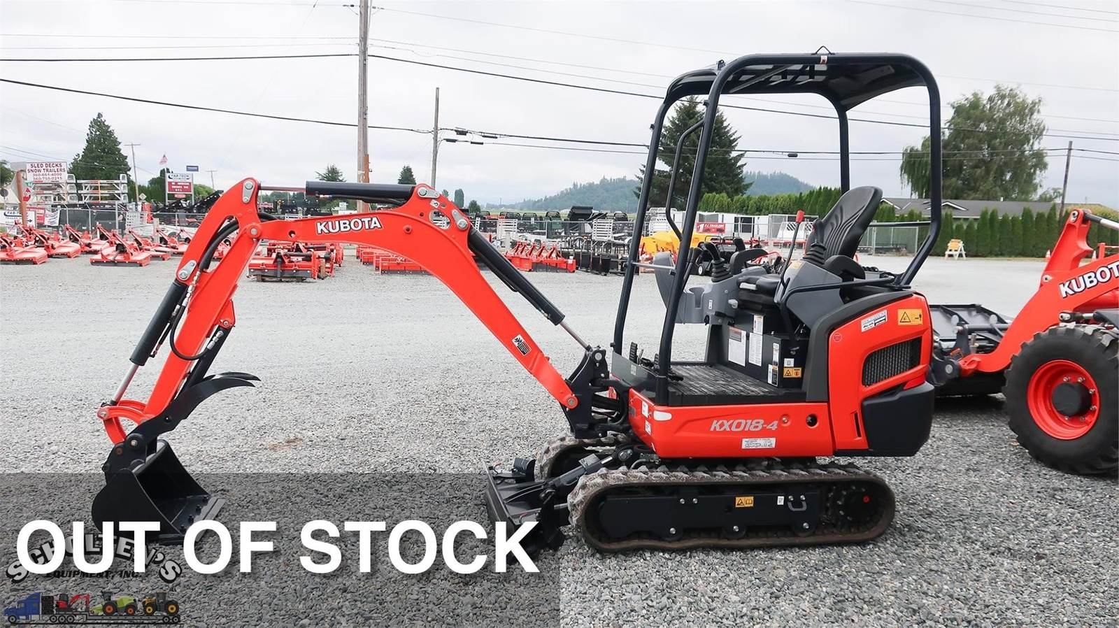

Go for it. Similar situation, I'm 68 had a JD 4410 35hp, with backhoe, not fun taking off and back-on. Sold that and purchased this Kubota KX018-4, half the size of a JD50, but as big as I could afford! Have done a bunch of work cleaning out driveway ditch, dug up bunch of invasive Russian Olives, dug up a few smaller stumps, being tracked, each to reposition. Get the thumb. Probably at least one size up if getting a cab.

MattB4 - see post # 8 on the first page of this thread - that sums up the mods I have done to it.
I did add a return Hyd filter on the right side under the existing radiator and oil cooler.
I would say the things really necessary are beefing up the thumb, and changing the Hyd fluids and adding a return line filter.
Findings: the standard bucket 17" is too big for rough ground and rocks, a 12" would be perfect on this machine, I have the 8" digging bucket, 32" tilt / grading bucket, and a 24" rock/dirt sifting bucket.
Also the auger is good OK, but in rough ground it doesn't have the pressure to dislodge rocks and just stops. These are 6-8" rocks all together with other rocks and I only have the 8" auger not the 12". If you have average dirt and occasional rocks it will likely do OK, but don't expect a skid steer performance.
All in all good machine for $11 K in my case, plus 2K in auger, buckets and mods.
