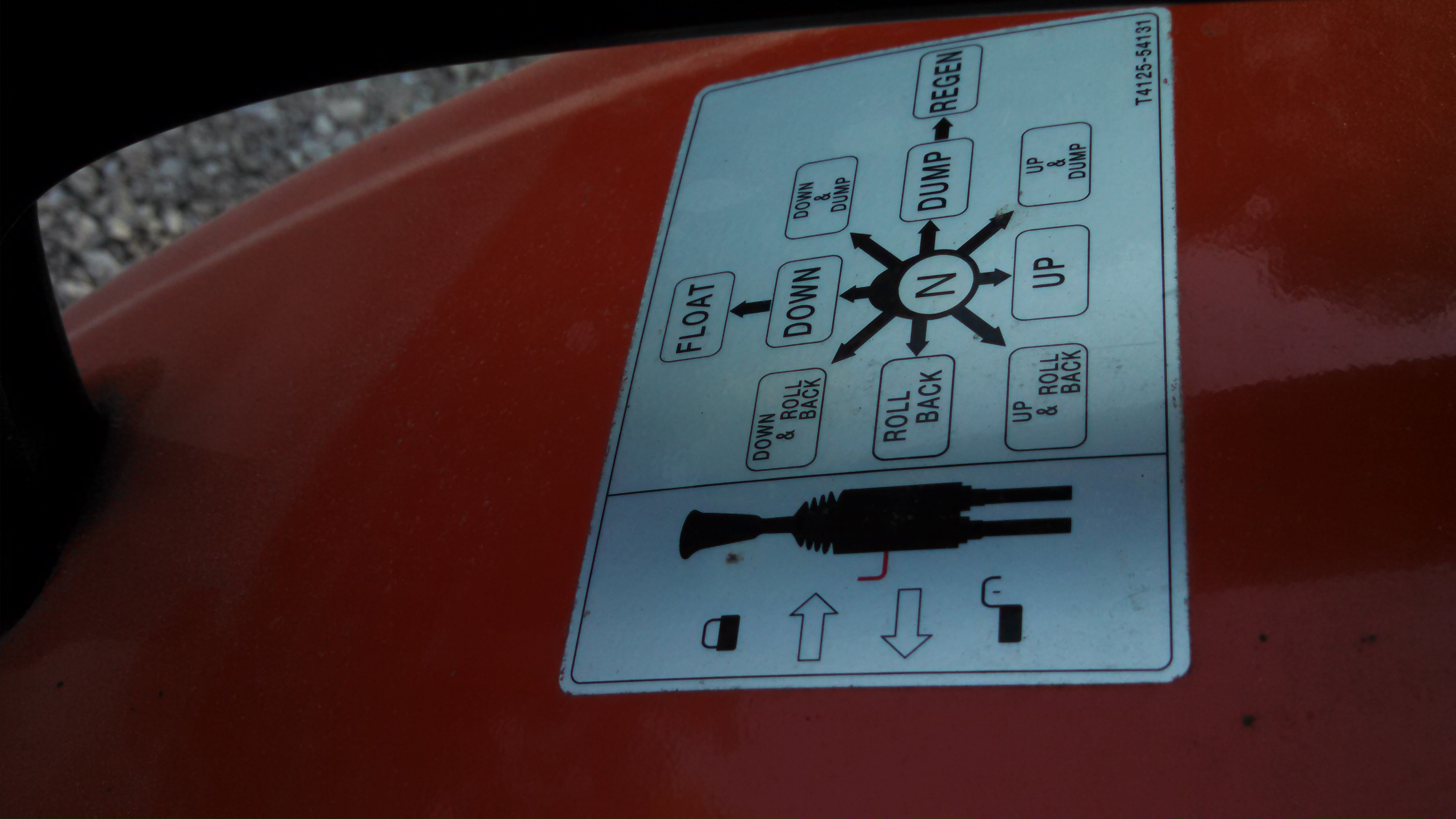

After this discussion and learning of regen.....I use float at little, but fast dump all the time. So I want regen.
   / Direction of flow from diverter valve #106
Not that this photo has any bearing on your Kubota, but here is what we were talking about in this photo. This is the fender sticker on my Kioti, notice the regen function to the right of the dump function as you move the joystick from Neutral to the right. IMG_20140703_185834_365.jpg
