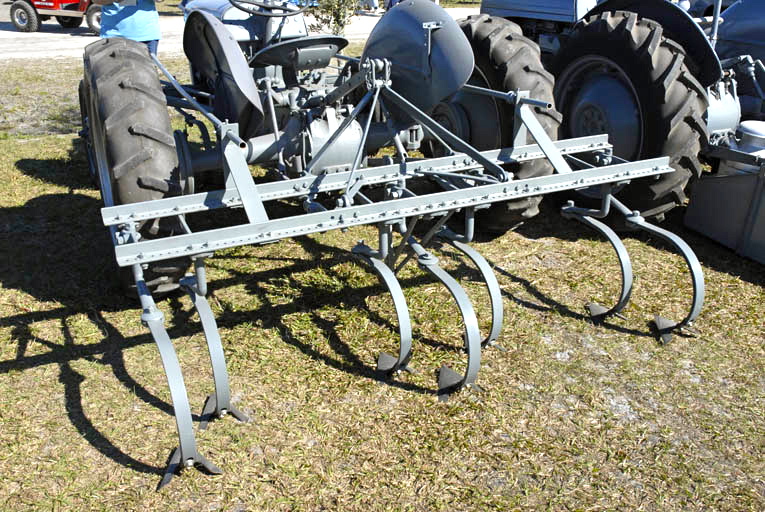

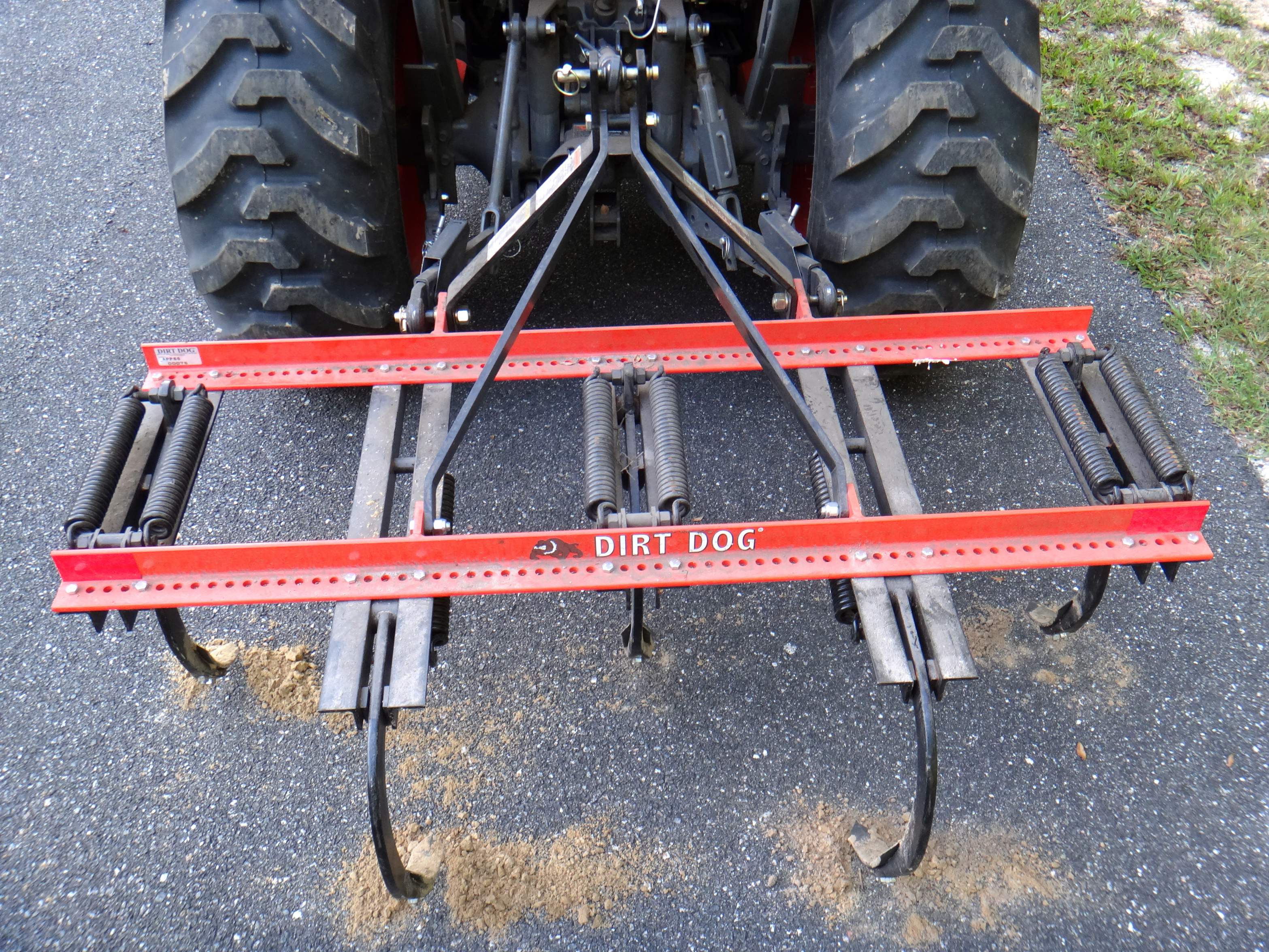

Dirt Dog All Purpose Plow / Field Cultivator
Dirt Dog Model APP 66-5
Total Width 66", Working Width 62", Five Tines, Weight 284 Pounds, Paid $835.00 (2010)
Field Cultivator: A Three Point Hitch mounted, secondary tillage implement, used to perform operations such as soil aeration, sub-surface vine and root removal and eradication of deep rooted weeds. Field cultivators are equipped with parabolic curved steel tines, typically spring mounted, to permit the tine to move within the soil and shatter clods. Field cultivators are constructed similarly to chisel plows, but are more lightly built. (Used to aerate compacted residential lots prior to installing irrigation and/or laying sod.)

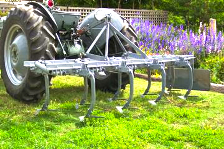

Today the Field Cultivator/All Purpose Plow is NOT one of the best known Three Point Hitch mounted implements. It is, however, one of the oldest designs, having been patented by Harry Ferguson, inventor of the tractor Three Point Hitch, in 1932-1933. The other earliest Three Point Hitch implements were the Ferguson Moldboard Plow, a Ferguson ridger for potato cultivation and a Ferguson row crop cultivator. (Photo#14)
Harry Ferguson, the inventor, termed this implement a 'Tiller'. Ferguson patented arrangement by which the tines are spring loaded, allowing them to kick back if an obstruction is encountered, then return, undamaged, to their normal operating position. Field Cultivators sold today are contemporary replicas of the 'Tillers' sold by the Ferguson organization from 1934.
Today, subject implement is termed a Field Cultivator or an All Purpose Plow. Field Cultivators are available in widths from 54"/Cat 1 to 173"/Cat2, with three to nineteen tines, for subcompact through utility tractors. The three USA marketers are Dirt Dog, Bush Hog and Fred Cain. (LINKS at page bottom.) Former producers were Ferguson, Ford Dearborn, Leinbach and Bush Hog, probably others. Wider, heavier Field Cultivators are available for the Big-Ag market.
The Field Cultivator and its heavier relation, the Chisel Plow, are both used for conservation tillage. (Photo#5/APP, Photo#6 Athen's Chisel Plow; both manufactured in Georgia.)

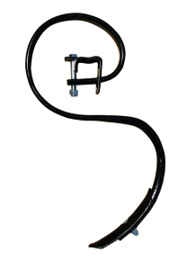

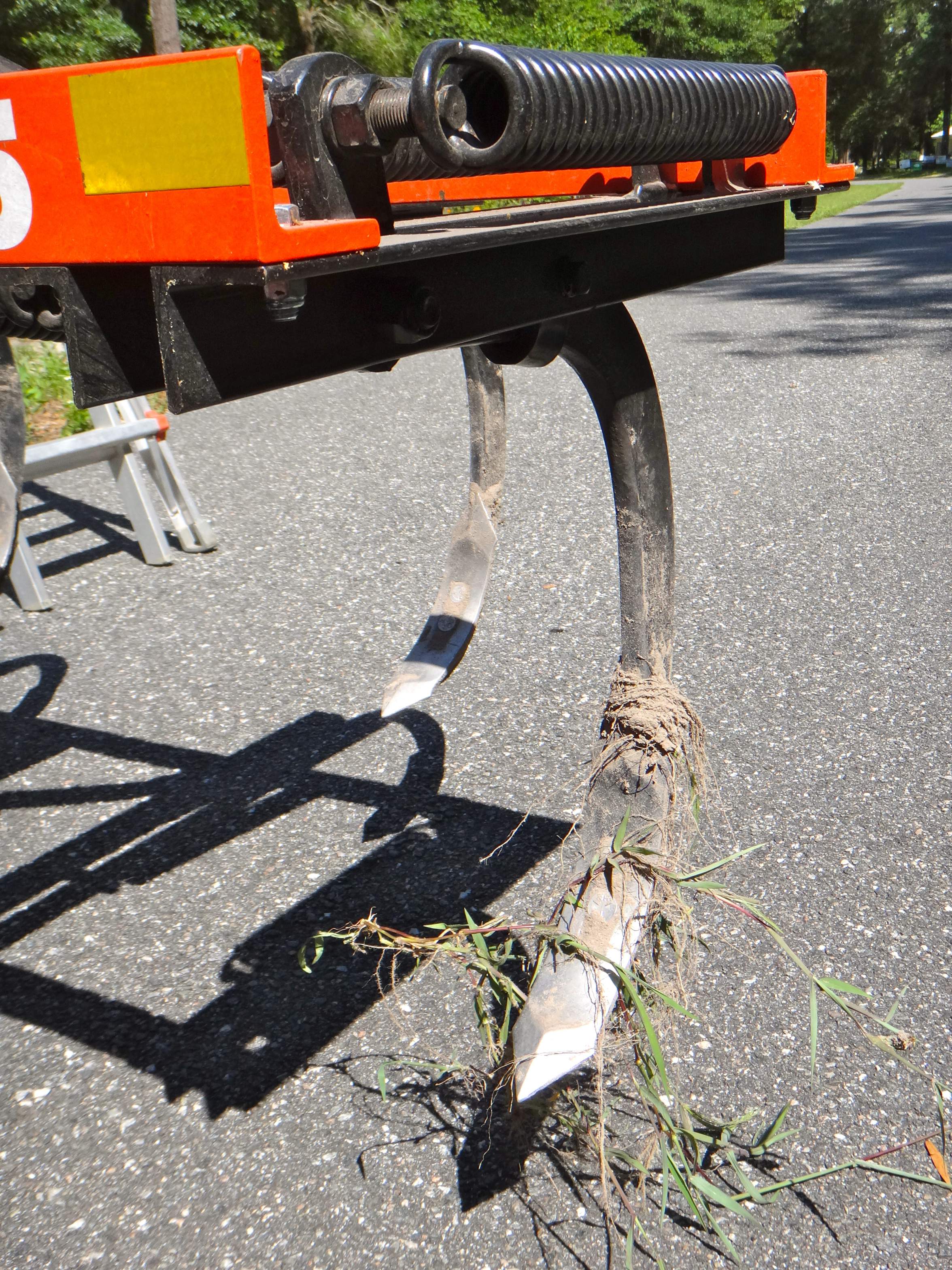

Field Cultivators and Chisel Plows have parabolic shaped tines in common. Parabolic tines pull much easier through soil than angled shanks, such as those equipping Box Blades. From my observation, this is because parabolic shaped tines have the forward part of the tines in nearly a horizontal position working the soil. Field Cultivator tines are tipped with sharp, chisel points further reducing draft resistance.
Each sharp chisel point on my Field Cultivator is 2" X 10" = 20 square inches, oriented horizontally. Chisel points are uniform 5/16" thick. Tines are 1/2" wide.

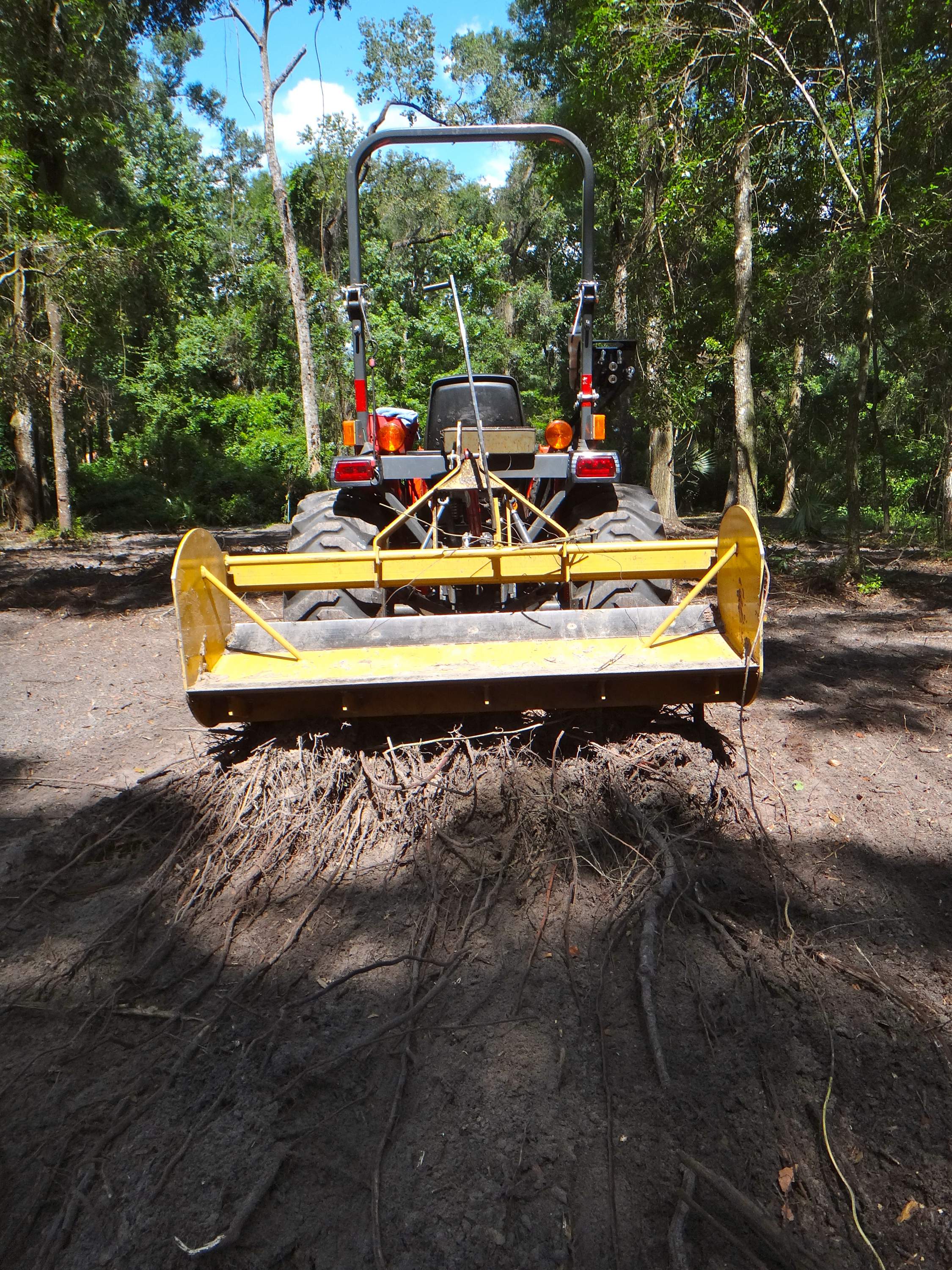

Box Blade shanks are angled at 45 degrees to reach the bottom of road potholes and chip out surrounding hard road surface. They are designed for rigidity to apply bludgeon force. Box Blade points have an edge but get fat immediately.
Each Box Blade ripper point on my Rollover Box Blade is 1-1/4" X 5-1/4" = 6-1/2 square inches, oriented at 45 degrees. Orientation at 45 degrees hugely increases draft resistance. Box Blade shanks are 5/8" wide.
The engaged five tine Field Cultivator pulls easily, relative to my five shank Rollover Box Blade, with shanks down.

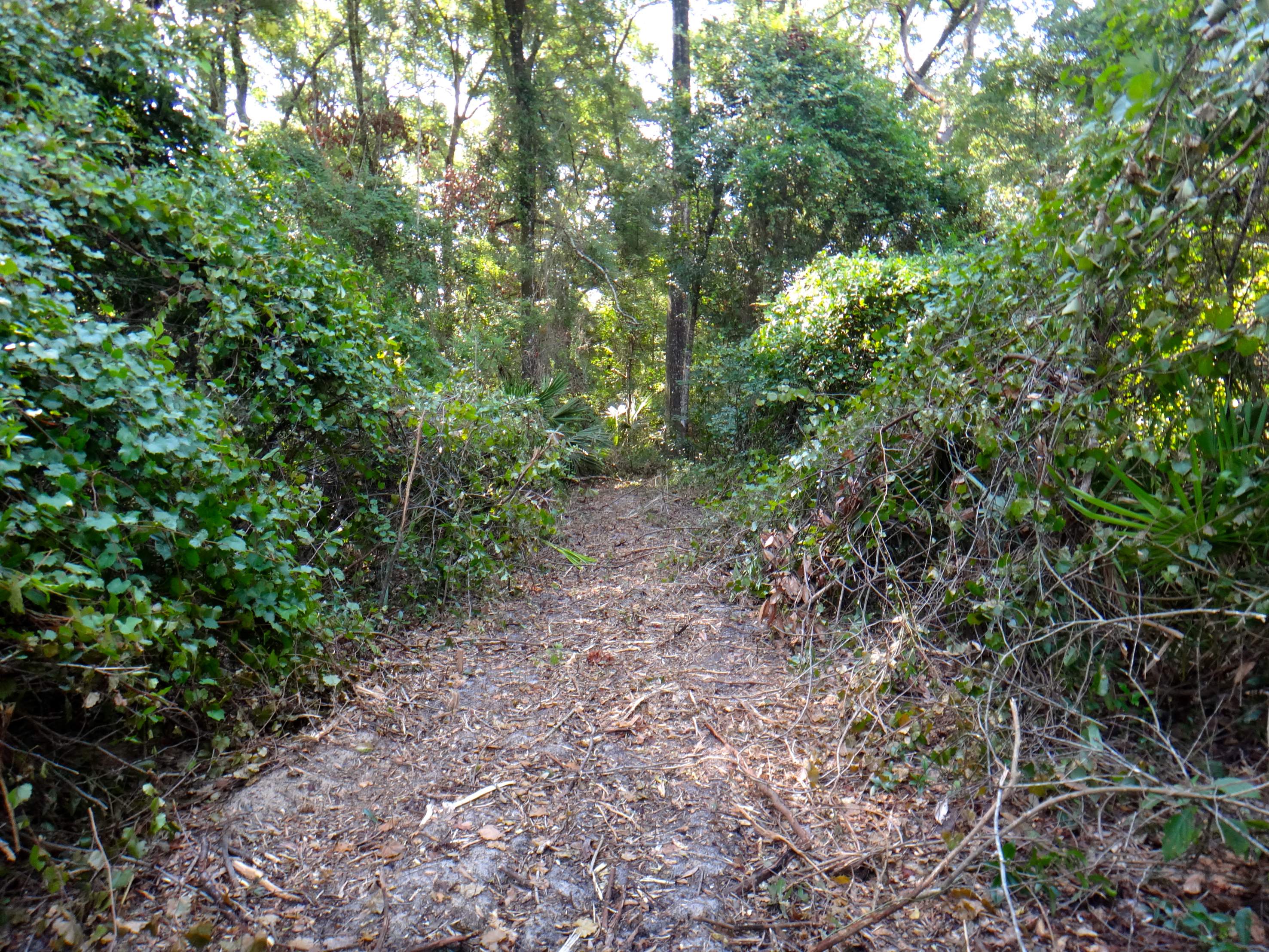

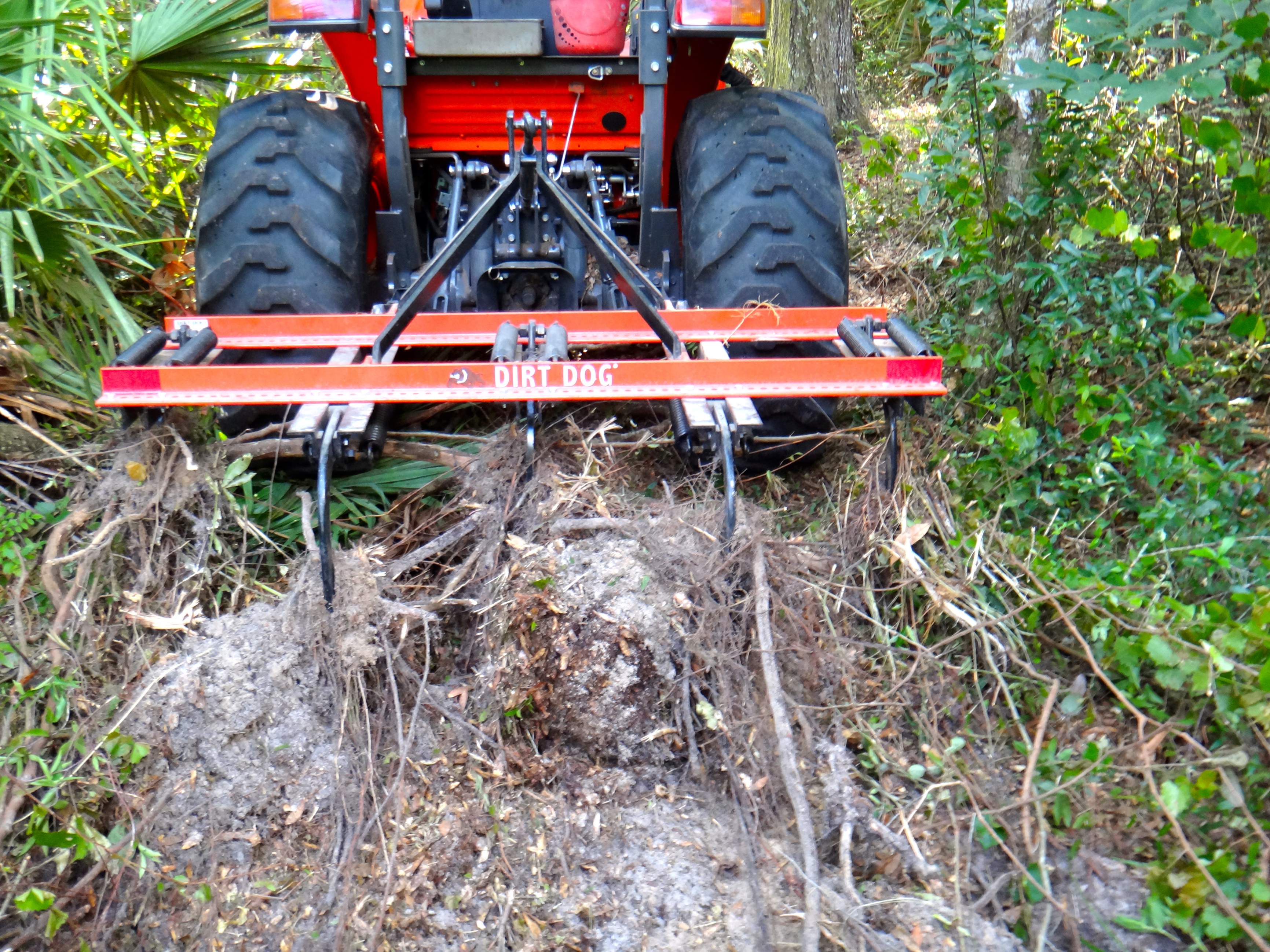

I primarily use my Field Cultivator for removing subsurface wild grape vine roots and runners from recently debrushed and thinned Oak woodlands, where I intend to seed game food plots. (Photo #10) Primary brush removal attachment is a Ratchet Rake on Kubota L2296 Heavy-Duty Round-Back bucket. Land once was cattle range.
This week I used the Field Cultivator to drag out wild grape vines and a few wild roses, (vines and small corms) growing up the trunks and into the crowns of native Water Oaks. Water Oak roots grow straight down into the soil, so I could back the Field Cultivator up against an Oak's trunk, lower the implement and PULL. Tractor pulled in HST/LOW. (Photo#9 + Photo#11)
Parabolic tines "cup" shallow vine roots, so the implement can drag unwanted vegetation out of the soil without runners fragmenting. (Photos #9,#10,#11)
At the end of a pull, when the Three Point Hitch is lifted, the Field Cultivator self cleans reliably.
I made the right decision in selecting a five tine model rather than a seven tine model for my Kubota L3560. Both five tine and seven tine variations share the 66" X 2-1/2" X 2-1/2" angle iron frame. Seven tines in the soil would be too much for my mid-weight compact tractor.
I pulled the Field Cultivator a short distance through a Bahia grass pasture. Field Cultivator tines/points sucked into the soil like a Moldboard Plow, all the way to the frame, aerating deep. The Bahia appeared fine when I finished. It will be a few days before I can be sure of Bahia recovery. Draft resistance on tractor and implement was moderate.

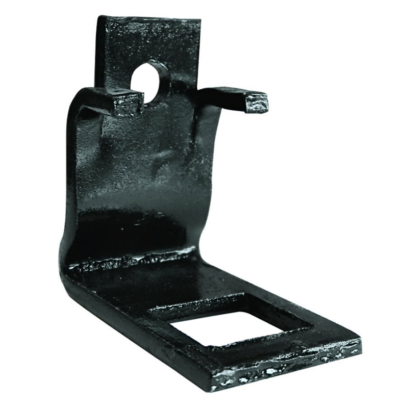

I would like the option to substitute 5 X 10" width, shallow-cultivating row crop sweeps for the chisel points bolted to the tines, to expand current cultivating width of the points from 10" per pass, (5 x 2"=10") to 50" (5 X 10" = 50") with sweeps. I have pictures of Ferguson 'Tillers' fitted with sweeps in England. (Photo#13) However, I have not been able to find sweeps to fit 1/2" width tines.
Row crop sweeps from TSC, Agri Supply, Nichols Tillage and Wiesse are dimensioned to mate with 1-3/4" width shanks on Big-Ag Field Cultivators, not my 1/2" width tines. Also, 1/2" width tines mean I need to use a 1/4"-20 bolt and nut, rather puny considering the draft force exerted on a 10" sweep. (Some report welding on sweeps.)

I would like to occasionally substitute 5 X 10" width, shallow-cultivating row crop sweeps for the chisel points bolted to the tines. I have pictures of Ferguson 'Tillers' fitted with sweeps in England. (Photo#13) However, I have not been able to find appropriate sweeps.
CORRECTION RE: Ferguson Sweeps
LINK Ferguson BO-20 Tiller Parts List: Tine Assemblies, Soil Engaging Parts (3 pages)
See page 3.
Ferguson sweeps are standard bolt on design. Sweep attachment bolt size is specified as 7/16"-20, so Ferguson tines must have had greater tine width than Dirt Dog 1/2".

Five additional photos:

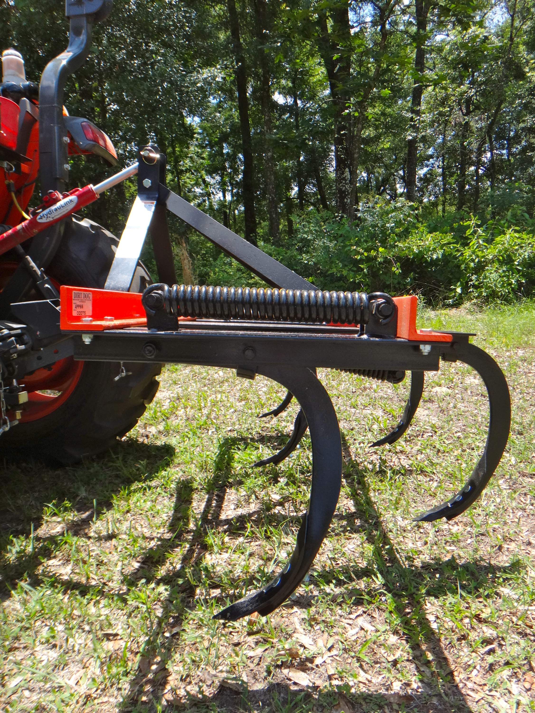

Photo #17 Beauty shot; no shadows.
Photo #18 Beauty shot side view.
Photo #19 Drop from bottom of frame to chisel point is 18".
Photo #19 Aerating dry, compacted Bahia Grass cattle pasture in HST/LOW + 1/2 throttle.
Points are in ground 6" - 7". Had the grass been shorter points would penetrate deeper.
Photo #20 Maintaining bare dirt area around community burn pile in HST/MED +1/2 throttle.
Points are in ground 12" - 14".

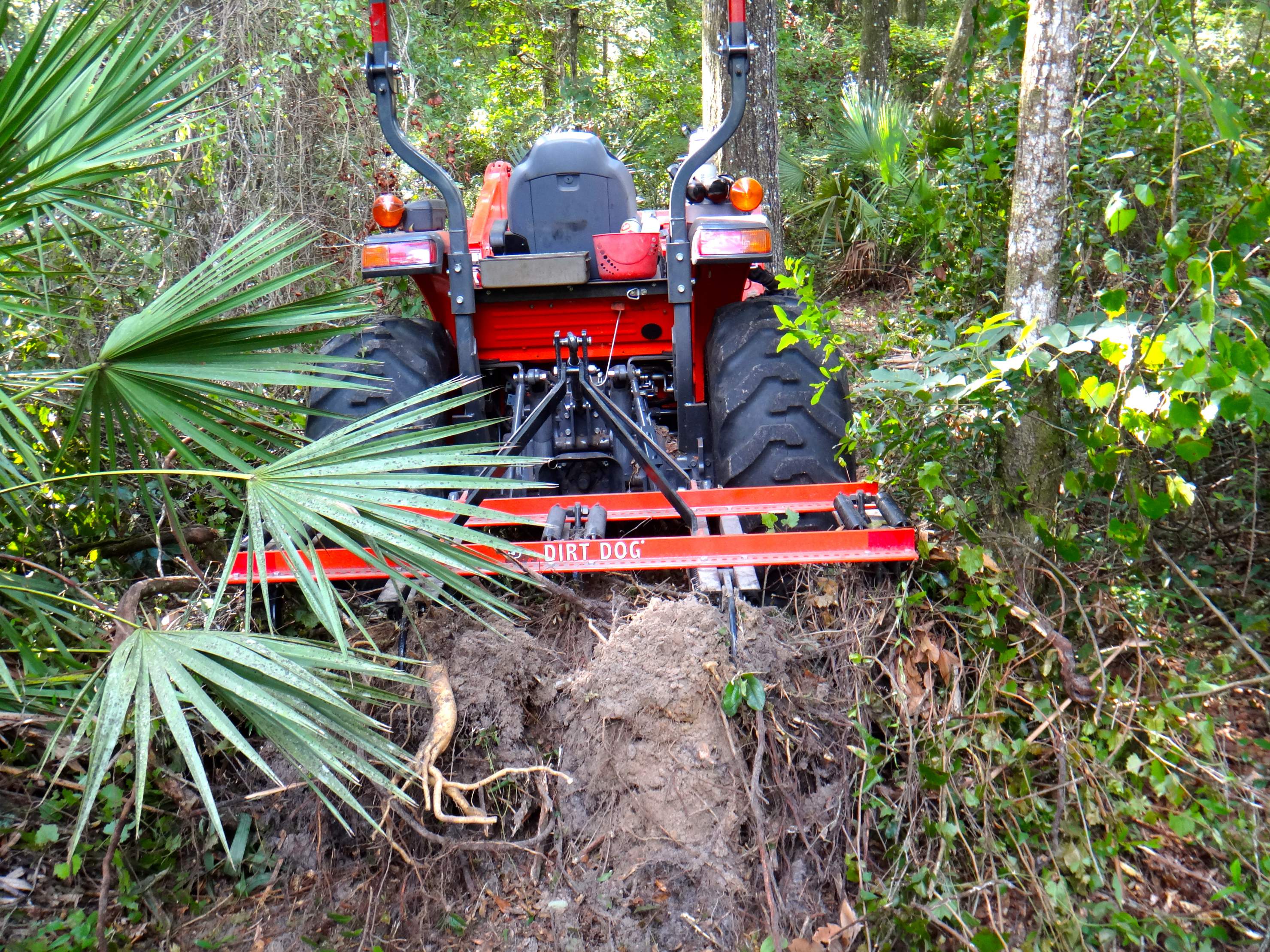

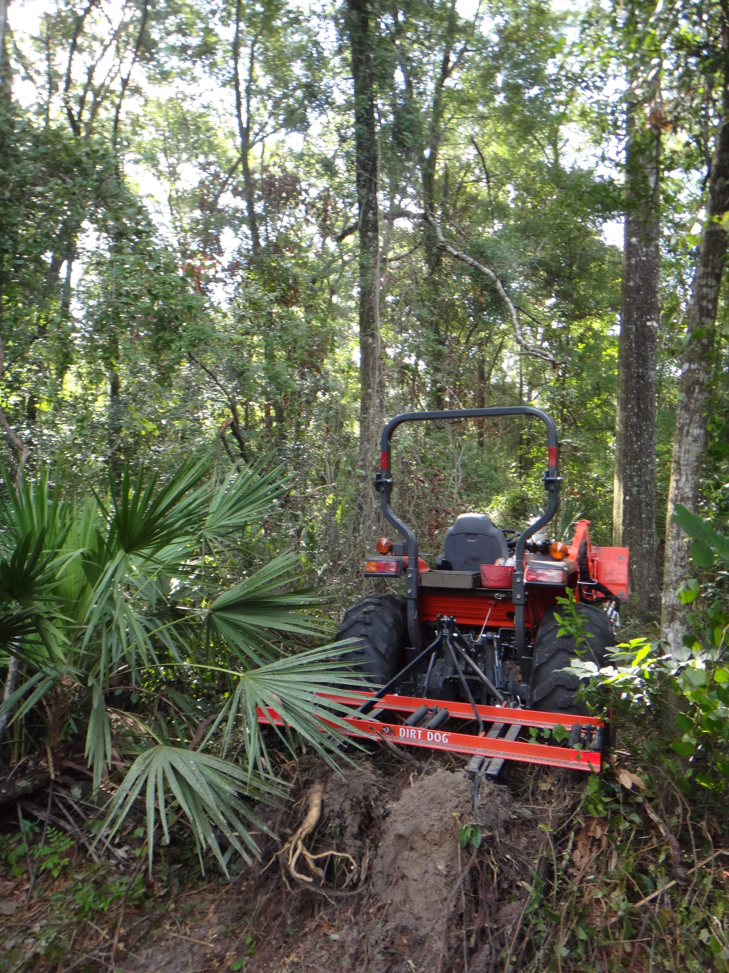

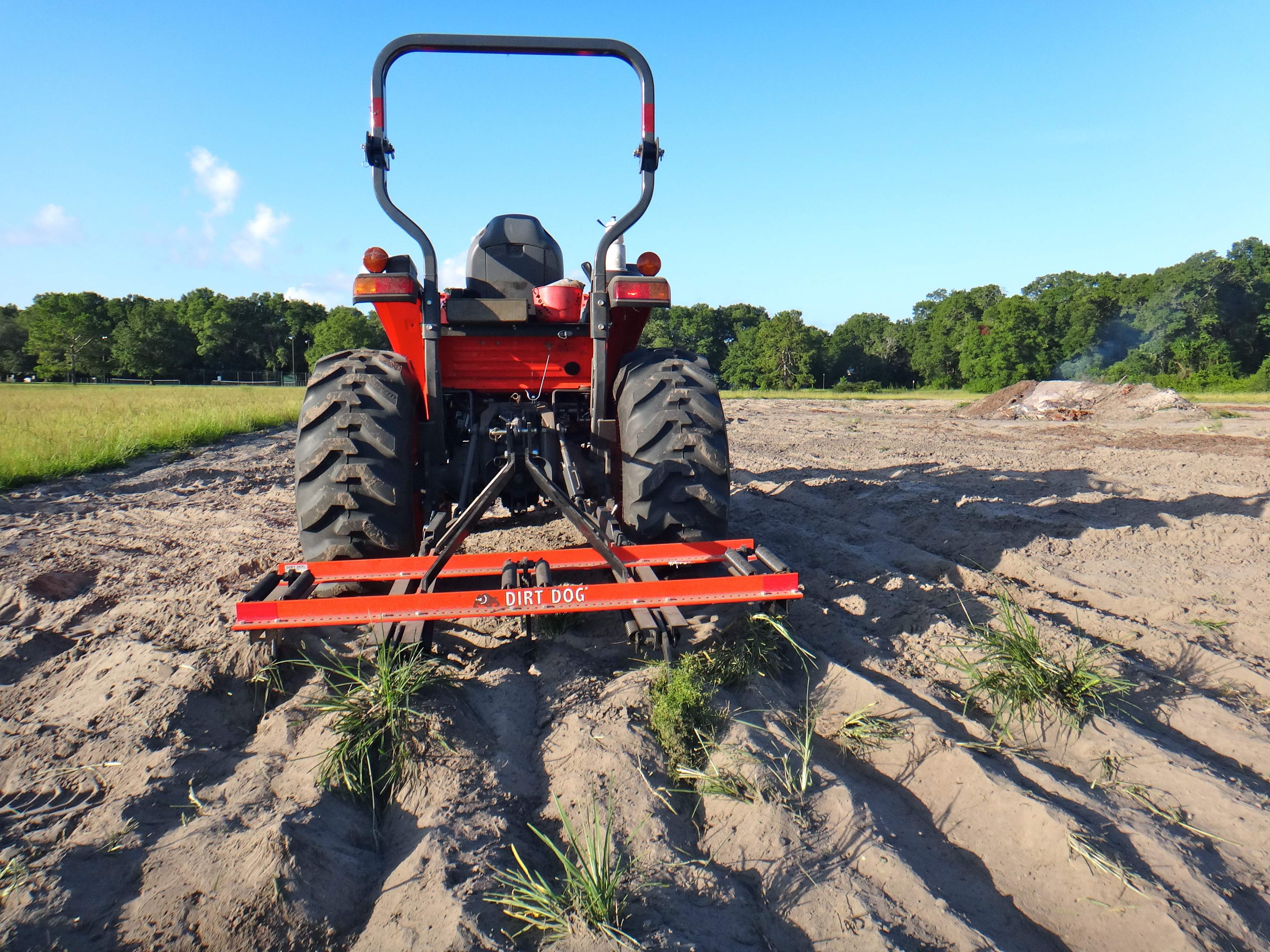

Photo #1 I pushed through thick wild grape vine growth, visible to left and right of track, with tractor and Land Pride RCF2060 Rotary Cutter on July 4, 2015. Impenetrable to a human prior to cut. Yes, this is excellent snake habitat.
Photo #2 First pass with Dirt Dog APP 66-5.
Photo #3 Vegetation pulled from soil after first pass, Photo #2.
Photo #4 same
Photo #5 Second pass with Dirt Dog APP 66-5. Soil mostly clear of roots.
Photo #6 Vegetation pulled from soil after second pass, Photo #5. APP is lifted.
Photo #7 You need to be alert in the woods. Note "WIDOWMAKER" branch detached from tree, suspended in dead vines, poised to crash down. Perhaps 60 pounds in weight.

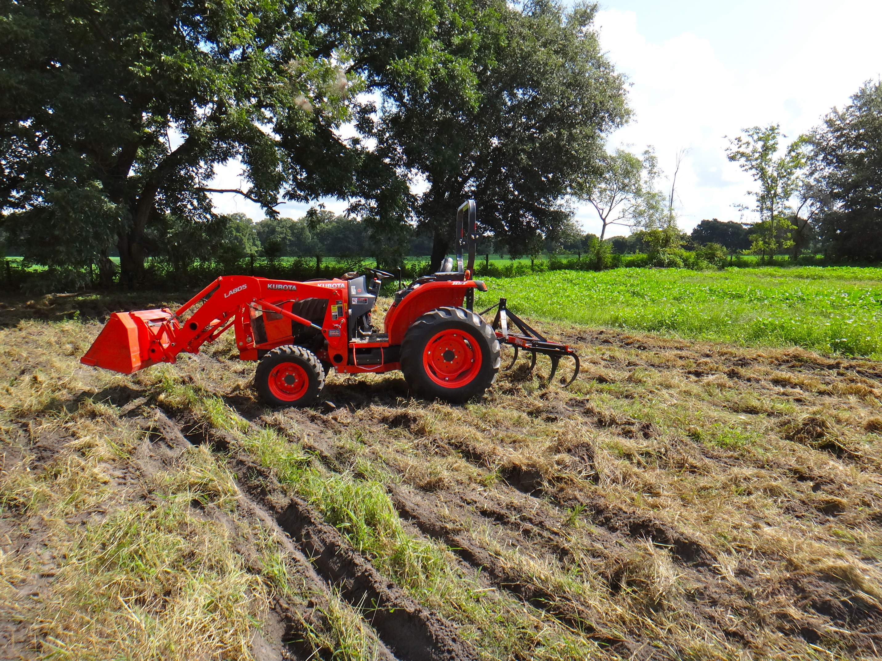

Photo #10 Same. Field Cultivator is adjusted for maximum depth. When slack is pulled out, and tines in soil are pulled back against springs equal to draft force, chisel points will have just a bit of 'down' angle to them. Field Cultivator "sucks" into soil like a moldboard plow. A later planting of Austrian Iron Peas in adjacent strip. Four hundred acres of unirragated Peanuts beyond the fence.

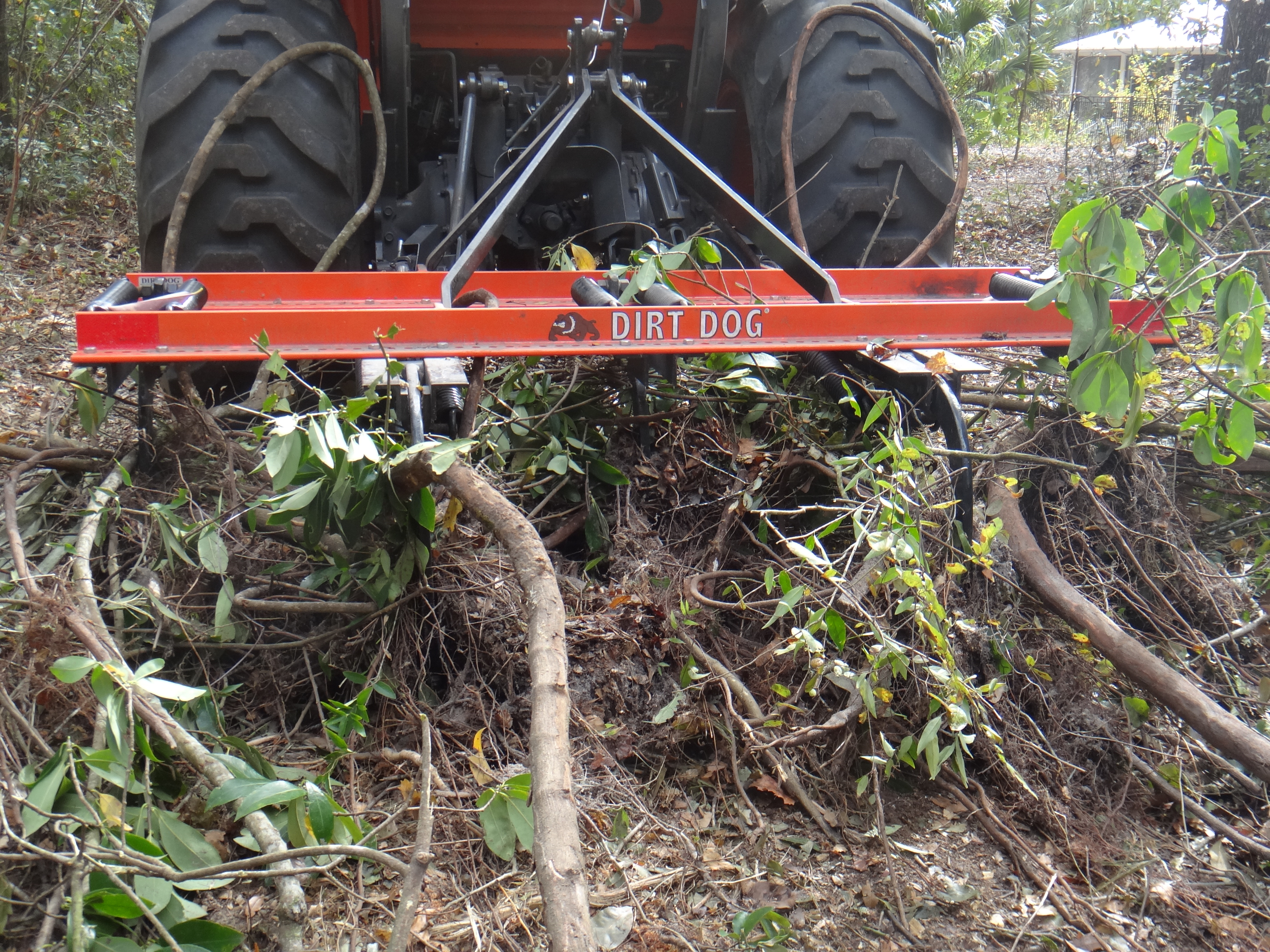

December 1, 2016 Pictures​

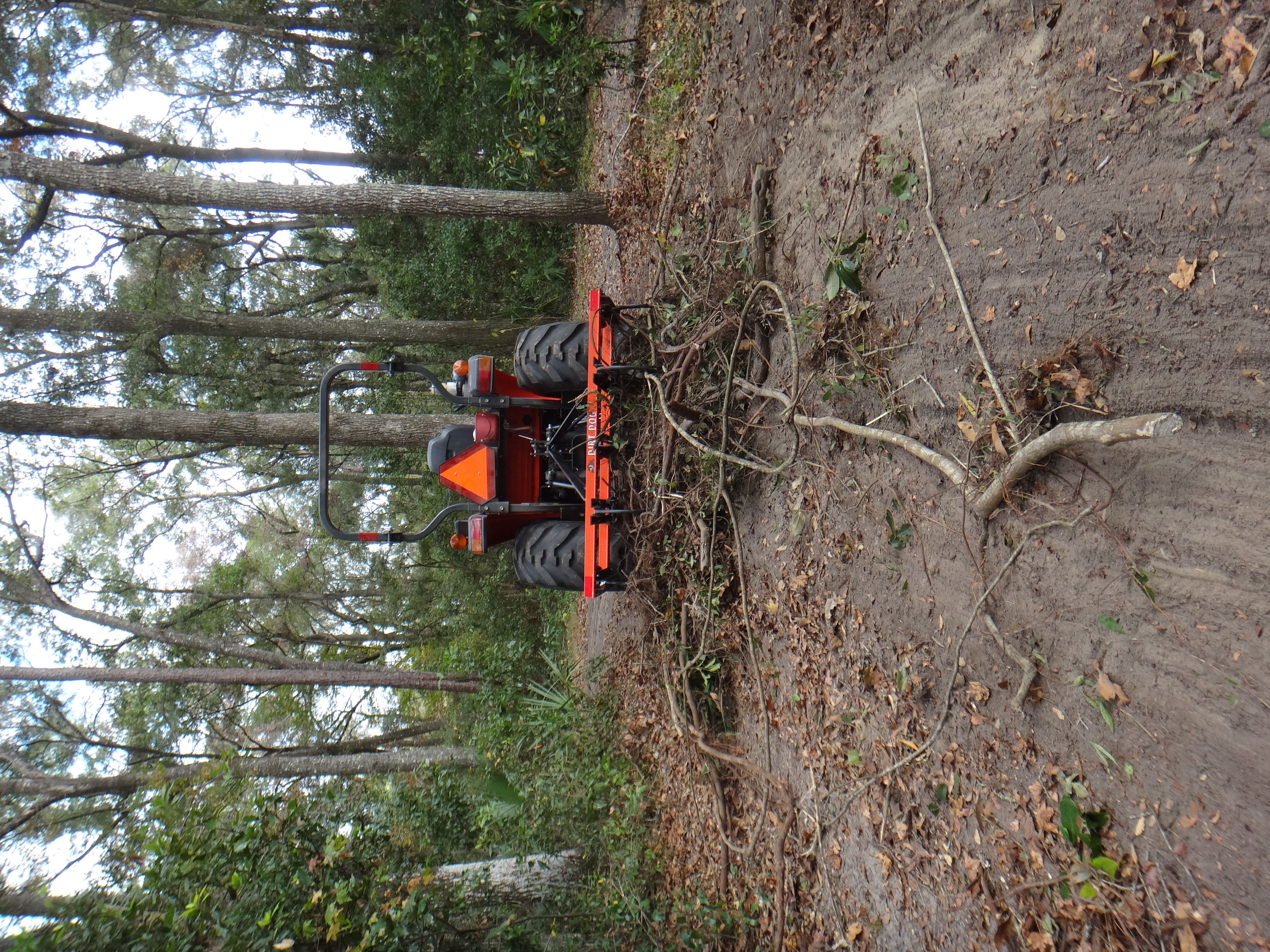

Photo #1 - Photo #4 Dirt Dog APP pulling wild grape vines from woods soil.

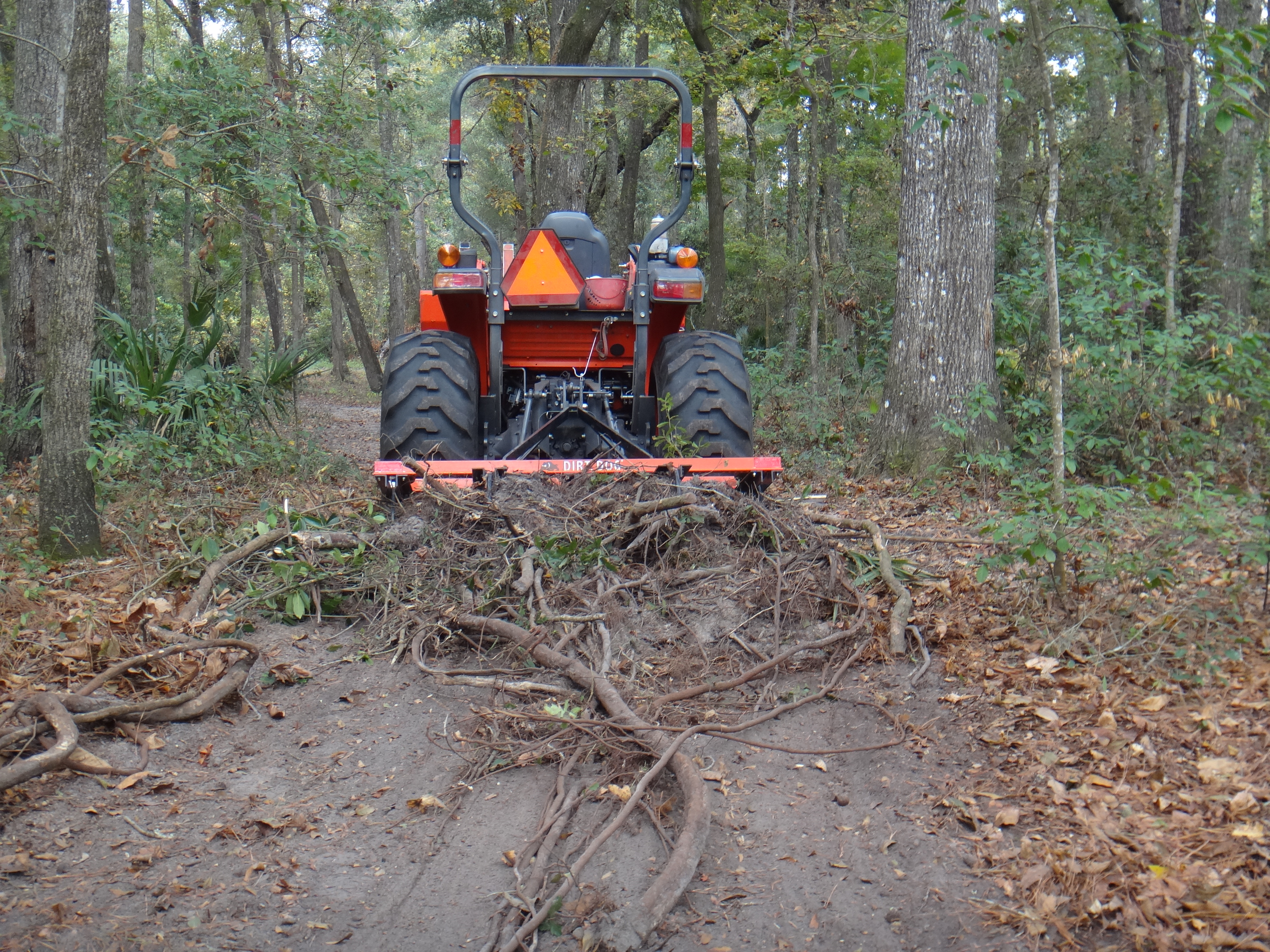

Photo #5 - Photo #6 Consolidated vine piles being dragged to community burn pile. APP raised with hydraulic control until points are 2" above ground. Top Length is long in order to orient points upward slightly, to grip vines. Vines so 'hooked' can be dragged long distances with hardly any loss ~~~ as a bonus you get a clean swept trail.
