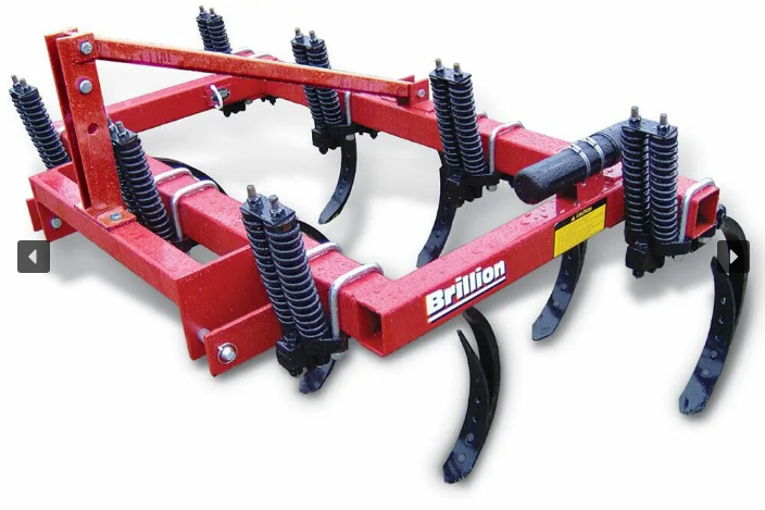

I am following your discussion on the All Purpose Plow. I have a 3,700 pound bare weight/60-horsepower Kubota MX6000. I’m considering the plow for deep soil prep in the fall and spring, then using a walk behind tiller for garden soil prep and summer cultivation.
I am considering a 9 shank Fred Cain APP from EA because they will ship to New Mexico for a small upcharge. I also sent a message to Dirt Dog to see what they can do. Are these 2 units comparable? What are your thoughts?
Without any proof I will speculate that the APPs from Dirt Dog, Fred Cain and Bush Hog originate in a single asian plant. Disassembled, about a zillion APPs could be shipped in one 40' container.
The older Leinbach, Ferguson, Ford Dearborn and older Bush Hog APPs were somewhat beefier than contemporary versions and 'points' could be interchanged with 'shovels' for row crop cultivation. The contemporary Braber APPs, produced in western Canada, likely with a USA distributor in Washington state, weigh a tad more than the current Dirt Dog, Fred Cain and Bush Hog offerings -- Braber 7 tine = 450 pounds, Fred Cain 7 tine/66" = 400 pounds, Fred Cain 7 tine/85" = 415 pounds.
I would check with ETA for an opinion on whether a 4-WD MX can pull a nine (9) shank APP, or if a seven (7) shank APP would be a better match. Your MX is the same bare weight as my L3560. My tires are inflated with air. If your larger rear tires are liquid filled your 60-horsepower tractor will have considerably more tractor grunt than my 35-horsepower, same weight, tractor. Still, I think seven (7) shanks will be all your 4-WD MX can sink and pull.
If you will be working more than twenty acres or so, consider a heavier compact tractor Chisel Plow from Buckeye Tractor in Ohio.
