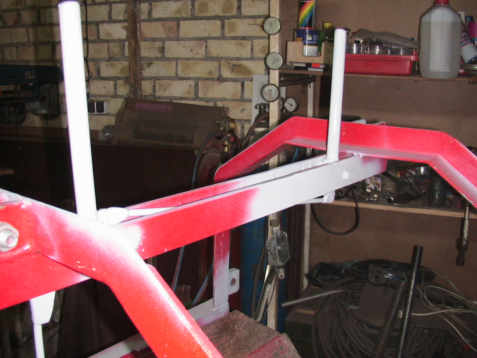

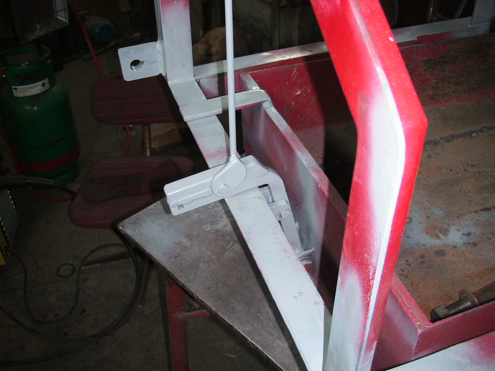

During my research, I repeatedly examined your 'menagerie of metal'... in absolute amazement. I would be interested in seeing a close-up of your linkage that you fabricated to trip the bucket.
Daryl,
In my QH thread I posted a pretty close picture of the linkage. It is not anything rocket science. Just 2 pieces of 2 inch rod with a hole drilled in the centers with handles and connectors for the linkage welded on. The handles pivot on the 2 inch shaft pieces between the top pieces.
here is a link to the pic. If you need more just let me know. I won't be able to get back here until Monday evening.
Mike

Opps, Daryl the pictures were for you, but I put them on the wrong post. :eek:
Mike

Great! Thanks for the pictures. I saw the two 'uprights' at the top of your earlier photo but had no idea then that they were actually the release mechanisms for your pan. The pulley system I installed allowed me to release the pan from my seat while scooping; however when I reversed by scoop to scrape, I had to physically get off the tractor and manually release the pan. Your design is extremely practical, impressive, and totally functional.
