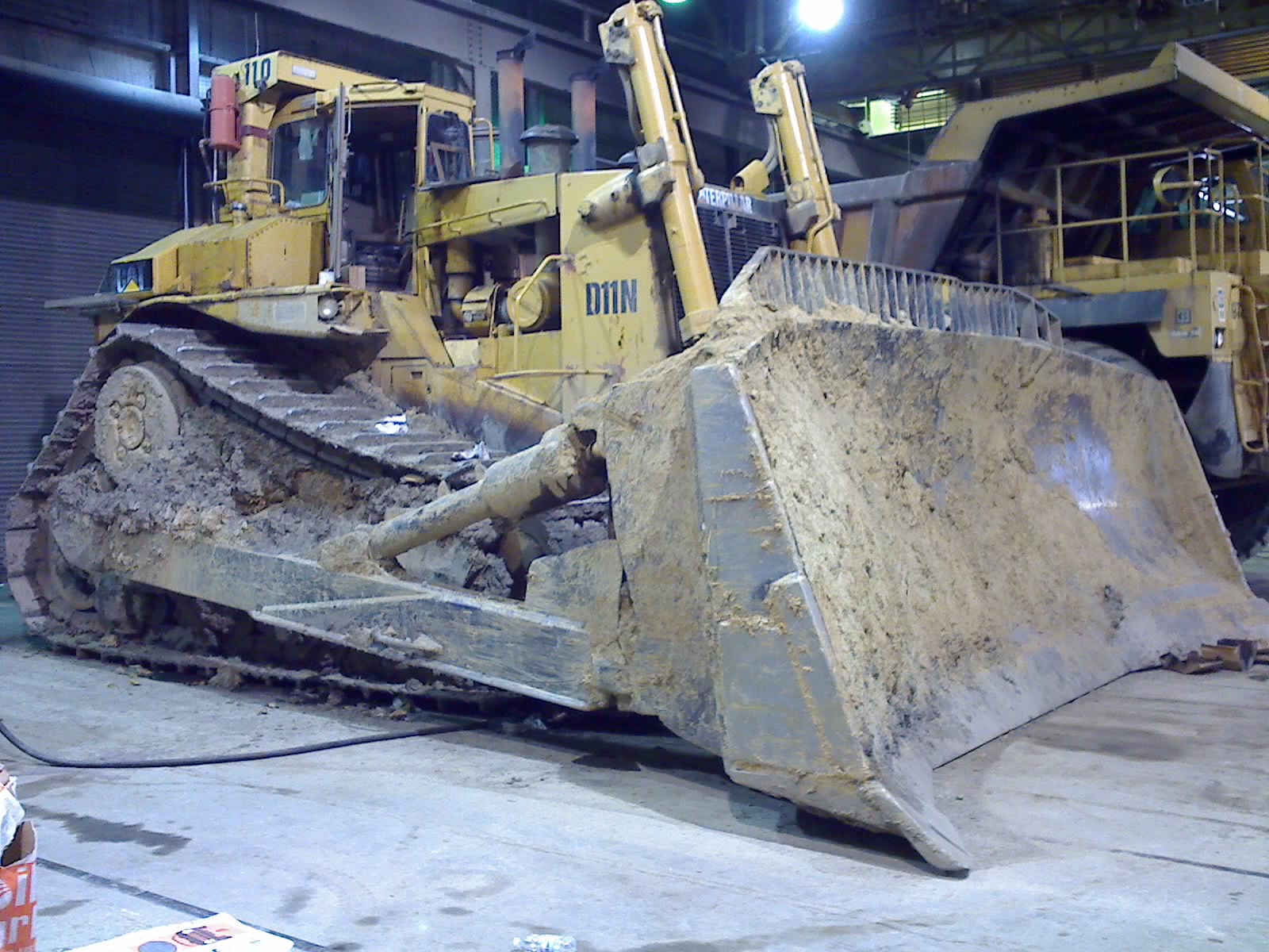

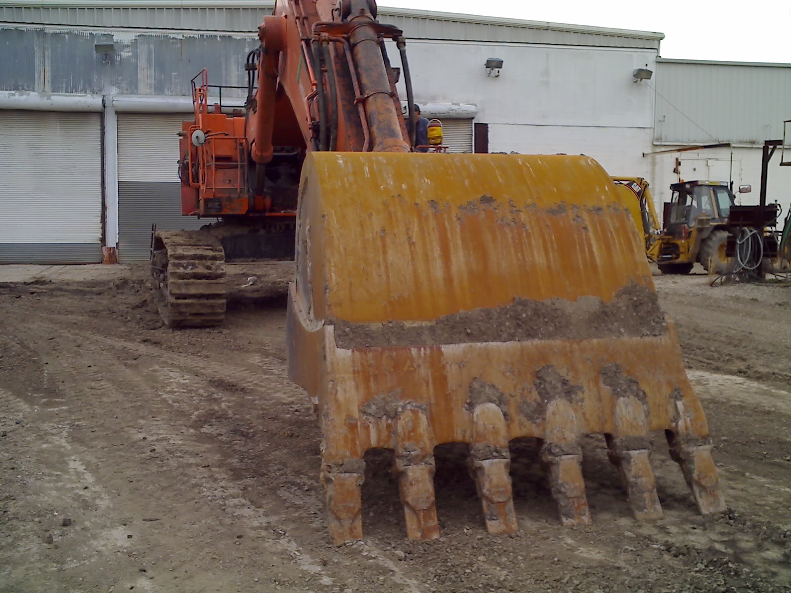

An ideal place for a reasonable sized pond (> acre) would be on heavy clay soil with a lot of run off and a reasonable water table. Once you're deeper than about 5', you spend about 10X the time getting in and out with your scoop. As I said, been there, done that. Your time frame is not linear. Even with a pump, pumping out ground water, you'd get stuck plenty of times with a 2wd tractor. Again, more time and trouble.
As I said, I have more things in life to do than spending years of what little time I have on this earth digging a hole that will be relatively small and shallow. Here is my idea of equipment needed to build a decent pond.
