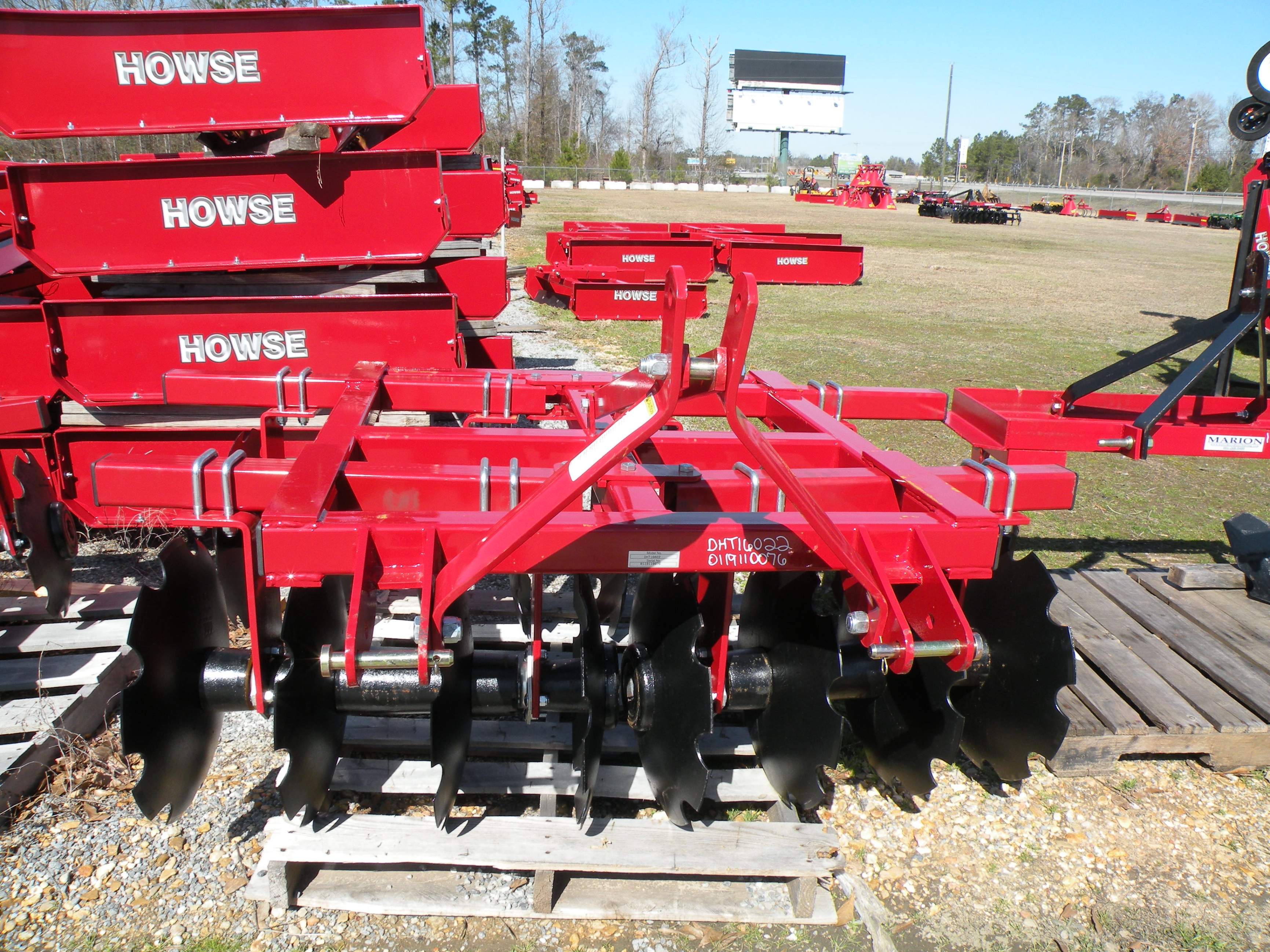

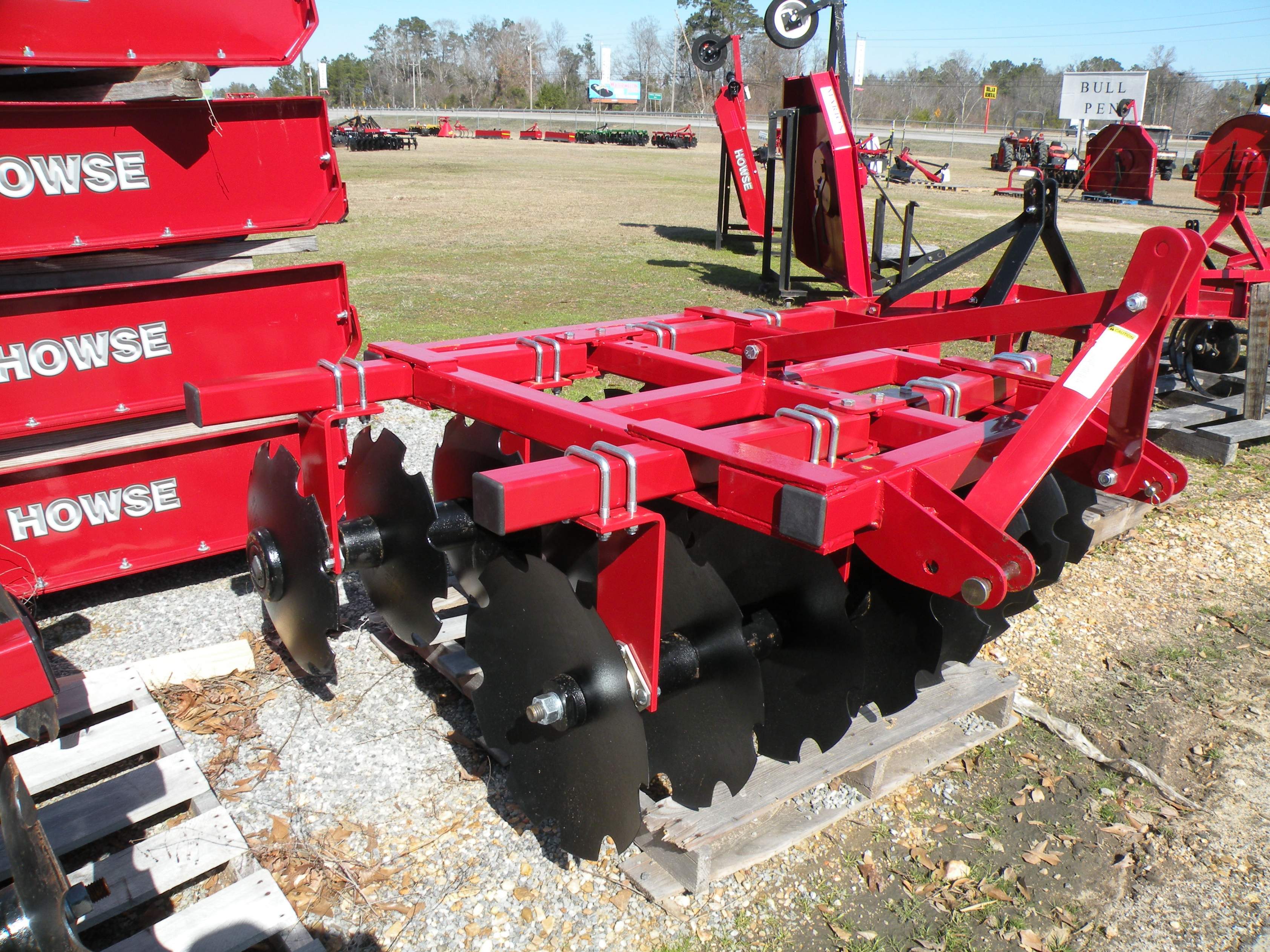

I have been looking at several different brands and am back to considering function versus cost. I am strongly leaning toward the heavy duty Howse 7.5' with 20-22" blades on 9" spacing. Axle size is 1 1/8" with ball bearings and weight is approximately 1100 lbs. This unit is about $1000 to $2000 less than many of the other brand units and is only giving up a couple hundred pounds in weight. Attached are a couple of pictures of the Howse unit and a couple of a "Marion" brand that the dealer has custom made out of state at an unknown to me shop. Could look at the 6.5' unit they have that is identical to above except has scrapers and is 1600 lbs(400 lbs more) for about $700 more. Having a hard time justifying the extra cost. Any opinions based on the pics?

To me, the Howse looks identical to the United and Frontier disks

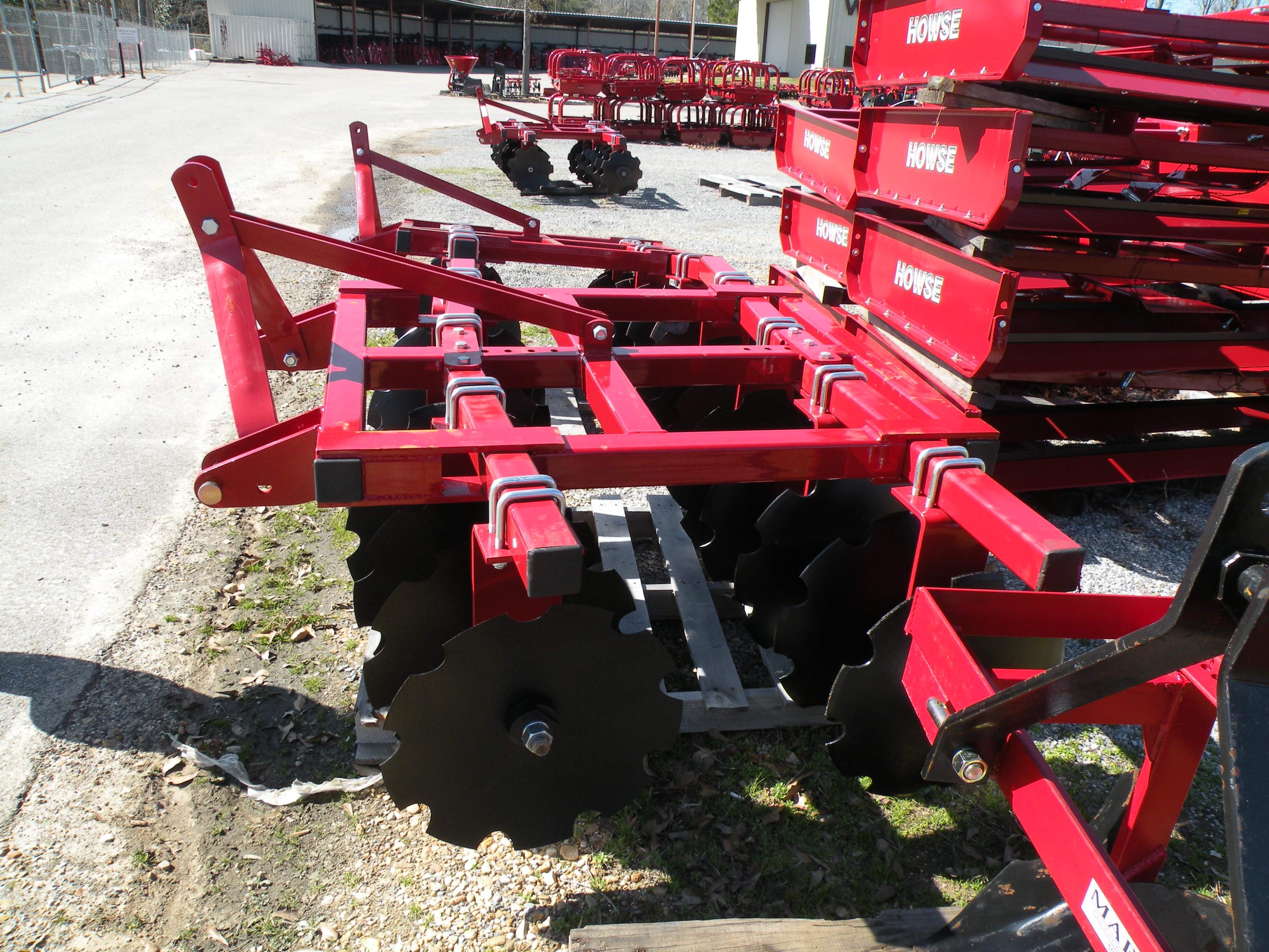

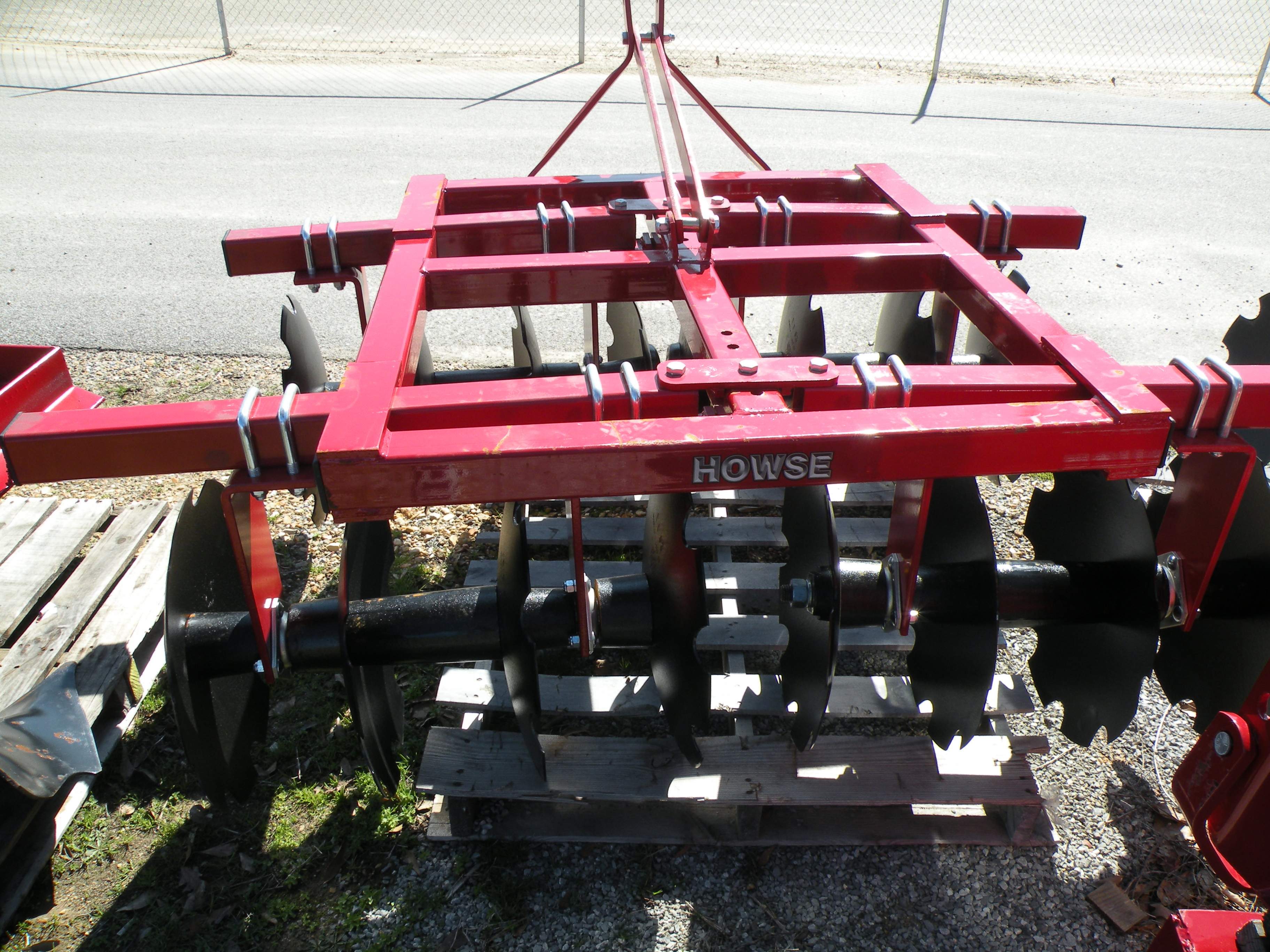

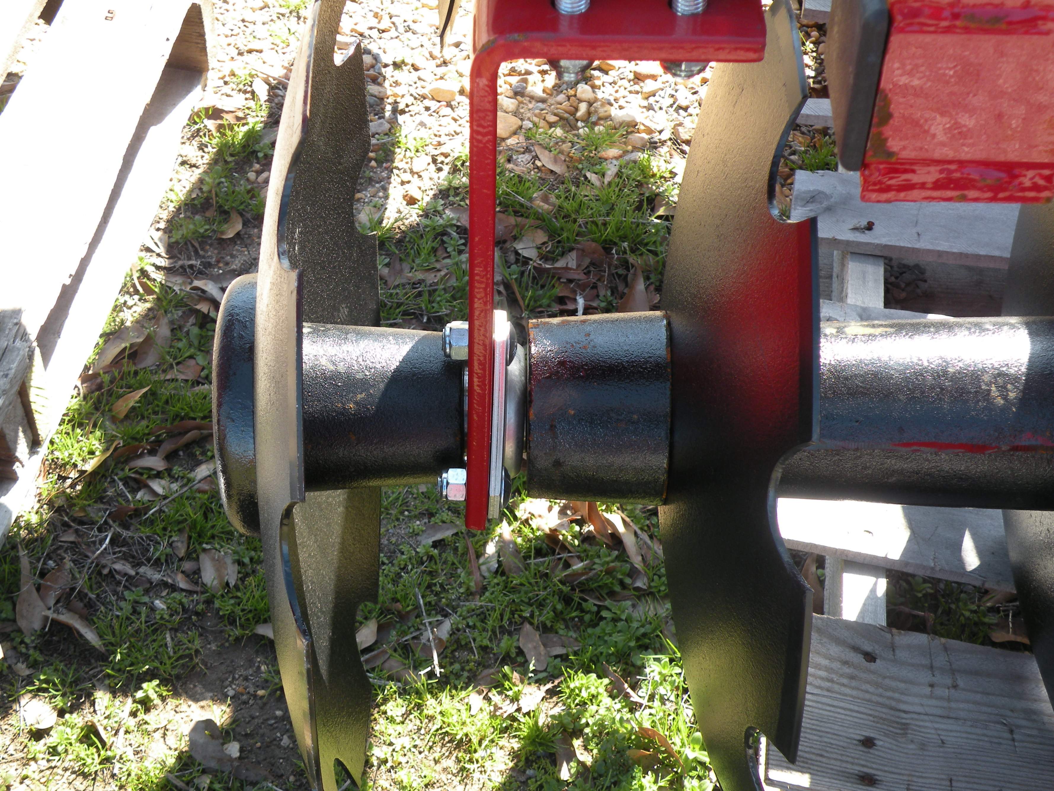

My thoughts exactly. I have looked them over pretty close and can't find a reason not to like the Howse...except for some are a little heavier and a lot more expensive. Here are a few more pictures I had.

Weight is your friend for this chore, get the heaviest one that you can afford.

deere5105, the 1 1/8" axles are fine for your use in my opinion. I'm thinking the 7.5' unit is going to be the one that works the best for you.

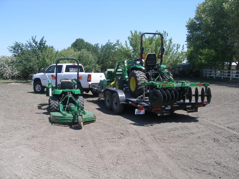

For Spring conditions a good rule of thumb is at least 45 pounds/blade. For dry hard soil the minimum is around 60 pounds/blade. Of course there are large ag. disks used for one pass primary tillage that are upwards of 200 pounds/blade, but thats a different story.
For hauling definitely go with a 3pt disk. The JD DH1396 will be the best match for you. They have 2 models: 7.5" spacing w/56 lbs per blade, and 9" spacing w/ 63 lbs per blade.
With that said, a 15 series drag disk will perform better with your tractor but make hauling a pain in the a**.
Here is a pic of the DH1280 on a Carson 20' 12K trailer.- not much room to spare!

Nice set up! I just purchased a 22' 12K trailer very similiar to yours. I purchased the stand up ramps on mine. The Howse disk I am looking at is 7.5' wide with 22" blades on 9" spacing with a blade weight of 55 lbs for $2200. The Frontier 1396 on 9" with 22" blades with a blade weight of 63 lbs is around $3800. Hard to justify the extra money for 8 lbs per blade. Build quality appears to be very comparable. Factory brochure even says it can come in JD green.
