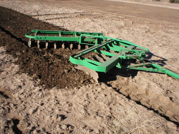

This is just my opinion, try to get as much weight as you can pull with the blades axle deep, maximum angle up the steepest hill that you are going to disk. What that is in your case, I have no idea. I know that I have an old(restored) John Deere-Kielfer 8' offset pull disk, weighs 2000+lbs. I pull it with a 75hp, 12,000lb tractor and there are times that it is all that the tractor will do to pull it. If you don't care about having to lift your disk, then get the 8 footer. To be honest with you, without knowing more about your conditions, I would probably get the 7.5' Howse unit . The price is right, you'll have 55lbs per blade, and it's wide enough that it won't take you forever to get an area disked up. I doubt that your tractor would pull the 8', 1850lb unit in the conditions that I described. That's 92.5lbs per blade plus all the drag, it would be a real load that's for sure.
I don't know how much disking that you have done, but it makes a HUGE difference on the moisture content of the earth and how often you disk the ground. Are you doing this to earn money, or what? If for money and you don't know what or when the schedule might be, then you might be better off with the 6.5' unit and the extra weight per blade. At 100lbs per blade, it should do some serious tilling.
Good luck, here's a pic of mine.

I doubt I could pull the unit you show in the pictures. I have calculated my tractor weight to be around 7600 lbs and is 64 HP at engine. Just in looking at the 8' 1850 lbs unit they have, it looks too big. My gut feeling is to decide between the 7.5' Howse at 1100 lbs or the 6.5' Marion at 1600 lbs. At this time, none of what I do is for pay. It is typically tilling previously tilled ground for food plots and garden spots. I would hate to spend money on something to only later find out that I have a hard time pulling it and can't get the full benefit of the weight. Was looking last night at the 6.5' BushHog box blade I currently have on the 3pt hitch. It covers the tires, but without much room to spare. As for going through tight spaces, the 6.5' would give less worry, but in the open spaces the extra foot would be helpful for covering ground and covering the seed after spreading. One thing the dealer mentioned was that he would prefer to see the heavier Marion unit with heavier axles than the 1 1/8" that are on it, which is also what is on the Howse.

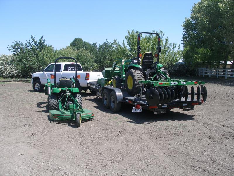

For Spring conditions a good rule of thumb is at least 45 pounds/blade. For dry hard soil the minimum is around 60 pounds/blade. Of course there are large ag. disks used for one pass primary tillage that are upwards of 200 pounds/blade, but thats a different story.
For hauling definitely go with a 3pt disk. The JD DH1396 will be the best match for you. They have 2 models: 7.5" spacing w/56 lbs per blade, and 9" spacing w/ 63 lbs per blade.
With that said, a 15 series drag disk will perform better with your tractor but make hauling a pain in the a**.
Here is a pic of the DH1280 on a Carson 20' 12K trailer.- not much room to spare!

Nice set up! I just purchased a 22' 12K trailer very similiar to yours. I purchased the stand up ramps on mine. The Howse disk I am looking at is 7.5' wide with 22" blades on 9" spacing with a blade weight of 55 lbs for $2200. The Frontier 1396 on 9" with 22" blades with a blade weight of 63 lbs is around $3800. Hard to justify the extra money for 8 lbs per blade. Build quality appears to be very comparable. Factory brochure even says it can come in JD green.
