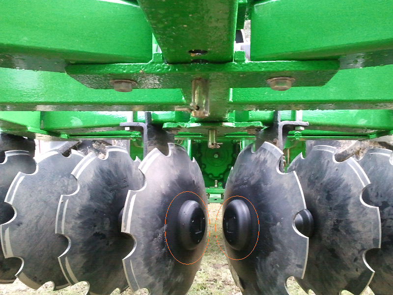

After considering different options, I decided to try to move the gangs closer together. I had to break it down, cut a metal plate down and reassemble. Attached are before and after pictures. In retrospect, I wish I would have removed another 1/2" or so but was concerned I would take away too much metal. Gave it a trial run and seems to do much better. Still able to see a few places where grass still sticking up. I am a little hesitant to put something like a rigid plow foot down over concern if it contacts an immovable object something has to give. This year I will be breaking up four or five new plots that I have never plowed before. Plan to use as is through the fall and reevaluate if further modifications are needed.

Yeah, I tried to move the gangs closer like you have done.
Notice how the "cup" of the disc blades will force the axles toward each other - more so in heavy soil. The arms that suspend the gangs from the frame are liable to flex under a heavy load.
Anyway, the two close gangs would come in contact and stop rotating. Doesn't seem like they would...but it does happen.
Plus, the contact or the side forces (or both) ended up destroying a bearing on one of the gangs that had to be replaced.
I don't believe they will touch the way they are now. On a PICO disc we have I have seen them get together and could see and hear them rubbing, but there didn't seem to be any issues.
Out of curiosity, have you ever contacted an immovable object with the plow point you installed and if so what was the result?

After thinking on it further, wouldn't it stand to reason that if I mounted one behind the front gangs and set it to the same depth as the gangs, that if I encountered a root or stump it would roll over it like the disc blade? If out front it might strike a hidden/unseen object first, but between the gangs should give warning or lift the disc harrow. May just give it an extensive trial run as is to see if it is a legitimate problem.
/ Disc Harrow Adjustment #32
If you can fit one there then that makes perfect sense. Good luck...those undisced grass lines up the middle will be a thing of the past.
