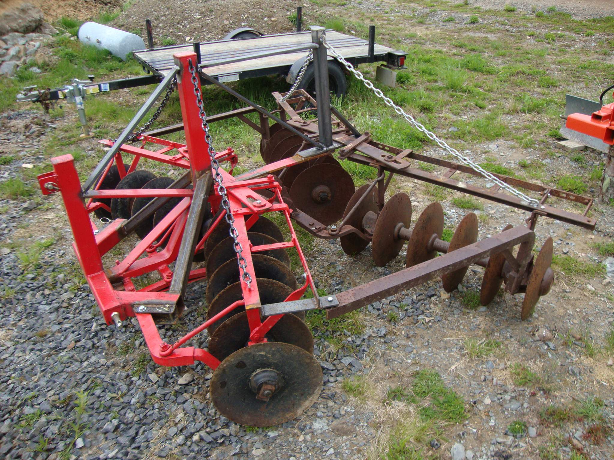

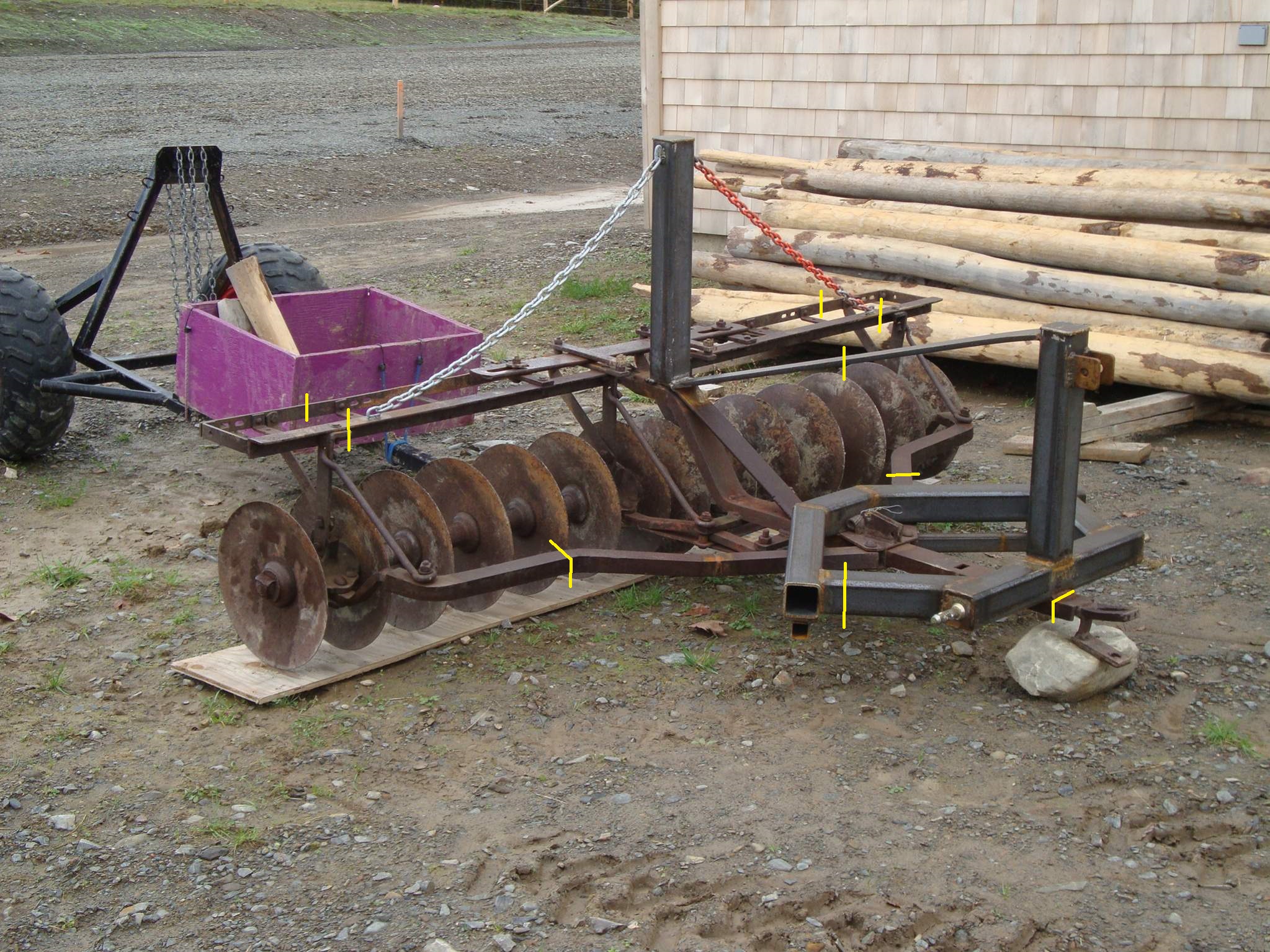

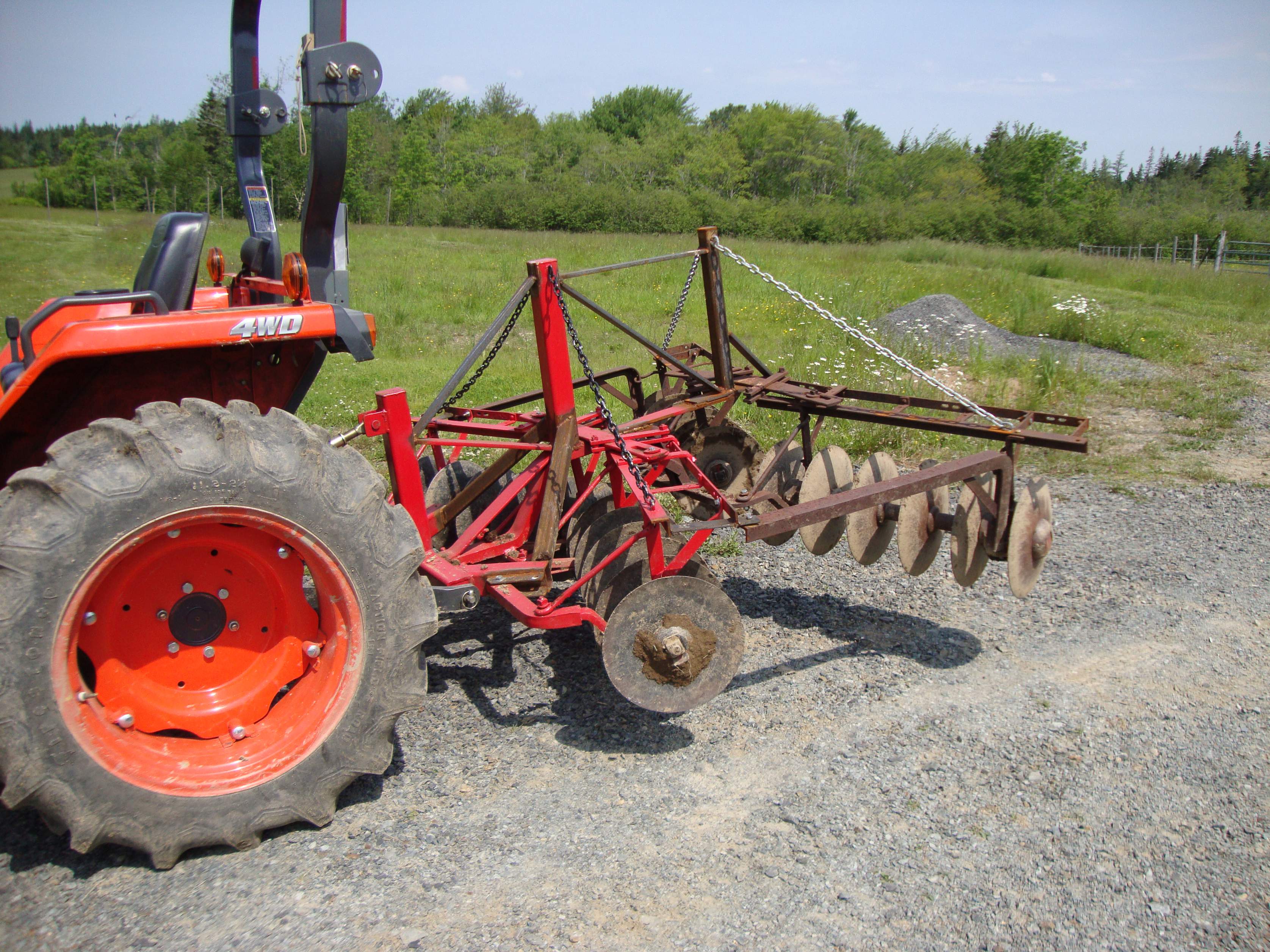

Back in the summer I came by this set of disc harrows. They were originally designed for pull-behind use, which was fine by me except that there was no easy way to transport them.
They're about 8 feet wide, the front set is designed to push the soil out, and the rear pulls it back in. The L3400 doesn't have the power to pull both sets, let alone lift them, so I decided to convert the front set to a 3 point lift style and keep the rear set for spare parts. They were built by Massey Harris from what I can see, I would imagine spare parts are right up there with hen's teeth.
The angle adjusts by moving the side rails fore and aft, the collar that slides on the center rail has slots and a locking pin.
The front frame is designed to give support to the side rails and stiffen everything up.
I decided to shorten the whole thing by about 15 inches, the Kubota wasn't happy about lifting it with all the weight so far back behind the 3 point hitch. It has no problem handling it now.
The rear post and chain stays are designed to take any serious bounce loading while it's being transported. I don't foresee any long trips at high speeds, but even a small bump puts a lot of strain on the center section.
The job was delayed a couple of times, testing it will have to wait until next spring when the ground dries a bit.

It actually works pretty well, although it's hard to get enough weight on it to dig properly. I plan to remove a disc or two on each side to get more pressure on each disc. If I can shorten it a bit more while I'm at it I may try to add the second gang too.

Yep, lots of room for weight, my trouble is lifting it with the L3400. If I can shorten the distance between the discs and the hitch I can easily add more weight.

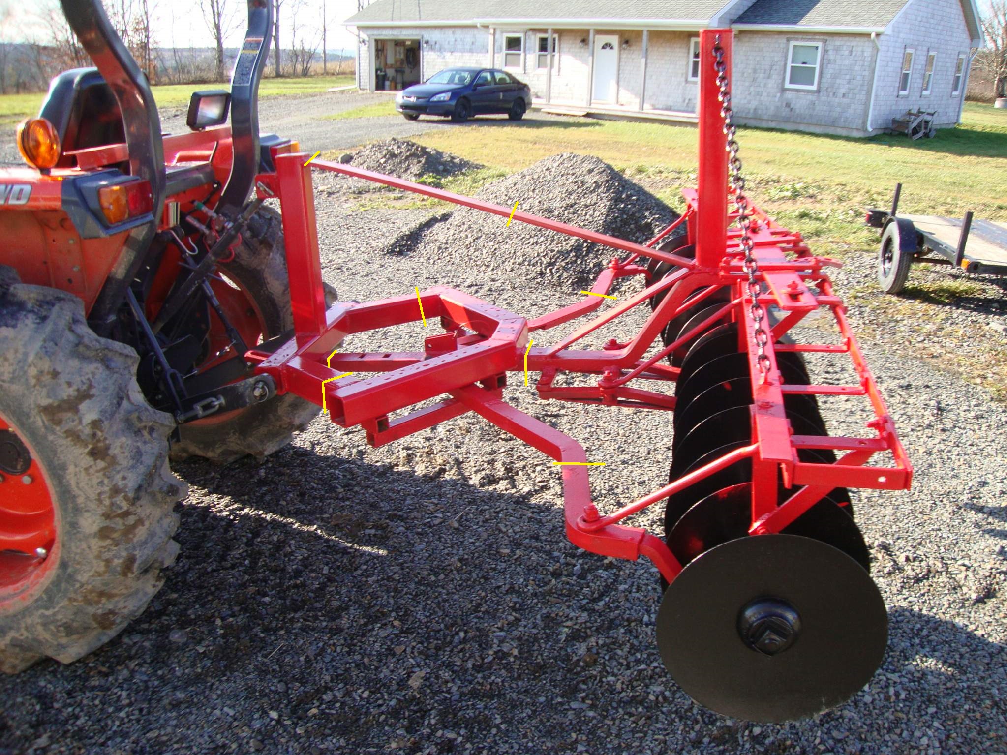

I started what I hope is the final set of modifications to the harrow. The axle nuts came off a lot easier than I was expecting, I got the axles shortened and re-assembled (at least the front set). I removed one disc per gang, and one spool spacer, which narrowed it by about 18 inches.
I cut about 2+ feet out of the tongue, I can't make it any shorter-coupled or the discs would hit the rear wheels.
The frame is re-welded to the T-frame for the 3-point. All I have left to do is replace the angle adjusters and add some stiffening frames. Then I'll look at ways to attach the second gang.
Pouring rain here today, I should be able to get some pictures posted tomorrow if the weather cooperates.
I hope that it'll do a better job in fewer passes than before, with any luck I'll be able to add some weight and still have the tractor able to pick it up. The alternative is buying a new set of harrows, which a little bit rich for my blood. At that cost I'd be looking for a used tiller instead to do our garden plots. There don't seem to be many small used harrows available here, my dealer can't remember the last time he sold a set.

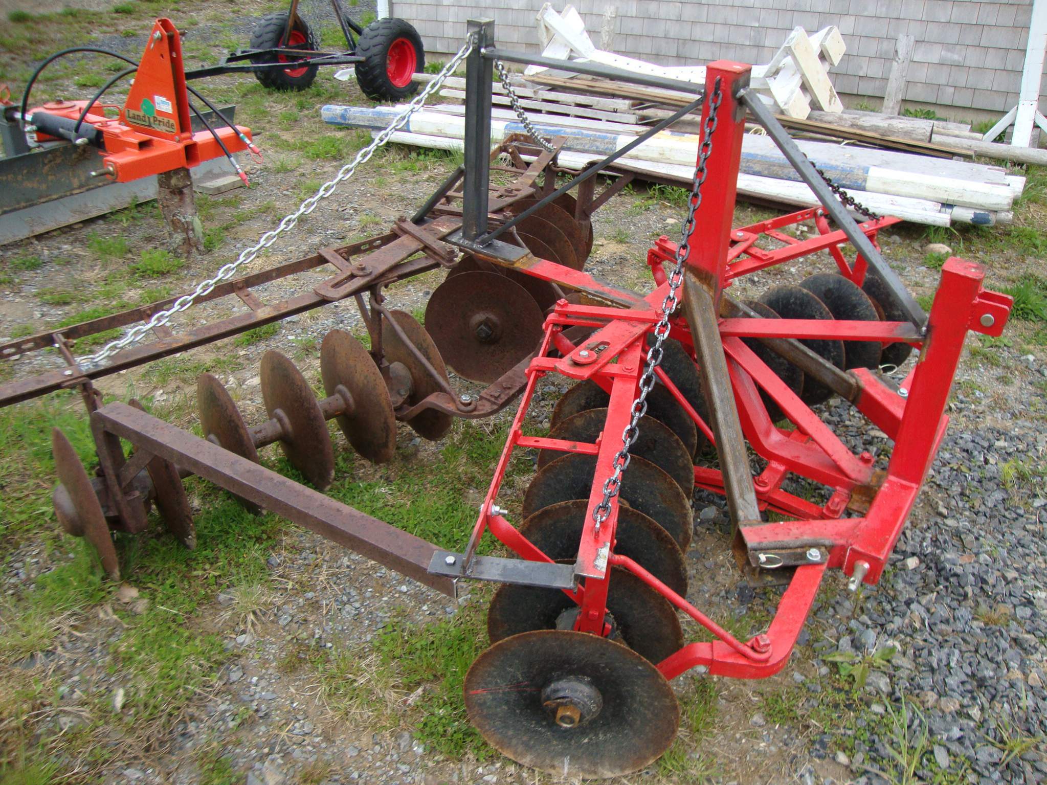

Okay, after a month of re-design, cutting, and welding including a two-week diversion which I'll explain later, the harrows are finished.. again! The pics with yellow lines show where I cut the frames, axles and other parts (including myself!), the ones with green arrows show which parts were added.

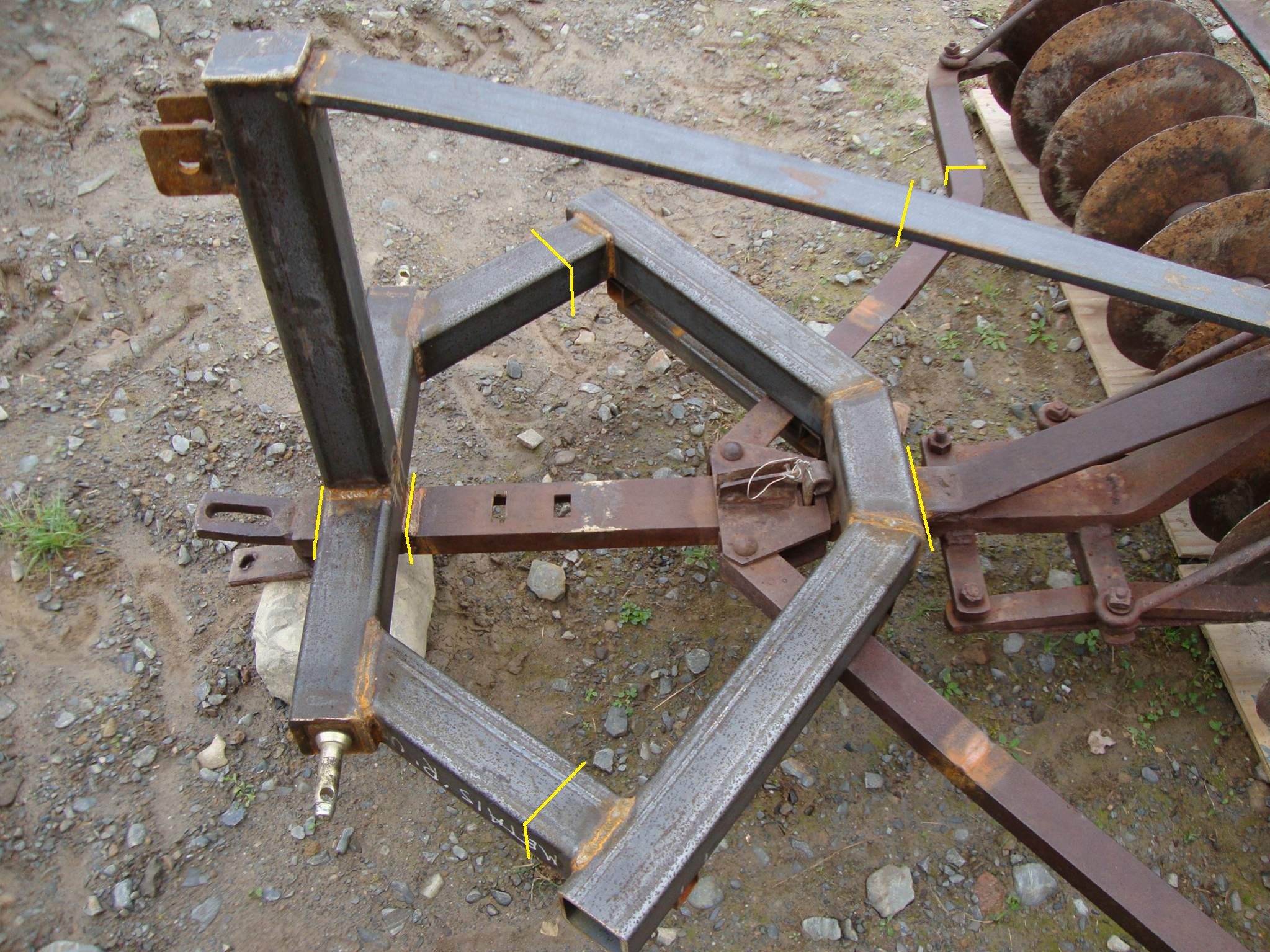

I shortened the tongue again by about 18-20 inches, cut 7 inches off both axles, and narrowed the frame that hangs the bearing housings in the initial phase of the project. That also required cutting and redesigning the angle adjusters for the front gangs.
It just about choked me to cut that 3 inch square tube, after all the time I spent getting the angles just right a year and a half ago.
The frames that sandwiched the angle adjusters were lost as part of the process, which gave me some concerns about the stiffness of the whole thing. All that would have held it from twisting were the welds holding the tongue to the 3-point frame. I don't do too bad a job at welding by amateur standards, but everything has it's limits. More on that in the next post.
The bearing assemblies are pretty simple, just a piece of hex stock with an inner rotating sleeve that gets grease from the back. The hex stock is held in place by a semi-hexagonal shape in the bearing holder halves which are then bolted together. The only grease seals are short lengths of rope held by grooves in the bearing holders. I doubt they're very effective at keeping grease in, but that was the fashion when these were built.
Sean

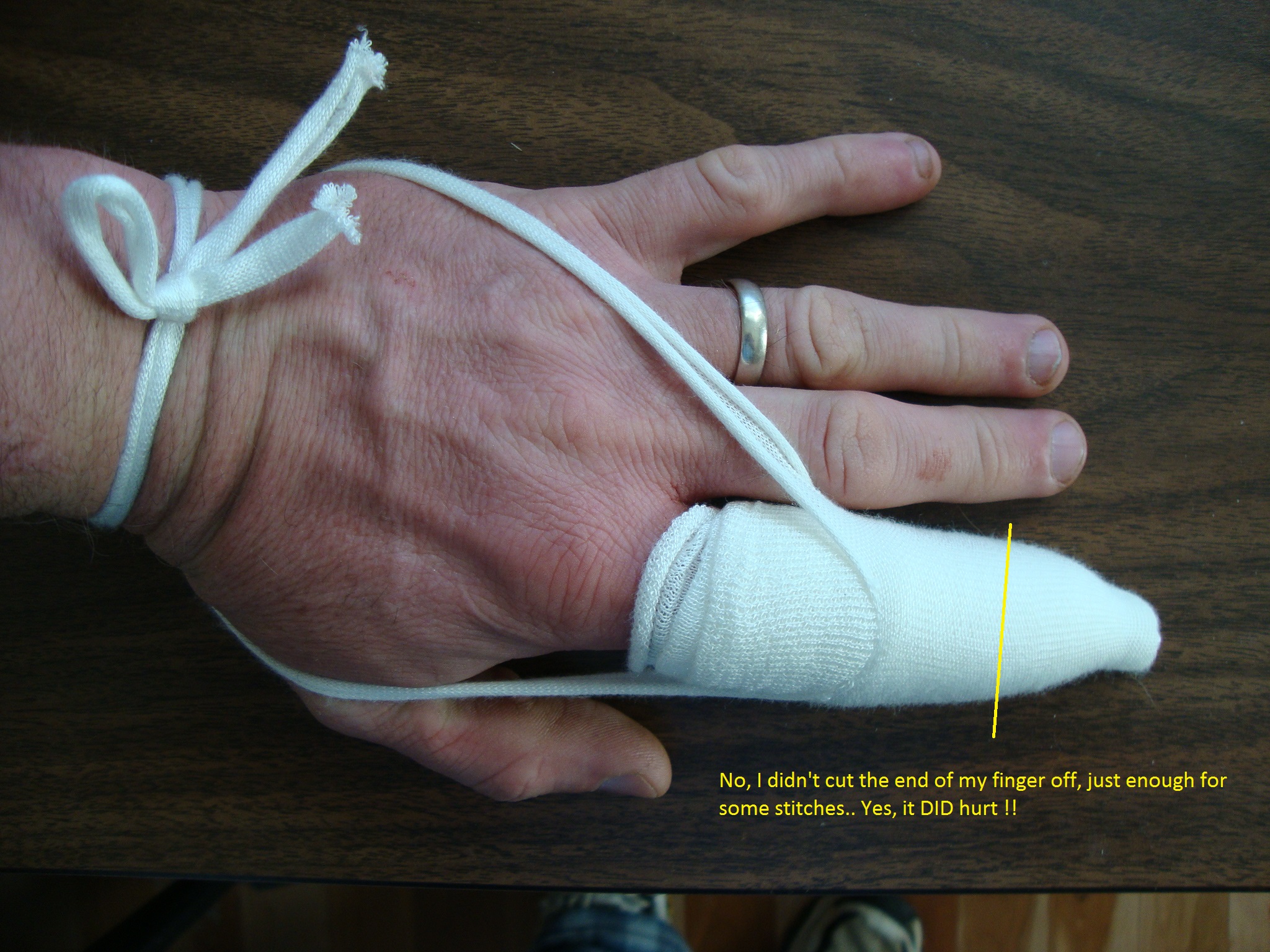

An afternoon event, one that pretty much ended the day's activities other than sitting in the emergency waiting room at the local hospital. A few stitches later and a week for things to heal up enough to get back to work.. let's just say zip-cut wheels on an angle grinder don't differentiate between a piece of flat bar and a finger.

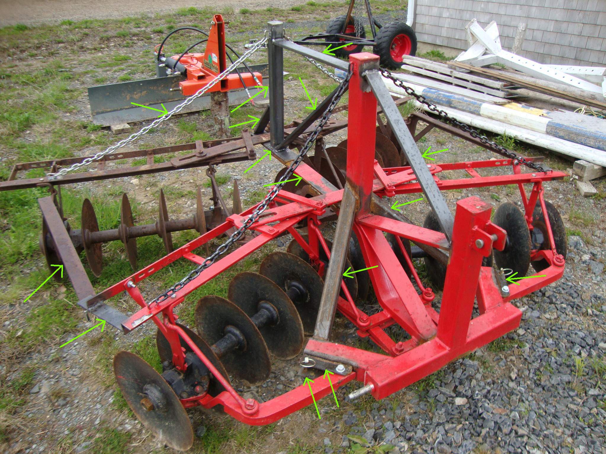

Green arrows are new additions in this picture. I added the angled braces from the old frame up to the first upright post to reduce any twisting motion where the tongue attaches to the 3-point frame, one of the more complicated compound angles I've ever cut. I used a piece of 2x2 wood and a compound miter saw to get a dummy piece to fit, then copied it in steel tube with the cutting wheel on a grinder. If it doesn't fit perfectly, a welder really IS your friend!
Now I need some warm dry weather to get the whole thing painted again, and by that time we'll be ready to give it a try before we plant our vegetable garden. The rake angle on the gangs is roughly 20 degrees fore and aft of 90, I doubt I'll have much use for it in a 90 degree configuration. If I do I'll need to devise a way to adjust the rear gangs. The front ones are adjustable by moving the ends of the adjuster arms to a different set of holes.

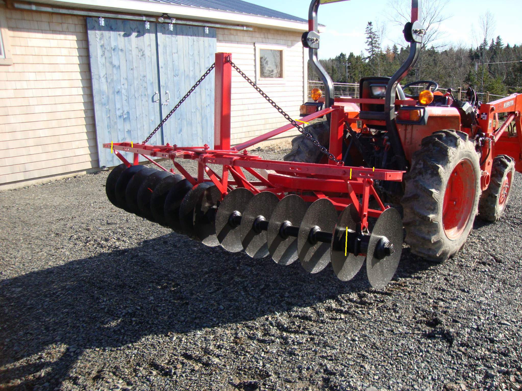

I got the weight just about right.. the Kubota will pick it up, it acts about the same as it does picking up my rotary cutter, which weighs about 650 pounds. They're both about the same length, which tells me the disc is between 600 and 700 pounds, give or take.
The front set of discs is about a foot behind the rear wheels of the tractor with them raked fully ahead, so I can't get much closer than that.

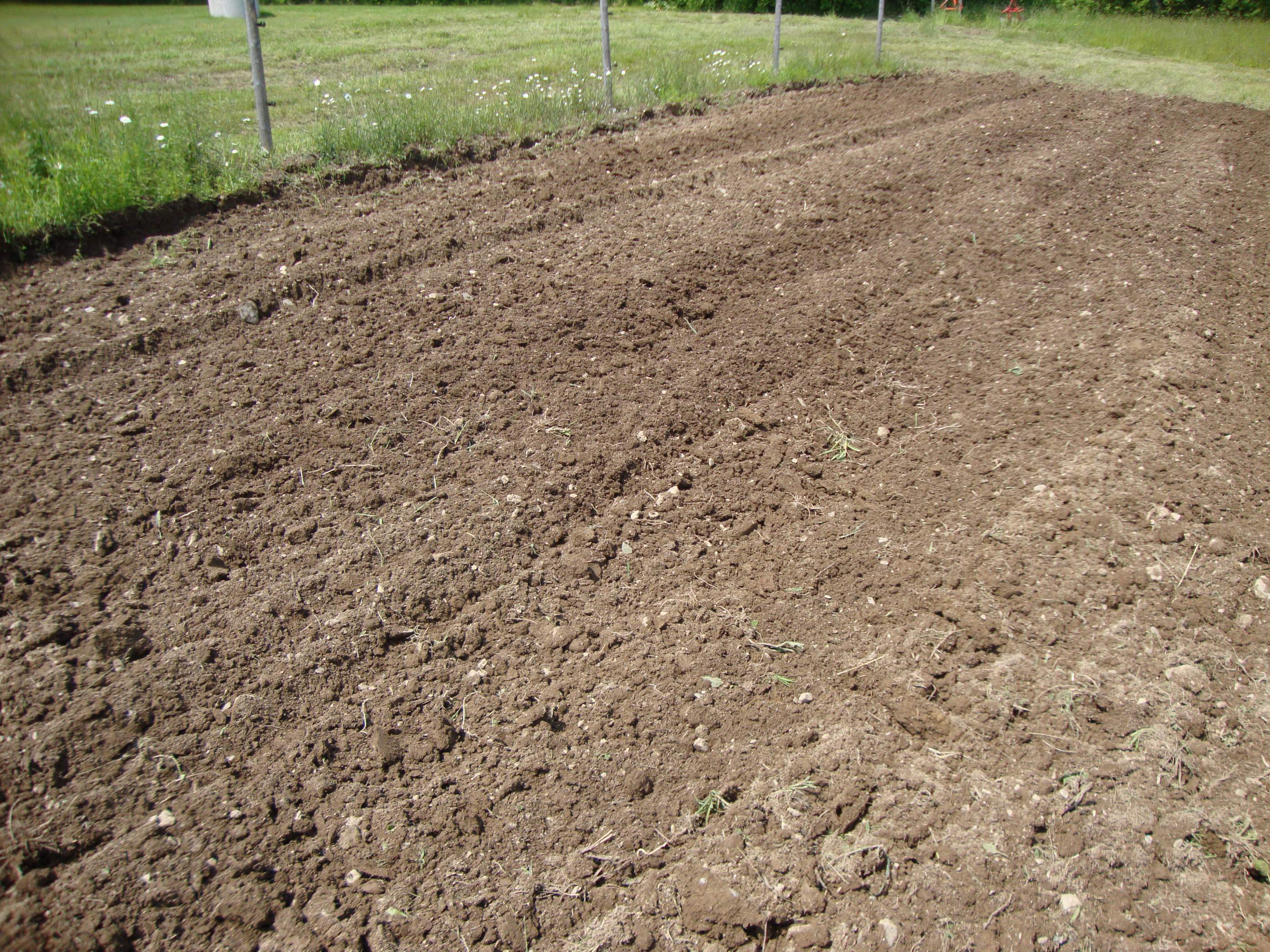

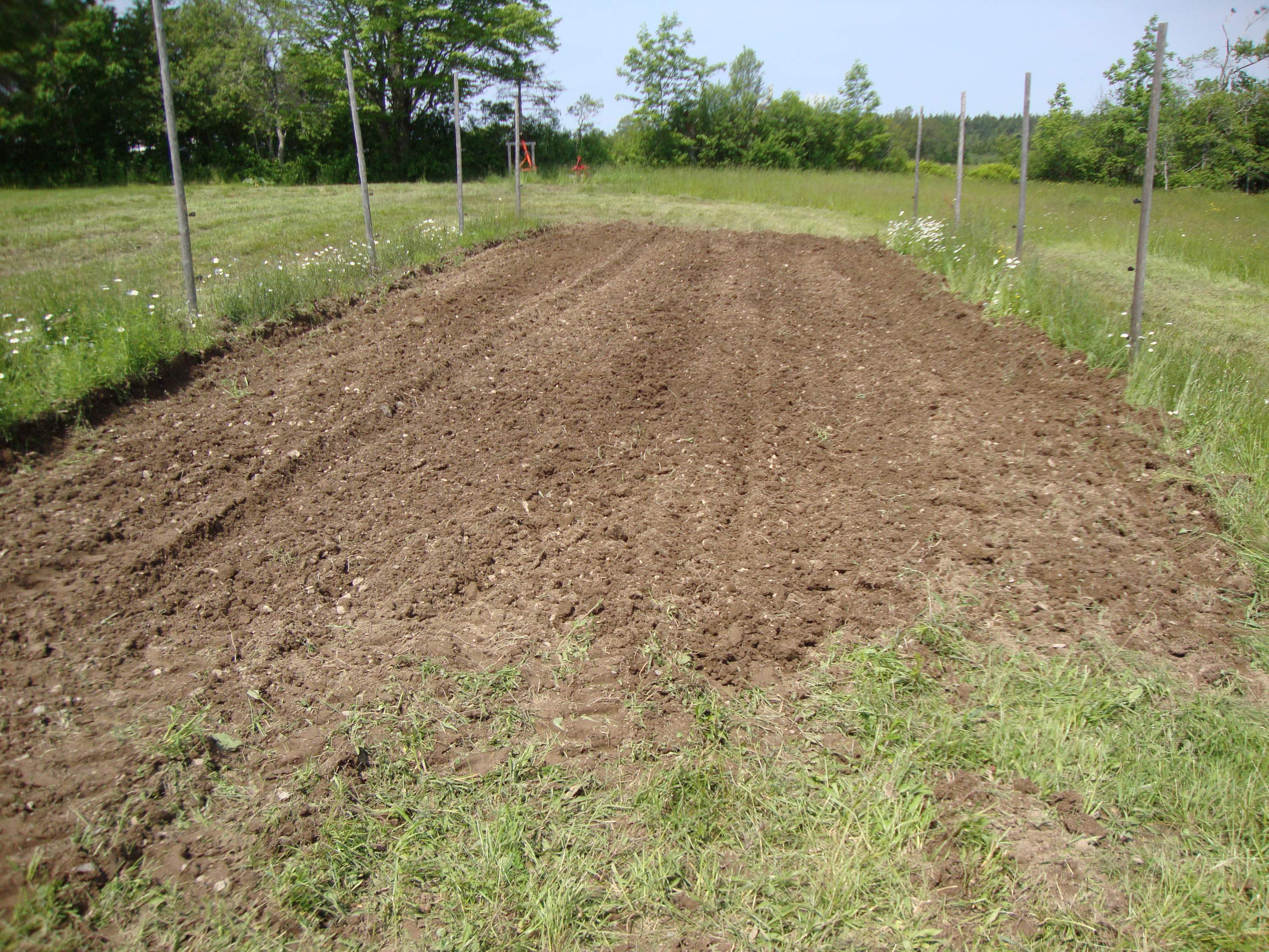

Today was harrow-the-garden day! It's been so wet that it was my first chance to get in the garden and do some final prep for planting. It's a late start, but there's no help for it.
First impressions are really good, much better results than last year with a single row of discs. The added weight of the second row holds the first set in the ground much deeper than before, and they break up the soil better too. I'd say I'm getting 100% depth (to the axle) on the first row, and maybe 75% on the second as well. The soil is still predominantly clay, although we're adding composted manure and peat moss every year to improve it.
I adjusted the top link to allow the front set to touch slightly before the rear to help it dig better, and it works.
Now it's time for paint and some final finish welds and trimming and we're done.. incidentally, the 8 bearing housings took almost 2 full tubes of grease before it started squeezing out!
As luck would have it, it rained this afternoon, so planting will have to wait for another day.
