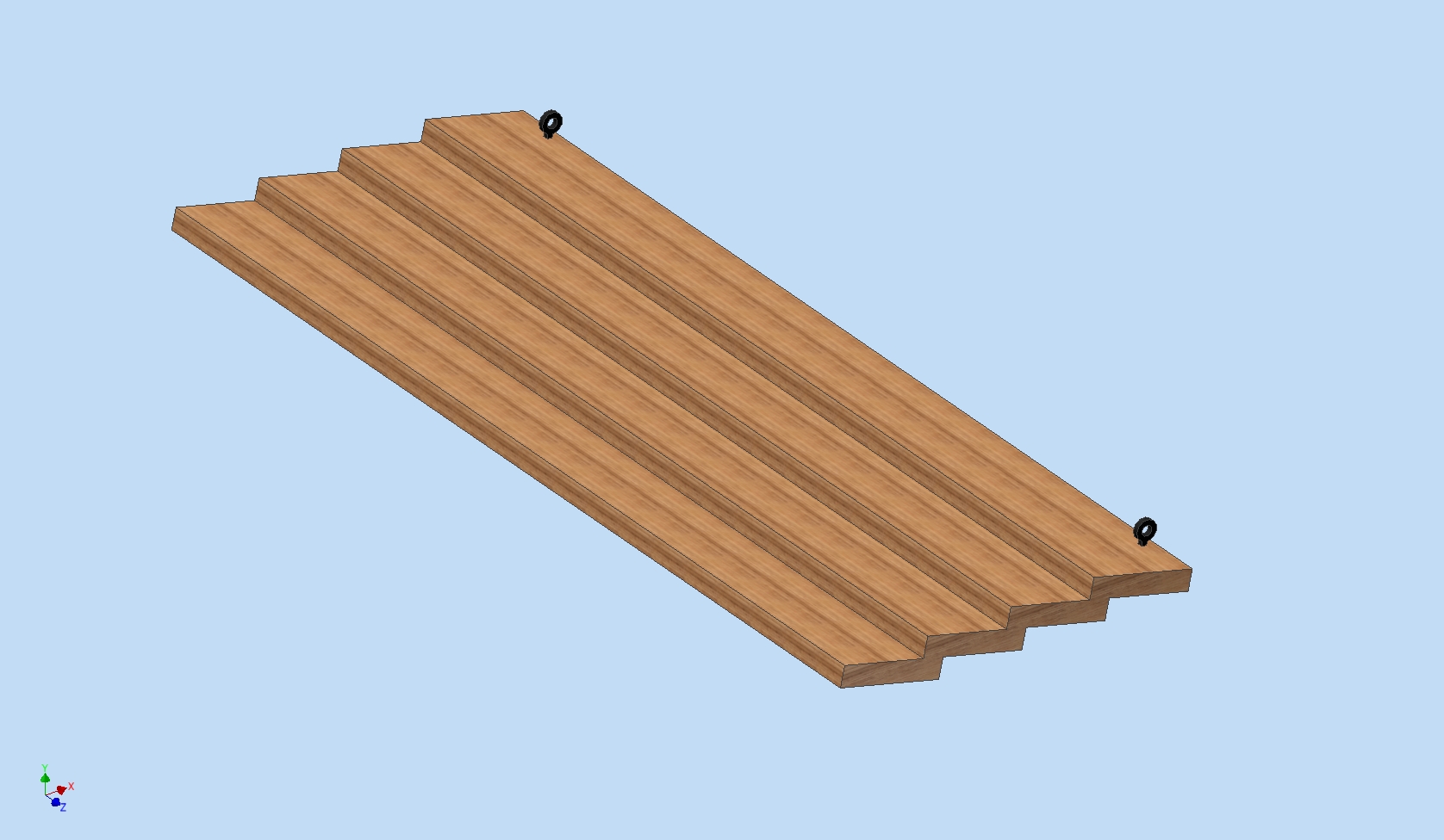

I use what my grandfather used to call a "float". It's just 4 or 5 2x8s nailed together like an old wash board. It's cheap and works great. I just hook it up with chains behind my disk. Heres a sketch of it.
