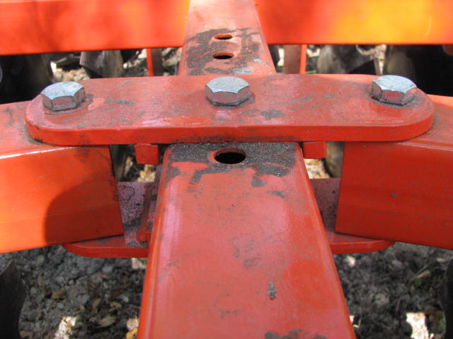

When you have time for more photos how about describing the gang angle adjustment process on your disc? Photos may do it.
I use wax lube or Fluid Film on the box frame to make changing gang angles on my 587 pound Howse disc easier.
Photo #2 shows smooth result; no troughs. Good adjustment.

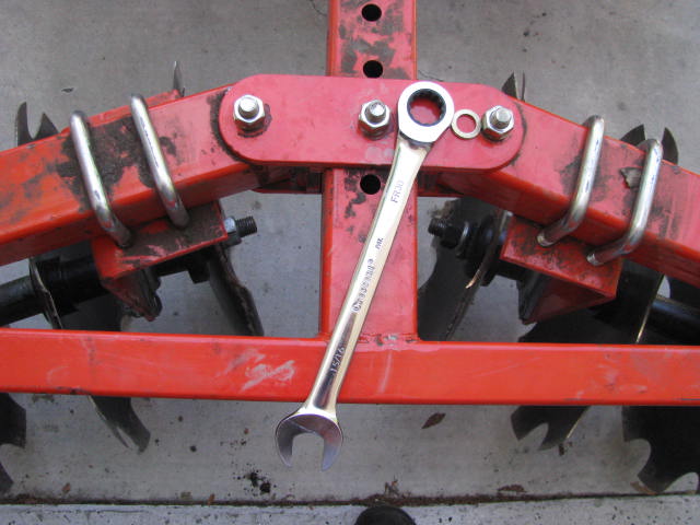

How about an update on how the Land Pride DH2572 is working out for you?
I can see in your picture you have 20 notched discs. Did you buy DH2572 with 20" or 22" discs?
Is the gang angle adjustment essentially the same friction/clamp plate method as on my lighter Howse, but with the addition of a grab handle? Or does the DH2572 have a more convenient/faster way to adjust the gang angles?
