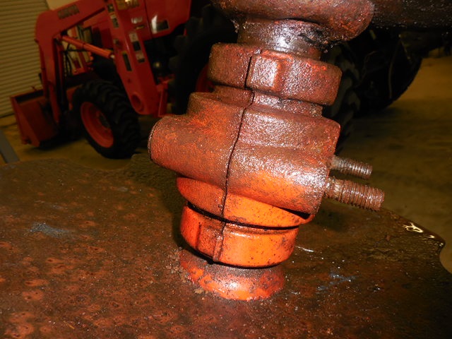

TX Jim, Here are the Pix's of the other end plate and the housing.
   / Disc Harrow Repair #13
Remove the 2 bolts in brg halves then seperate halves & clean rest/dirt. Lubricate parts & ressemble disk.
If you still desire to disassemble disk shaft which I'll advise against doing then follow these instructions. My eyesight isn't great but I think I see a thin piece of metal bent over square nut to lock nut in place. If I'm correct with aid of a cold chisel bend tab away from nut then loosen nut

Yes, that's a 'lock plate' as such. No problem with heating that and flipping it out straight.
I am inclined to take your advice and simply grease, tighten up adjustment and re-install it. I'm afraid that if I actually do the job right, i.e. disassemble it, clean it, and re-assemble it I'll have a handful of ball bearings fall out. I really just wanted to clean it up, but ran into this dry gang problem. Couldn't resist trying to fix it, but I wasn't prepared to spend a pile of money on it.

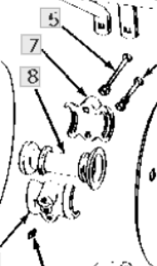

The disk shaft brgs have no ball brgs to fall out. No need to heat locking tab to straighten. I've straightened/locked several locking plate when they were as cold as my ex-wife's heart!! :laughing: If you free up brg halves to spool you will have no need to disassemble disk gangs.
Shown below is a photo of a similar JD disk with very similar white iron brg housing halves. These type brgs will last a very long time if greased on a regular schedule!! I drove a tractor in my youth pulling a plow with similar brg halves plowing many acres!!
Dang Texas Jim! Wish you'd have told me that 2 days ago :) I found that out yesterday when I decided that there was no way I would stick it back to together not fixed. Mine turned out to be made exactly as you described above.
I split the two halves, cleaned it up, drilled out and taped the two broken off zerk fittings. Put in new zerks, coated it down with molybdenum, packed it down with axle grease and buttoned it back up.
The original problem was obvious when I discovered that someone in the distant past had broken off both zerk fittings and just left it like that. It hadn't had grease added for a millenium it seems. Bone dry and no sign of grease at all, but fortunately it wasn't damaged.
