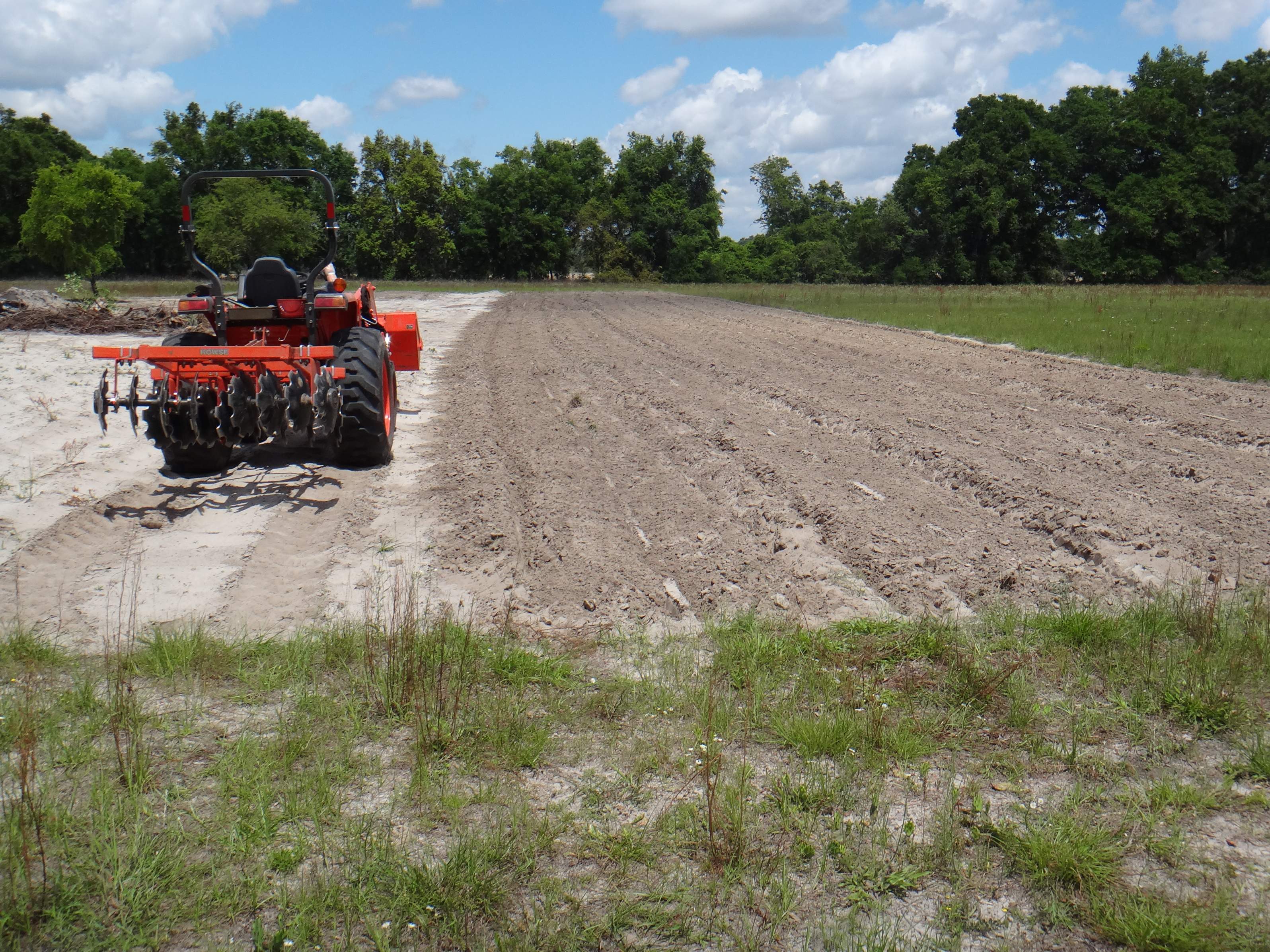

The disc won't do it's job below a certain speed. Discs and plows require a specific rate of travel, so even if I could pull a five bottom plow with my 8n in low gear and low range (Sherman transmission) it wouldn't do the job because the soil wouldn't turn over all the way. I'm not disputing how HP works, plenty of threads for that already, just talking about how the disc works.
Here is a picture showing ground tilled by my 16/18" Howse Disc Harrow pulled at a brisk pace.
The soil thrown out by the front gangs is clearly visible, as a lapping wave nearest the tractor. The little furrows are where the ouside pans of the rear gang picked up soil to throw inward. Combined…..good mixing.
Location is a firebreak surrounding a community burn pile which I maintain vegetation free.
