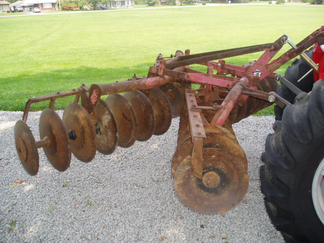

Are you wanting a cheap no-name 3ph disc to use as a secondary tool behind a plow? OR are you wanting something HEAVY with BIG pans and do it in one pass.
I can pull a 12' transport disc, with 32 pans 18" diameter 9" spacing with a MX5100. Which is 51hp, 3800# bare tractor. (I do have 700# fluid and 600# wheel weights too).
One of the old 7' MF tube frame discs with 16" pans on 7" spacing like this
