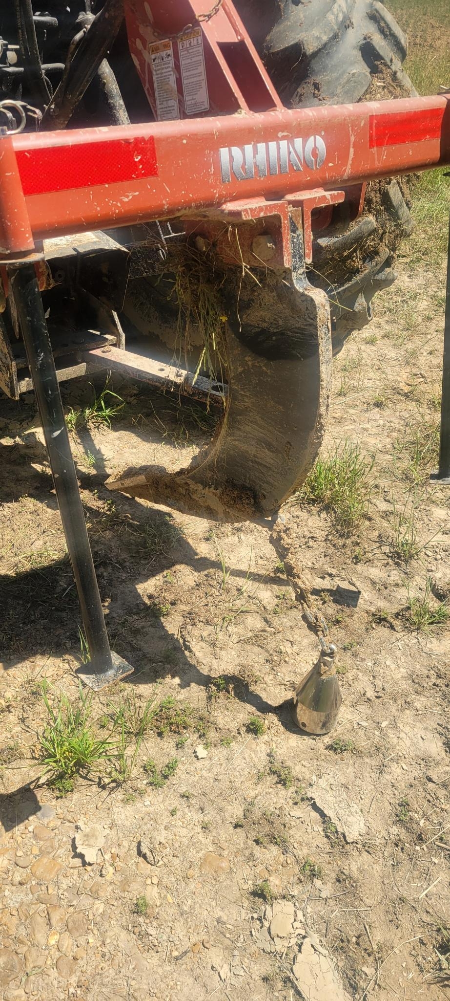

Mind did that after I tried pulling an immovable boulder of unknown size out of the ground. My fault lol, I yanked quite a few smaller boulders before it started to bend and I probably got too cocky with it.
This one ^ looks like a trailer mover with a middle buster:
You definitely get what you pay for with tractor implements... that ^ is like just over $100 total.

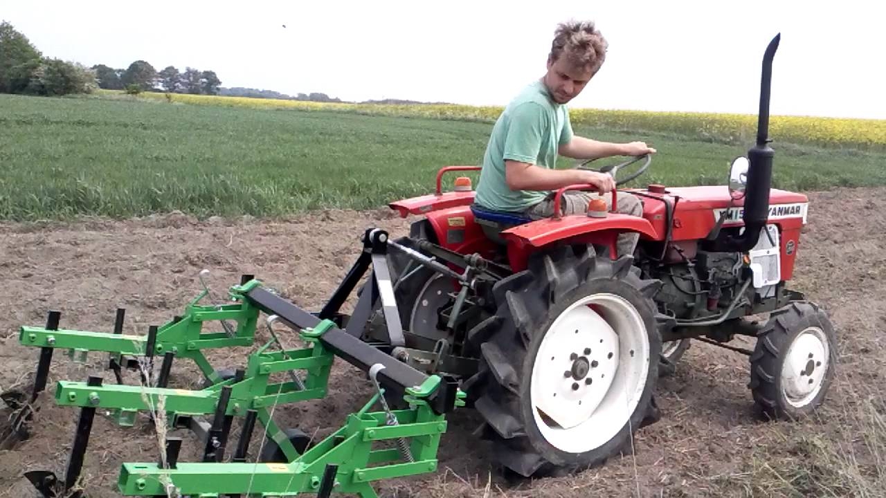

An SCUT 15Hp diesel, Yanmar YM1500.
YM1500 with bottom plow
SCUT Deere with Yanmar 14Hp diesel engine.

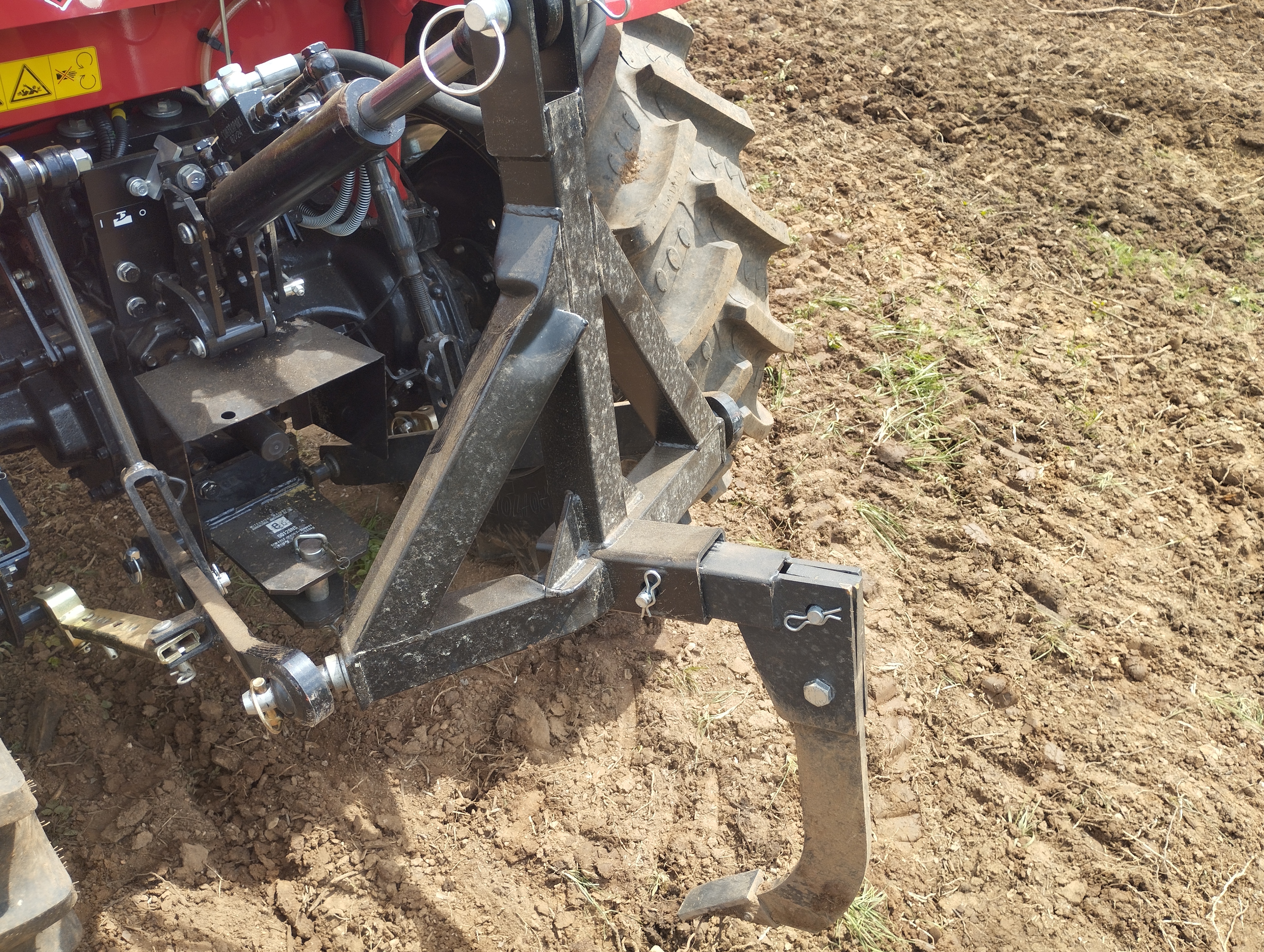

I pull my homemade 2 shank ripper the full 16" deep in hard clay with my 35hp tractor, but with R1 tires.
How deep do you think you were going in that video? Any closeup pics of your ripper?

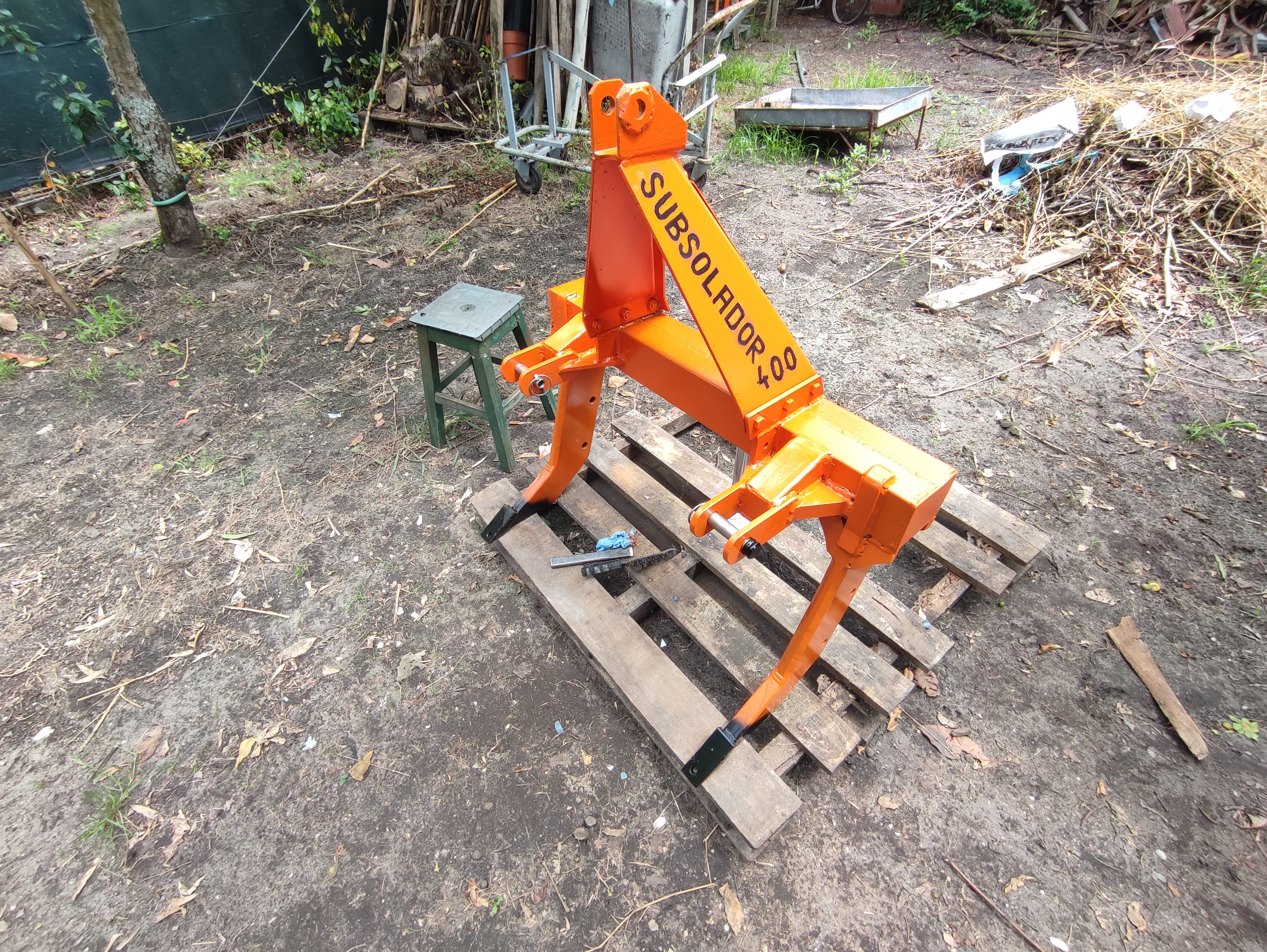

Where did you bought that subsoiler, if you don't mind me asking. Haven't seen that style for sale over here.
Chinazon Spain, junk! Heavy Hitch has some nice stuff there but they do not ship internationally.
   / Minimum HP Requirement for Subsoiler #28
After ning posted those links, I figured it was something like that.
I'm pretty sure that not even the worst dealer here would want to deal with any of that. Probably meant for those small garden tractors or something and we don't really do any of that here.
Right to the frame of the subsoiler, it's about 450 mm or close to 18". I can pull it all the way to the frame. That video was the first test of it.
I have a built thread here: Homemade 2 shank subsoiler

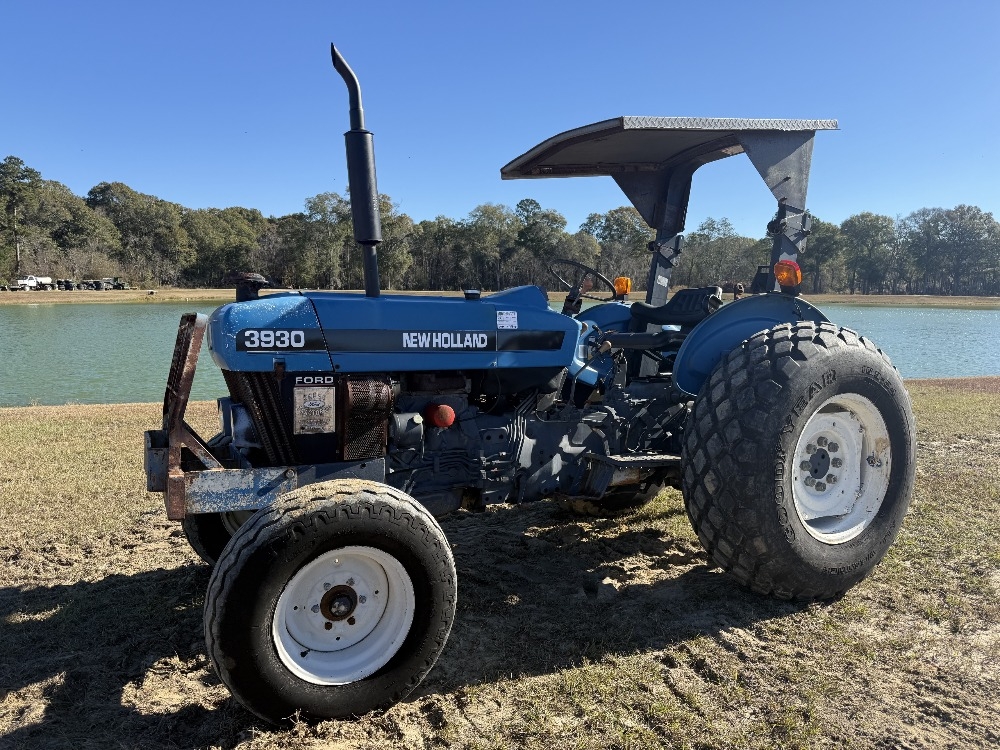

85 HP pulls it deep as arms will allow.
The pig is to leave a tube in the ground to drain wet spots.
