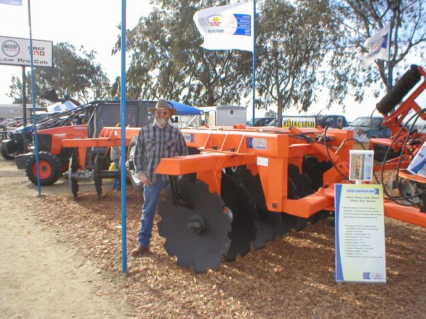

This is what we pull with our Sears SS12. :rolleyes: At 992lbs per blade, it can be a bit much when it gets down to the hubs though. :sarcastic: ;)

I'll bet penetration isn't a problem with that one!
