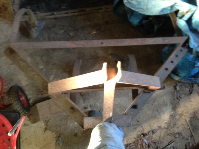

Attached is a picture of my old cultivator. I bought two blanton style discs and shanks from ASC. I plan to bolt a 2x2 bar onto the cultivator and then attach the discs to the bar. Thanks again for all the great advice.

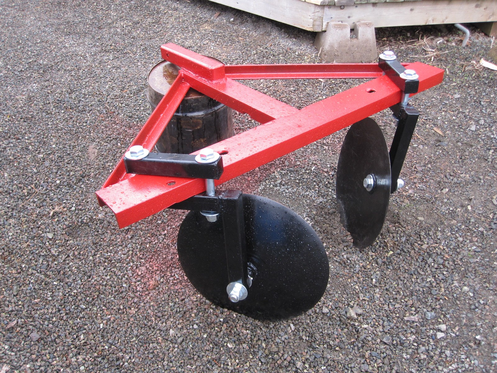

Here is my home made version...... So far..... I can set it up to hill center, left, right...... Or double row with one pass......
Going to look into using as kind of a one way plow eventually. I have 4 shanks to work with.
Good luck

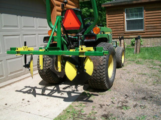

Posted a while ago while my hiller was under construction. Finished it & used it last year, worked great.001 (4)a.JPG032.jpg034.JPG
   / Disc Hiller/Cultivator Combo #20
Ken, I like that hiller, looks great. I like the fact you are working it out of your reciever hitch too, good fast easy build that works well. That's the new style "fast hitch".
