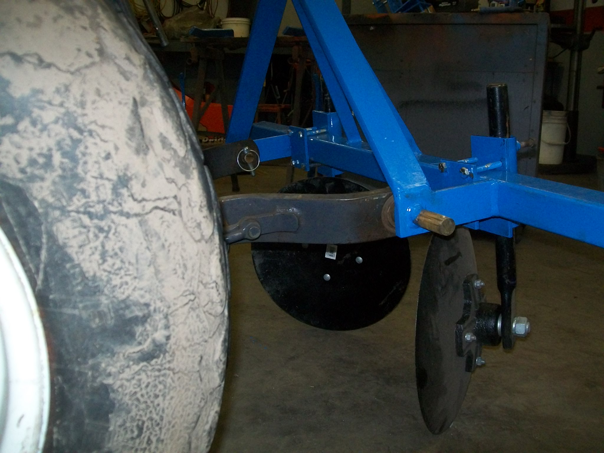

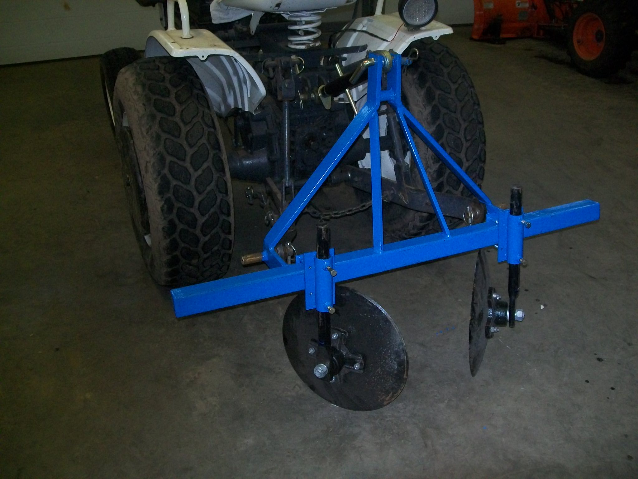

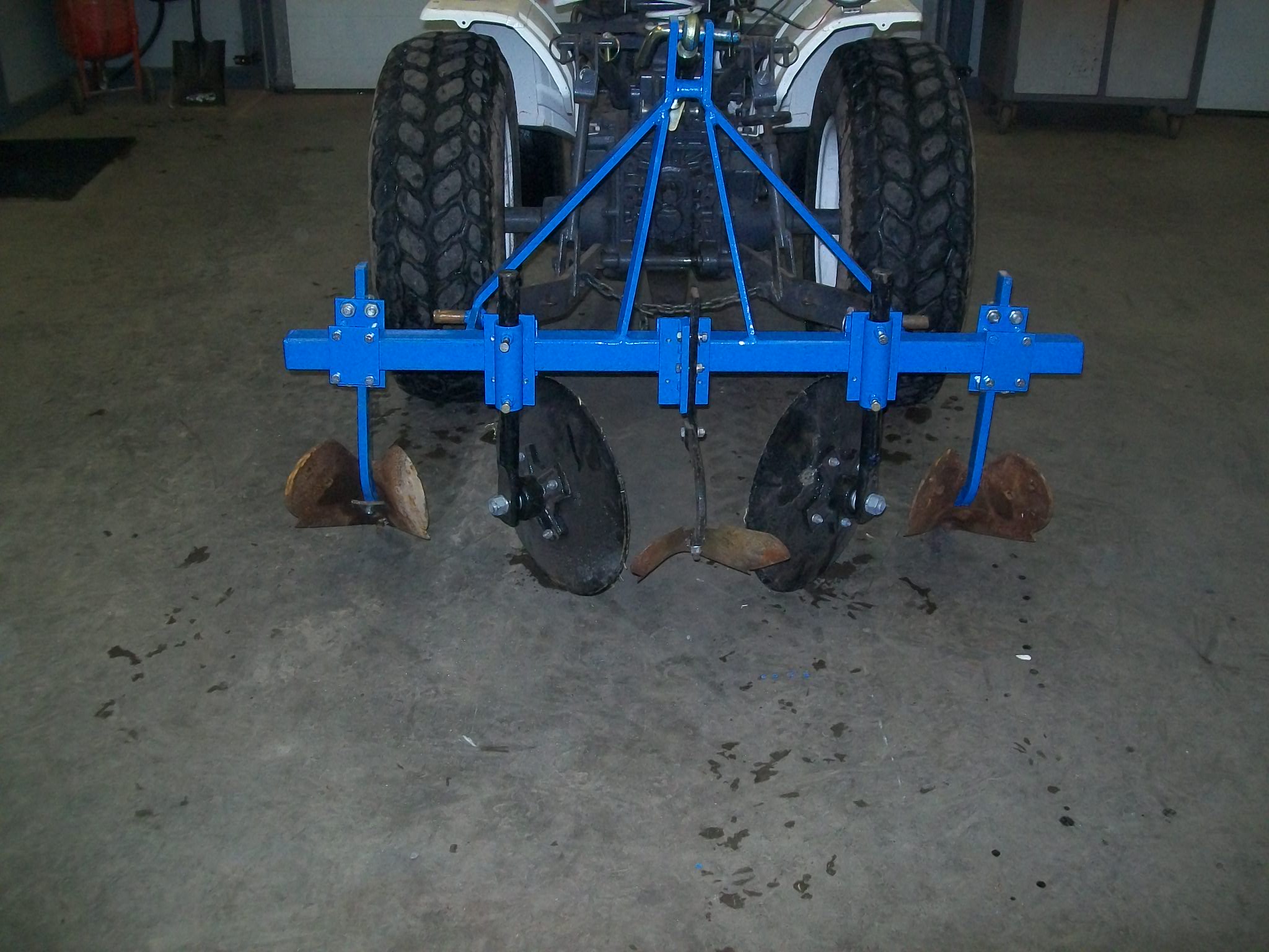

Just finished my hiller / cultivator toolbar, be a couple months before I can test it. First 2 pics are with the hiller discs, and last one is a picture with everything attached

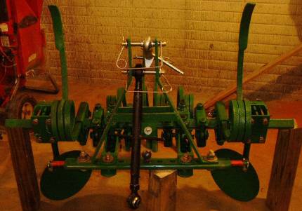

Here's the rig that I had for my 4010. I'd used the disc hillers to make raised rows. I made this rig up with smaller discs and put some of the old "soil ripper" cultivator tines on and called it my "row maintainance rig". I never used it, as I just plain decided to go no-till after making the raised rows.
Finally gave it all away to a friend who has a 4010 like the one I had. I quit my big garden due to health problems.
That looks very good - please post few photos when you get to use it this summer!

thanks, I will post a few pics when I get it figured out. I have a feeling I will be scanning the posts looking for tips on setting it up
