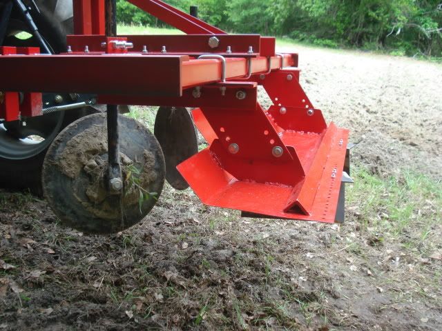

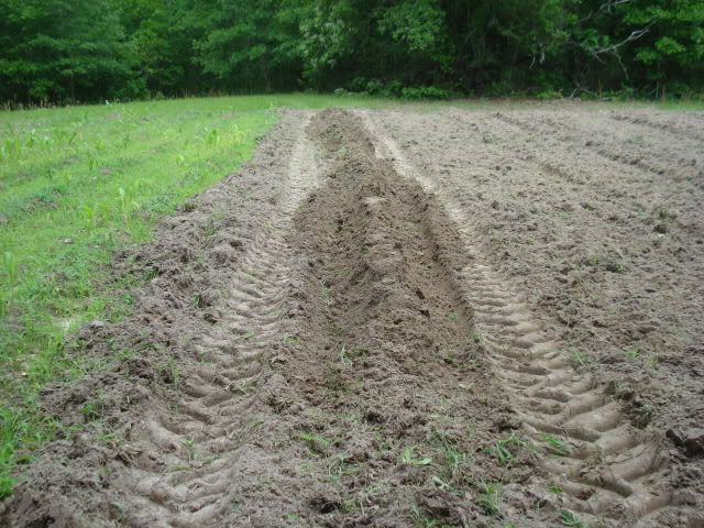

Well I am back at the farm and hit it early this morning. Took my new toy to the field to see what she would do. On my first pass all I got was the hiller disc making hills with the pan never touching the dirt.
I lowered the pan and tried it again and still never got the pan all the way down to the dirt.
Next I raised the hiller disc and decreased the angle on them some and gave it a shot. Starting to get somewhere now.

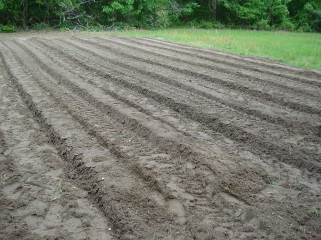

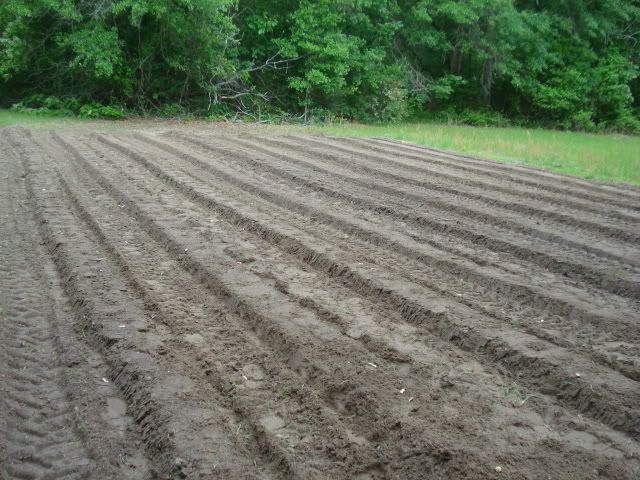

Finally I started playing with speed and how far to lower the 3 point hitch. I set the stop at what worked best and found that in 2nd gear, low range, and 2000 RPM worked best for speed. The soil needs to be worked up well for my bed shaper to work so I hooked up the tiller and ran over the plot again. This location has lots of grass clumps and I broke it up as best I could. I think I can play with it more and do even better but a thunder storm hit and put an end to my playing and got me soaked to the bone.

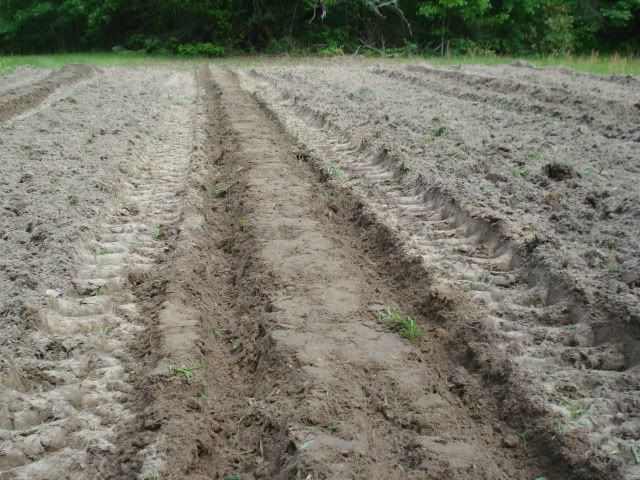

Here are the final results.
Put my keys down to show bed height.
   / Disc Hiller Project Got Out of Control #18
You need some moldboards to get those hills up.
Seeing the pics reminded me of why I got rid of my Disc Hillers and built this instead:
I dont think discs move enough material to make a nice bed...probably better suited for "cultivation" type tasks. I'm currently pondering combining the two...a moldboard type blade combined with your pan design and mulch/drip tape laying capabilities... Single pass gardening :thumbsup:
