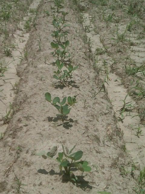

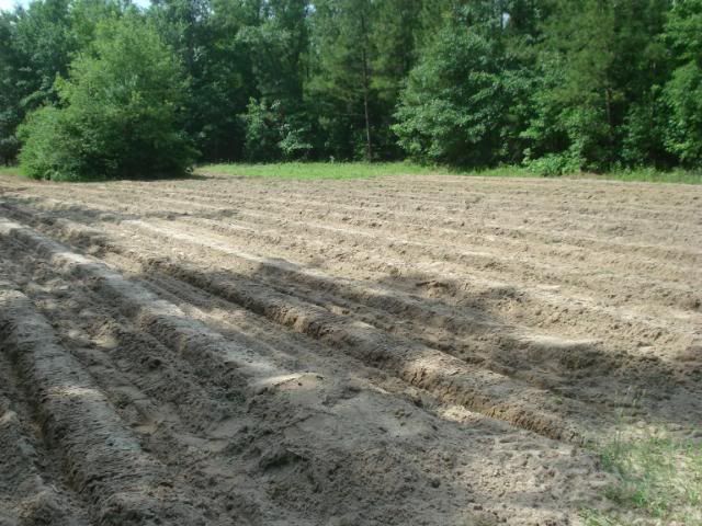

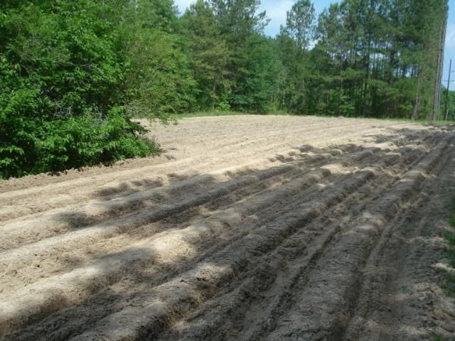

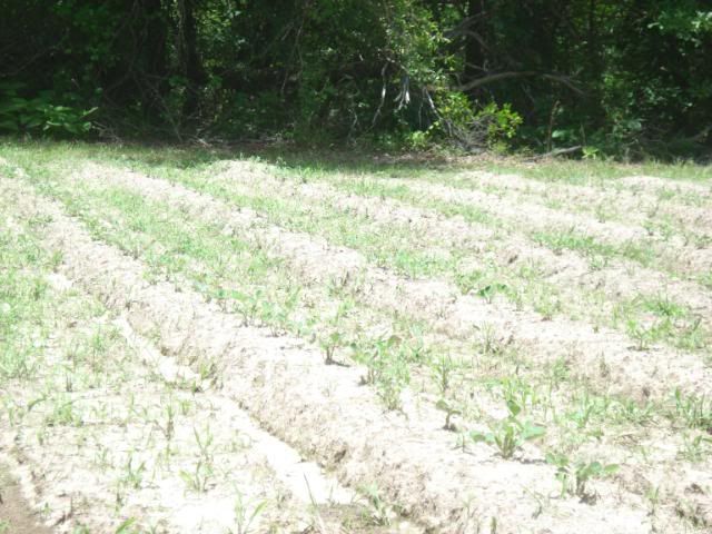

Well my upgrades did not work as well as planned but after many adjustments I finally got a few good looking rows. I should of left it alone, Soil prep is everthing and boy could I really use a rake to get the grass clumps.
Here are some updated pictures of my result as well.
Here are pictures of what I did 2 weeks ago on my first test run and their results, my peanuts are looking good.
   / Disc Hiller Project Got Out of Control #33
Lookin good for sure!
Nice Peanuts! Better then mine...had an extra row in the garden so I planted a row myself more out of curosity...dunno how they'll turn out this far north..

The deer found the peanuts and have about wiped them out. Glad deer season is only 2 1/2 months away, starts August 15 with rifles too!!!
DANGIT!!!
