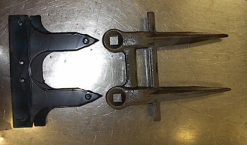

All drum mowers are fine when they are on the ground mowing. The problems comes into play when you are cutting and run up on a rock or stump or a deer bedded down and have to pop the lift up quickly to avoid a crash. If you are on a hill the left side of the smaller tractor can gets pretty iffy.I am very familiar with your drum mowers, I bought one of the CCM drum mowers at a Ky consignment sale recently for cheap. The seller said it was 2 yrs old. I reworked the machine and sold it for a small profit. The double action mowers are precision hay cutting machines and have no business in the woods cutting tree limbs. From my 34 yrs experience, The heat treated rock guards on the Superior and Enorossi mowers are just as durable as conventional sickle guards. Ken Sweet
/ disc mower recommendation #26
So Ken you are saying the OEM G&S 4mm thick stamped sheet matal guard (Pictured)is as durable as the forged double Guard? What was the name of the bankrupt tool & die make you worked for?
/ disc mower recommendation #27
Just as strong. Do a rockwell test to verify for yourself. When I retired from the Tool and Die business, the company was owned by Kraft Foods. Did they go under? When I was buying from BuySmart/First Choice and you worked there, you pushed the Fort disc mowers and Sicma/First Choice roto tillers like they were the worlds VERY best. Now Turkish Equipment is the VERY best. :confused: Mark, you and I have took up enough of this nice Ladies discussion and I am going to let you have the last word, even though, it will probably be slanted toward what you are selling at a given time and how good it is. Ken Sweet
