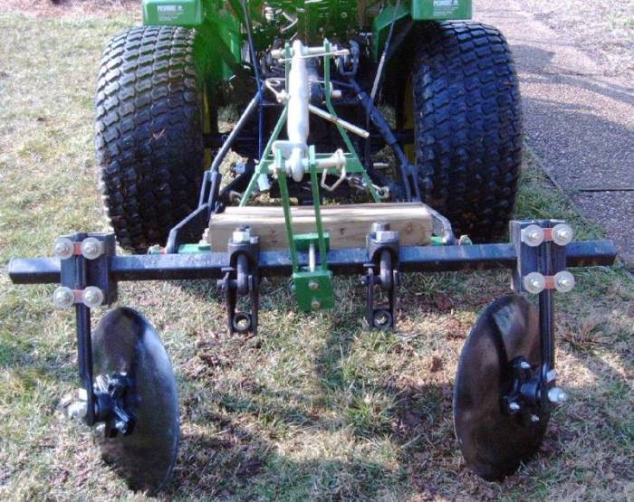

I pulled two big disc hillers with my 18.5 hp 4wd JD 4010, with the discs discharging to the middle. I'd think if I turned one of the discs so that they discharged in parallel, like you're asking, that it would do it. Not sure how well it would hold the line though. If you had a good trail guide wheel to help it hold the line, that it would work.

hillers are a bit of a different animal.
enough weight will be needed to make use of traction too.
a 40 hp tractor that is light and can't get traction may plow worse than a perfectly ballasted 30hp machine.

You're moving the same amount of dirt in a disc hiller with discs opposed as you are with the discs parallel to each other. So, a given hp/drive (2wd heavier tractor or 4wd lighter tractor) will pull it.
Problem with a lighter tractor is that the side force generated by the parallel discs could throw the tractor into not going straight. That's why I said that a disc plow with a good trail wheel may work on a light tractor.
This is what my little Gravely tractor had with a single rotating plow, a trail wheel of sorts that kept the tractor going straight.
It wasn't a "trail wheel" on the Gravely, but a leading set of wheels. With at least one wheel up against the ridge made by the previous plow run, the machine would go straight.
