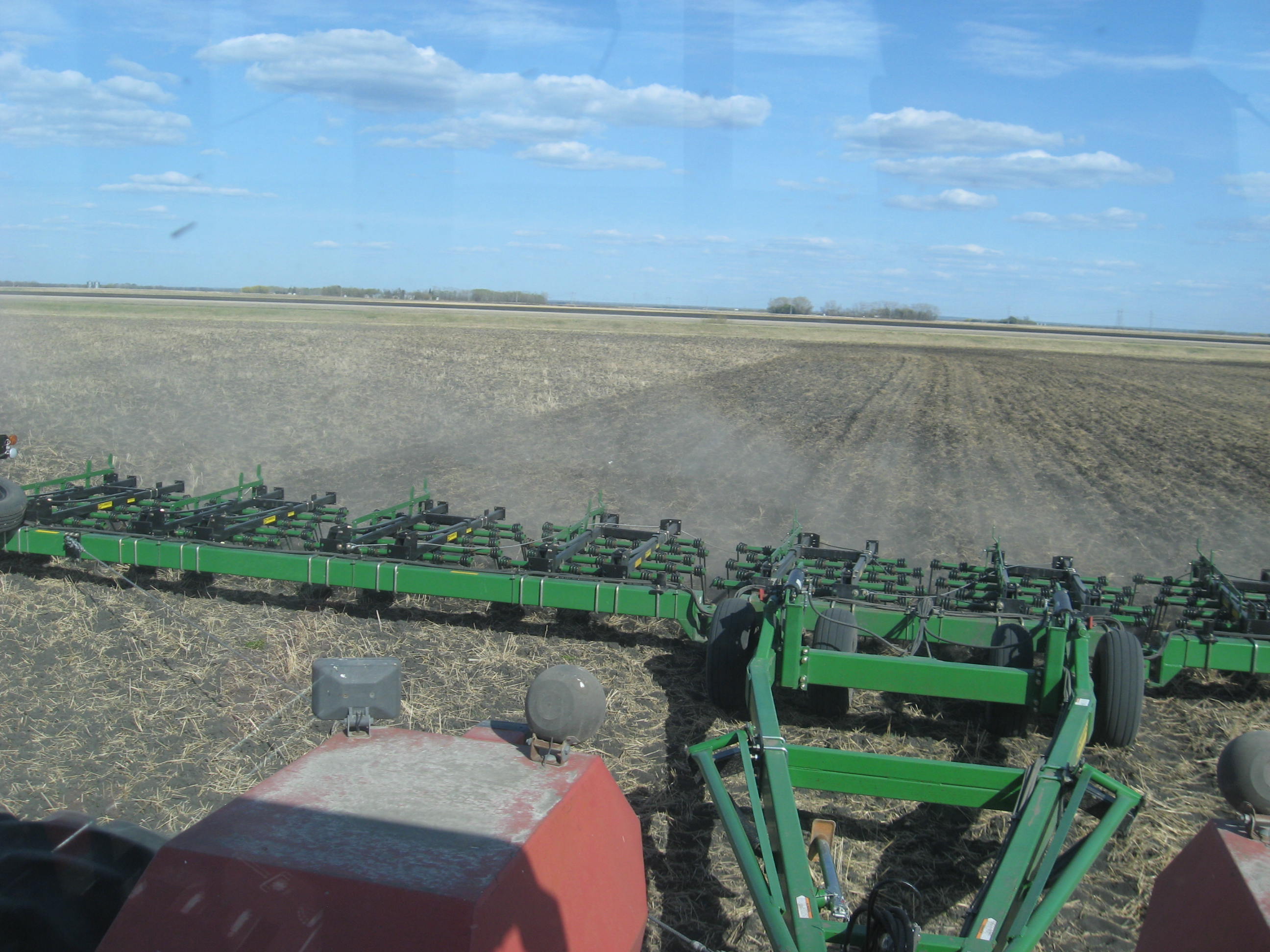

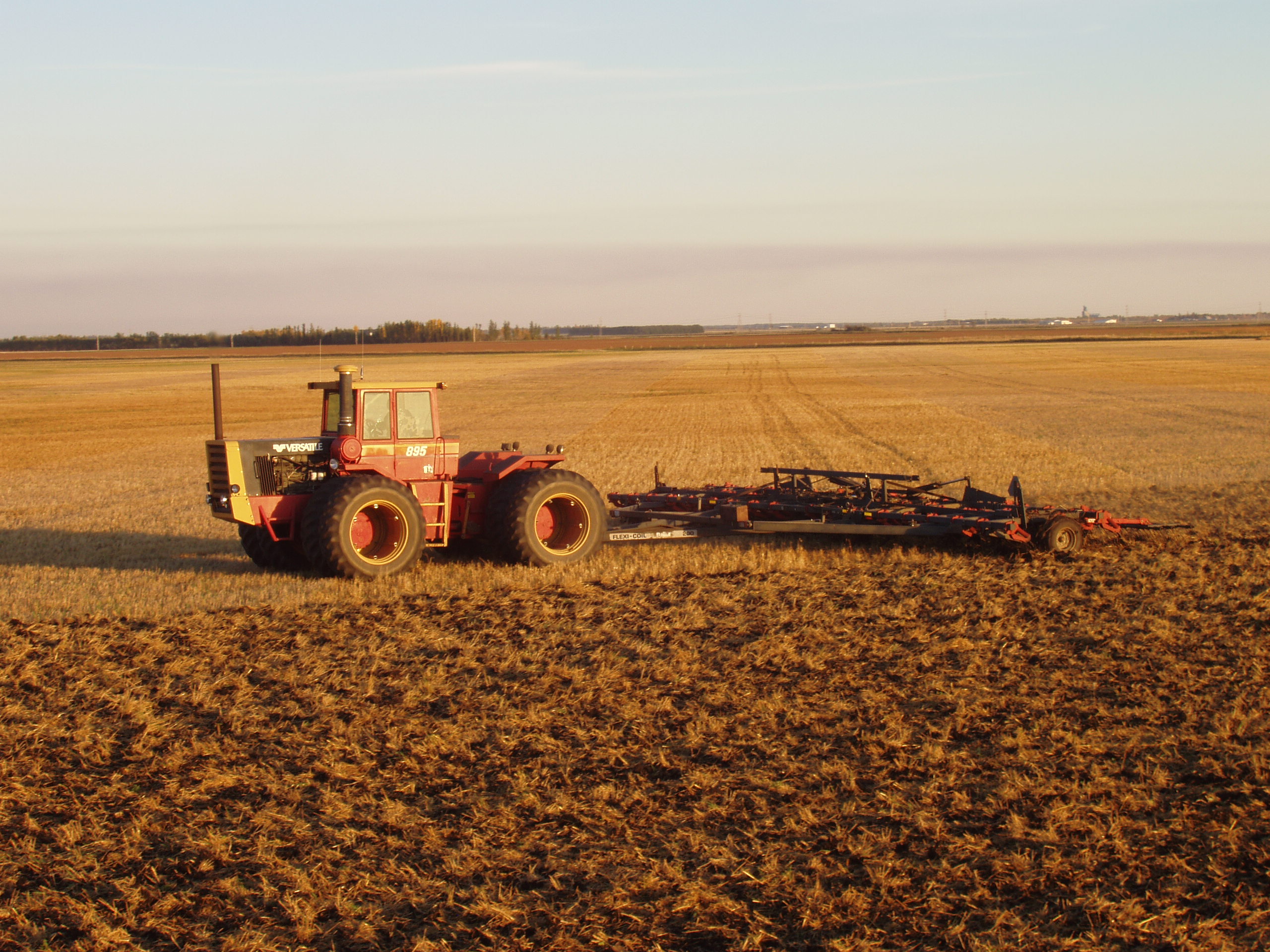

We try to work as little as possible in spring to avoid compacted wheel tracks and bringing up nasty lumps of clay . Chisel plough 4-6 inches deep twice in the fall in two directions then once over in spring with a tine harrow to warm and dry the soil whilst incorporating fertilizer ahead of the planter .
