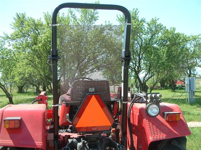

One final thing--discbine blade turn at very high speed and can toss rocks and debris in your direction. That's why a cab is a nice safety feature when using that type of mower. I've seen several tractor cabs in for repair of windows that were pretty well smashed by discbine debris. Personally, I wouldn't rely solely on the discbine curtains to keep flying stuff from heading my way. I'd provide backup. For example, when I use my brush hog mower, I have an expanded metal panel attached via hose clamps to my ROPS on my Mahindra 5525 to protect my backside.
