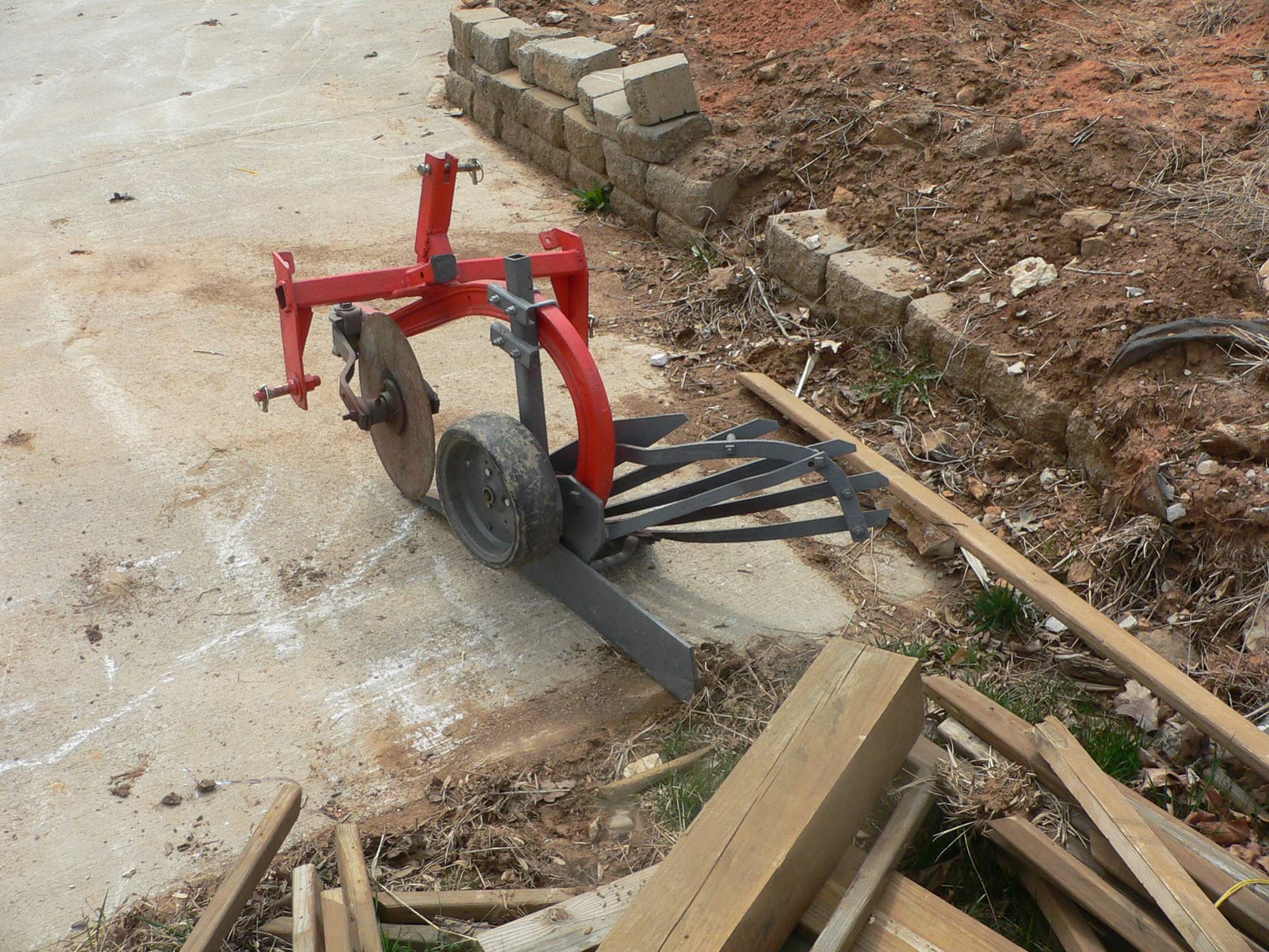

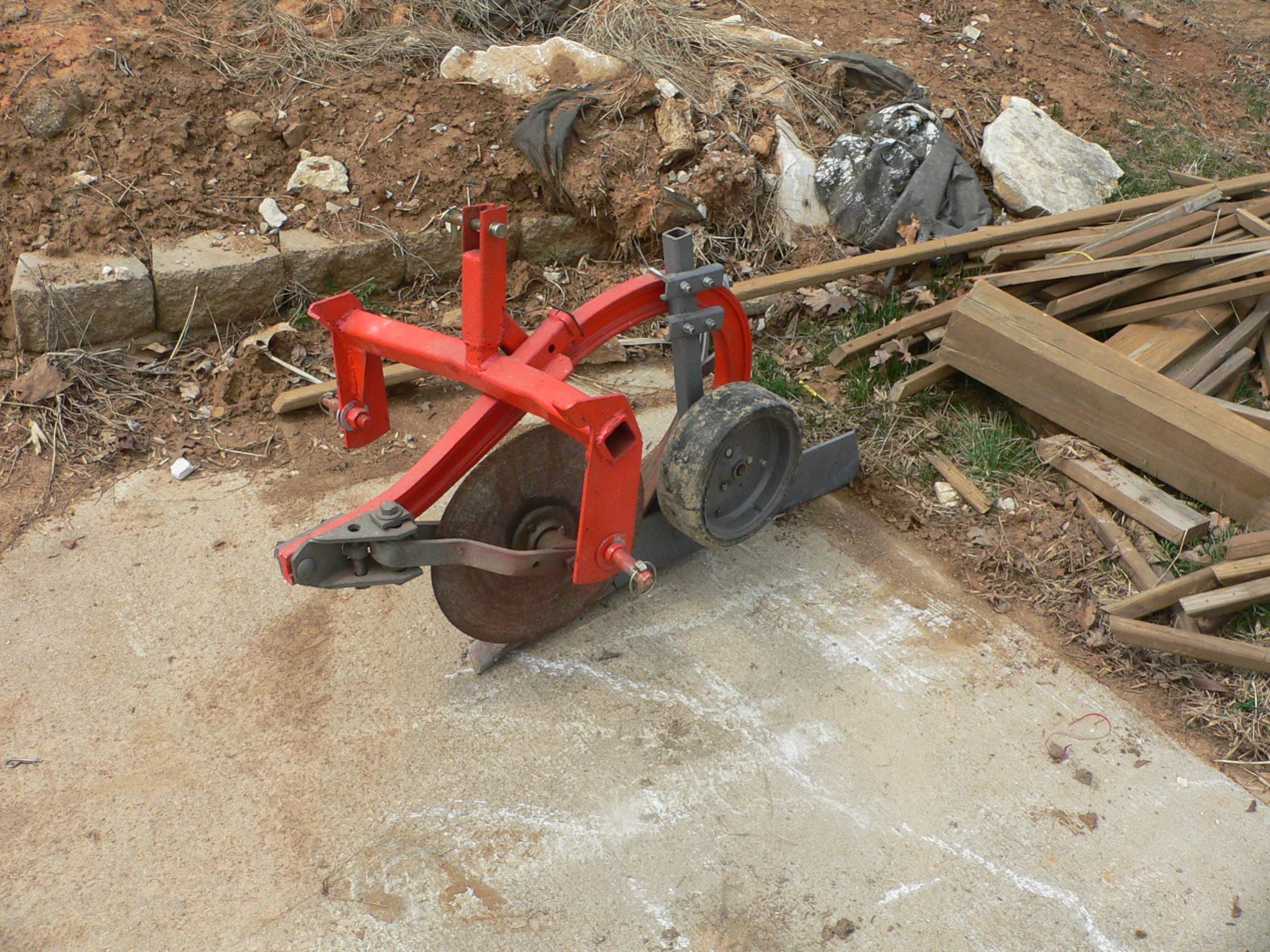

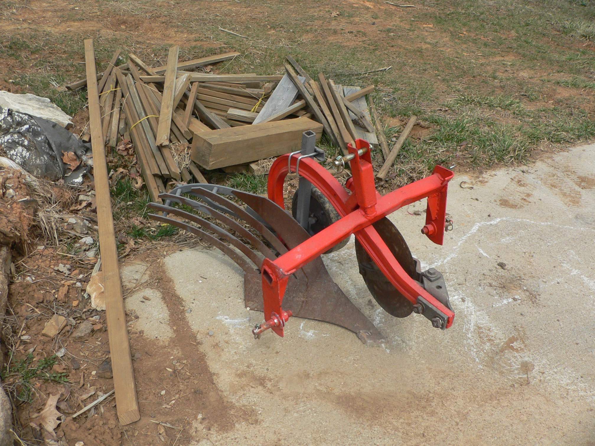

For example, I first bought a Cat 1 sub-soiler/middle buster. Dang, I couldn't lift it high enough to go anywhere and I have the improved geometry Cat 1 of the BX1860. I bought the XB version instead. The gal at TSC was great and helpful. This XB stuff is where a BX1500 owner should be focusing.
CountyLine Middle Buster Sub-Soiler Combo - 2122476 | Tractor Supply Company
CountyLine Middle Buster - 2128228 | Tractor Supply Company
