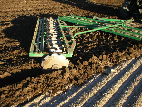

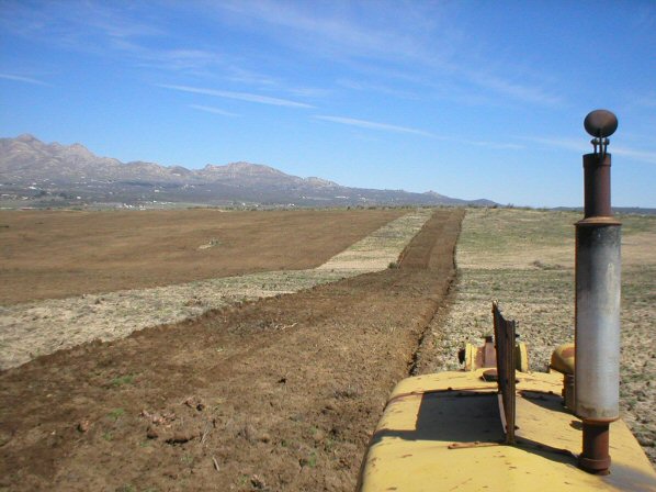

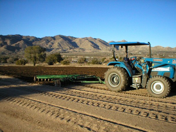

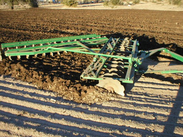

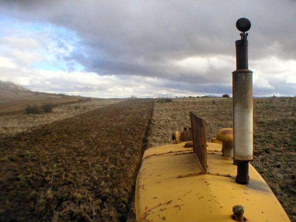

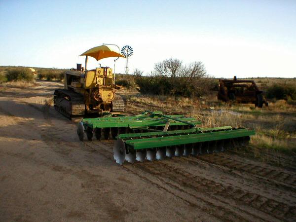

We also have a 12 footer of the same type. The 75hp tractor will pull it on flat ground for a first pass only, it won't do it after that. We use our old CAT D6 to pull it over most of our land and if the conditions are right, even it will get the tracks on the CAT slipping (spinning out). :eek:

What are you growing in those fields?
WEEDS. :( We were burned out 12 years ago, :eek::thumbsup: I just keep things disked up when I have a chance. We had another BIG wildfire a year ago or so, came within just over 1000 feet of our place on the East and South sides of our property. If I can ever afford to get a bat wing, I will just keep most of it mowed. ;)

No problem turning, as long as you turn left. Disks pop right out of the ground. Cutting depth is adjusted by the angle, less angle=less depth. Transporting on the ranch is no problem, set the disks straight and they just ride along on top of the ground. Sharp turns, no problem, but only as sharp as the draw bar allows before it's up on the tire or track. :eek: If a person knows what they are doing, the only time that it's tough is when you are on the first row and you have to turn and come back right next to where you had just left. You get use to it and it becomes automatic. ;)
First row is hard, need to keep it straight and that is hard when you can't see the other end of where you are going. Second row is easy after you make the super tight turn. lt's easy after that. :thumbsup:
