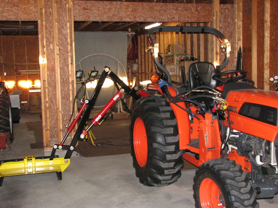

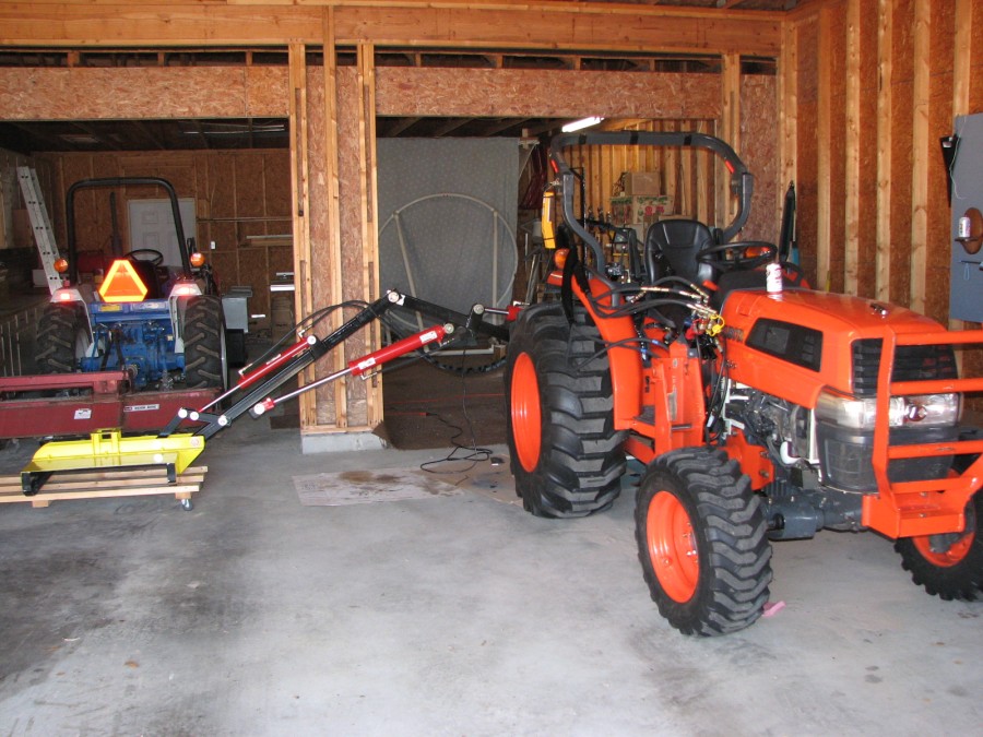

Hi Minimax, The only way to get it higher is with 3pt hitch. The 1st cylinder moves arm up & down, 2nd cylinder moves arm in & up, 3rd cylinder deck tilt. I hope that’s enough movement for what I need.
Thanks, Joe

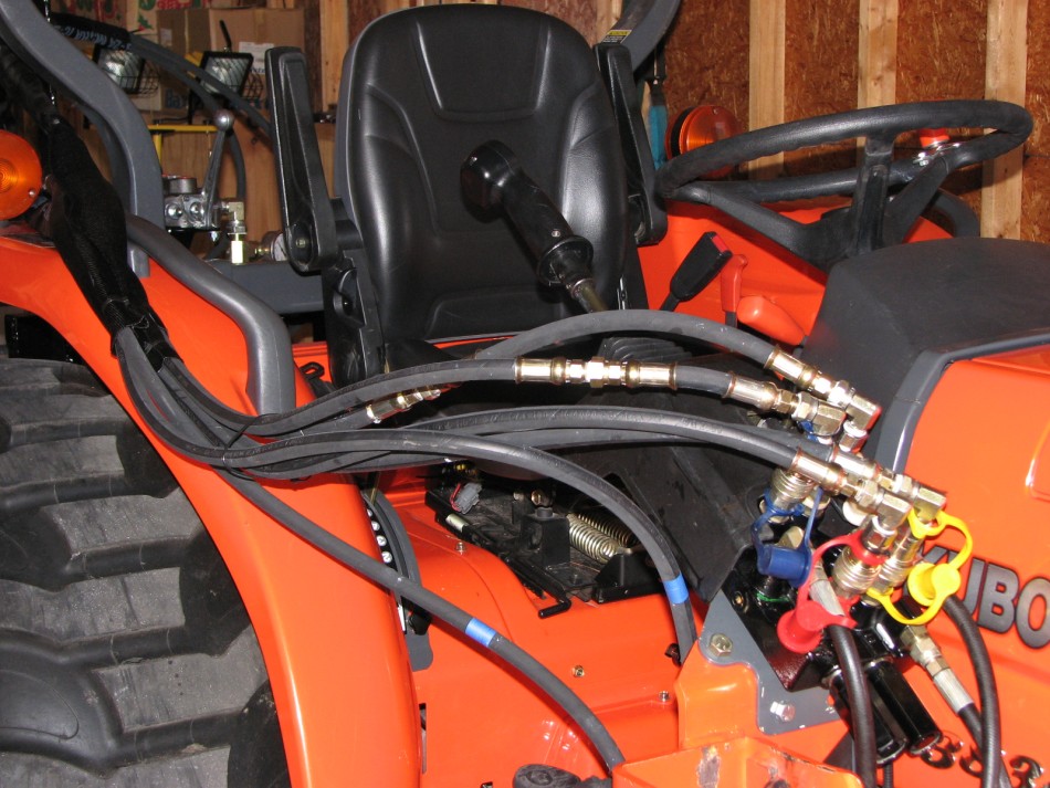

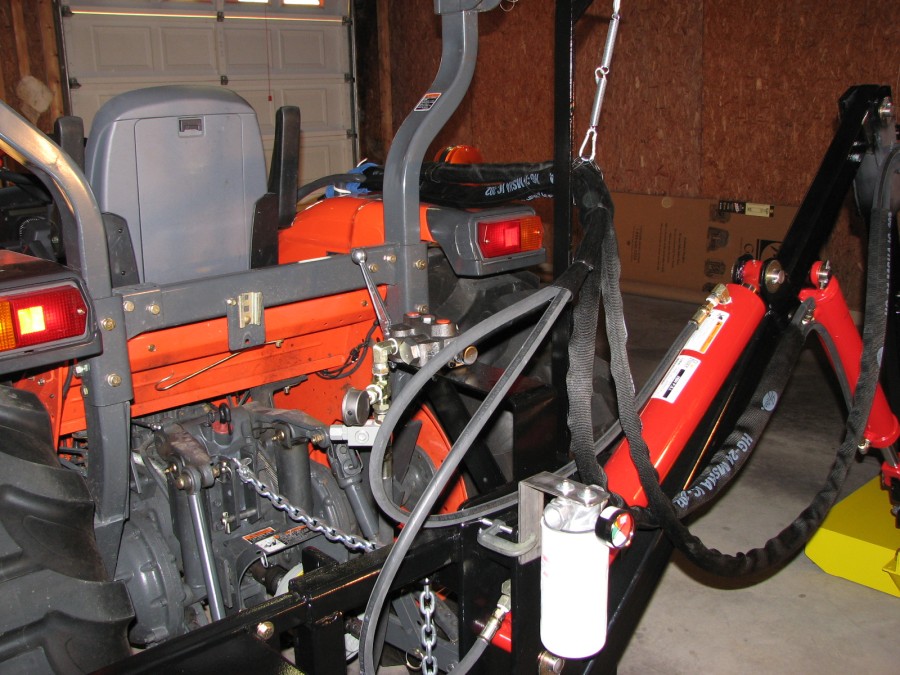

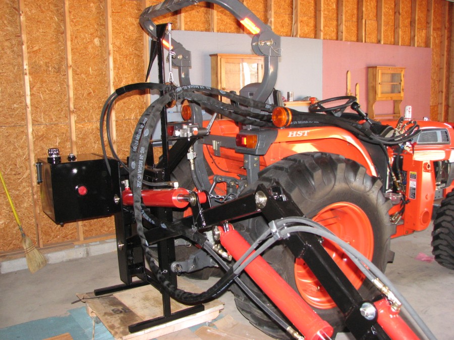

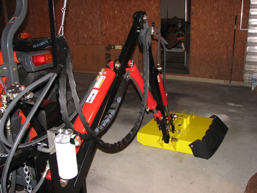

Hi Guys,
I had some time over the Holidays to work on boom mower project.
I ran the hoses to the cylinders and I have almost got them under control.
Trying to get the hoses to go where you need them and also have enough
slack not to pull one apart is touchy. There is a web of hose around the
joystick valve, plan to later run a three spool valve off remote hydraulics
at a later date.
Working on the PTO pump and all the hoses and valves that it takes to
run a hydraulic motor. I still have a way to go but I can almost see the
day this thing might actually cut something.
A few pics, see ya later,
Joe

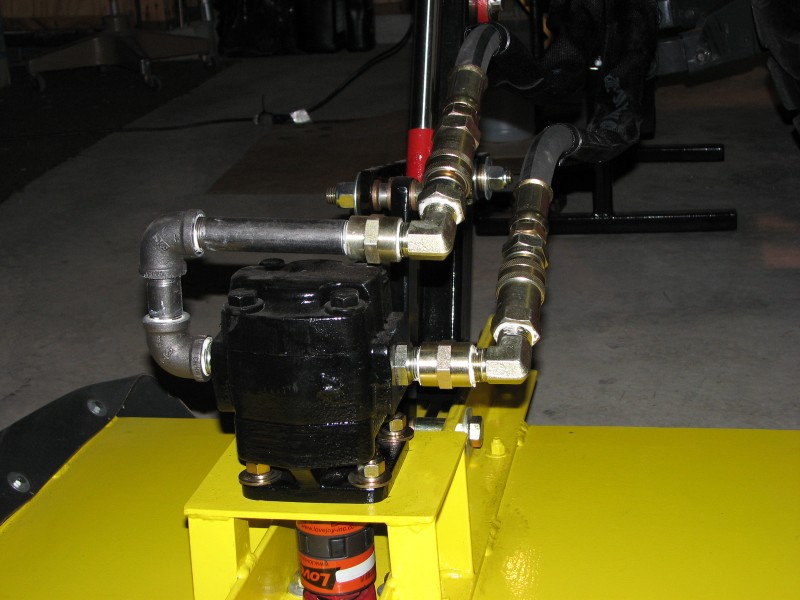

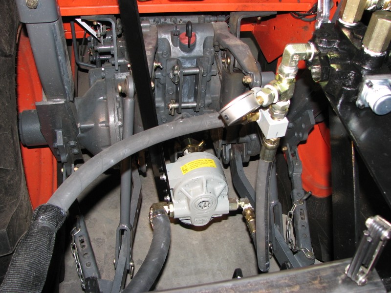

Hi Guys, Update on boom mower project. I have all the cylinder hoses hooked up and functioning the way I had hoped. Of course there were a few bugs to work out but I didn’t expect a perfect fit.
I have the PTO pump, valves, filter, motor and all the other stuff for a self contained hydraulic unit set up also. I am not sure of blade tip speed, but it sure whizzes it. There were plenty of bugs in this thing too.
The last thing, I hope, is the counter weight and I am working on that now.
Couple pics of pump and motor.
Thanks, Joe

That is a real nice setup. I noticed on the pump it looked like you could put a spline in the back and maybe run 2 pumps at once. Some folks may be interested in that if they needed more flow. You could probably hire out to mow ditches, pond dams, ect. if you wanted (or was this part of your original plan).

Hi Joe. Hey your work looks great. Very professional. One question: Do you have some type of shear pin on the blade assembly in case you get into a hidden rock,stump etc? Much easier to replace a shear pin then the time to change out your lovejoy coupling. FYI if the rubber insert has a hard time handling the force of cutting, lovejoy makes a bronze insert for their couplings as well. Had fun watching your project. EL

Thanks so much for all your comments and very good advice. El, right now I have a rubber insert in the Lovejoy, I’ll know when I stress it if it may need a bronze insert. I may try to mill an adapter to mount a sheer pin instead of the Lovejoy, if I ever get time.
