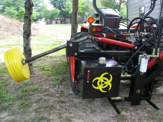

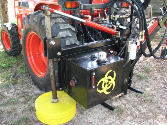

Hi Guys, I made a change to the counter weight that allows it to pivot down when not in use. I added a cylinder and valve that will raise and lower the weight as needed. I was like some of you and didn稚 like it sticking straight out without any mobility. I don稚 have any pictures of the change but when I uncover it I will post some.

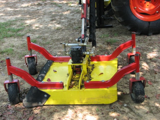

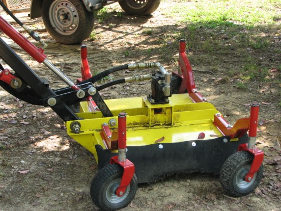

There is another change I will be making and that is adding wheels to the deck. They are swivel and much like another poster here used on his bank mower. I think it will be much easier to control a mower that rolls vs. one that is trying to follow contour with operator controlling every move.

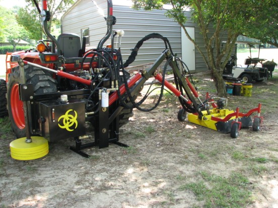

Hi, I wanted to post some updates to the ditch and bank mower, most of this is your suggestions.
One of the main problems I tried to address was a way to raise and lower counterweight.
Changed from a rigid, straight bar to a hydraulic cylinder to move weight out of way.
Added casters to the mow deck, this really makes the deck easy to control.
Thanks for all your ideas and keep the new thoughts coming.

What if you were to put on parallel linkages like a self leveling loader so that once you set the angle it would be maintained while moving the mower. May make it more user friendly. The counterweight cylinder could be attached the same way so it moved out as the boom went out. Just as long as a guy watches both sides as he mows :) or else ;-( LOL
Also having the mower "hang" from a chain or slide mechanism to help it float.

If you slam that mower into something and bend one (or more!!) of the wheel assemblies, next time try a single roller on each end. They take up less space, take more abuse, don't require filling up with air and don't go flat. Steel rollers work better, but plastic is lighter (and burns better;btdt)
