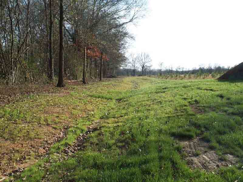

   / ditch digging #14
If the ditch is going to serve its purpose it can't always be shallow, and the deeper you go the wider you have to make it if you want to be able to drive through it to mow. The ditch in this attachment goes from nothing at the far end, about 600 feet, to about 4-1/2" at the near end where it discharges into a bayou. If you can't run a bush-hog through a ditch in this country the vines will take it in a little while!
