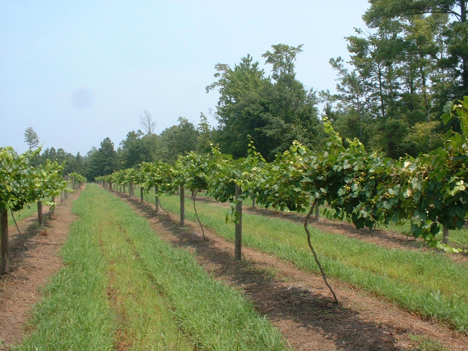

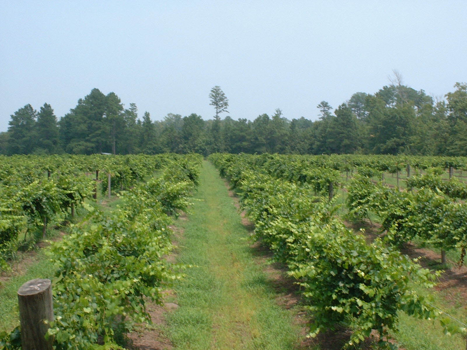

I dont know if you can see the slope from these pics but maybe just a little. If not, there free to view.

   / Ditch mower from bush hog? #36
Looks like you need one of these with and 84" version of the deck from this mower
I dont know if Deere offers those together, but it would get both sides in one pass.
If your rows were a foot farther apart (and you won the lottery) Woods, Befco and others make a "Turf Batwing" that might do the trick, it has a 5' center deck and 2 4' wings, for a 12' cut. The college I went to had a pair of them and they do a great job, however they are supposed to cost ~$15k
Here is a thread on them: http://www.tractorbynet.com/forums/attachments/97024-any-opinions-befco-batwing-finish.html
Edit: I ran across the BushHog TD1100 which seems to be a 11' 3 deck finish mower... might be worth looking at if the V in between the rows is flat enough.
Tractorhouse has a few for sale: http://www.tractorhouse.com/listing...d=1134&Manu=BUSH+HOG&Mdltxt=TD1100&mdlx=exact
Aaron Z
   / Ditch mower from bush hog? #37
Hey thks for the post. If only that middle was a little flatter and the mower a little narrower.
