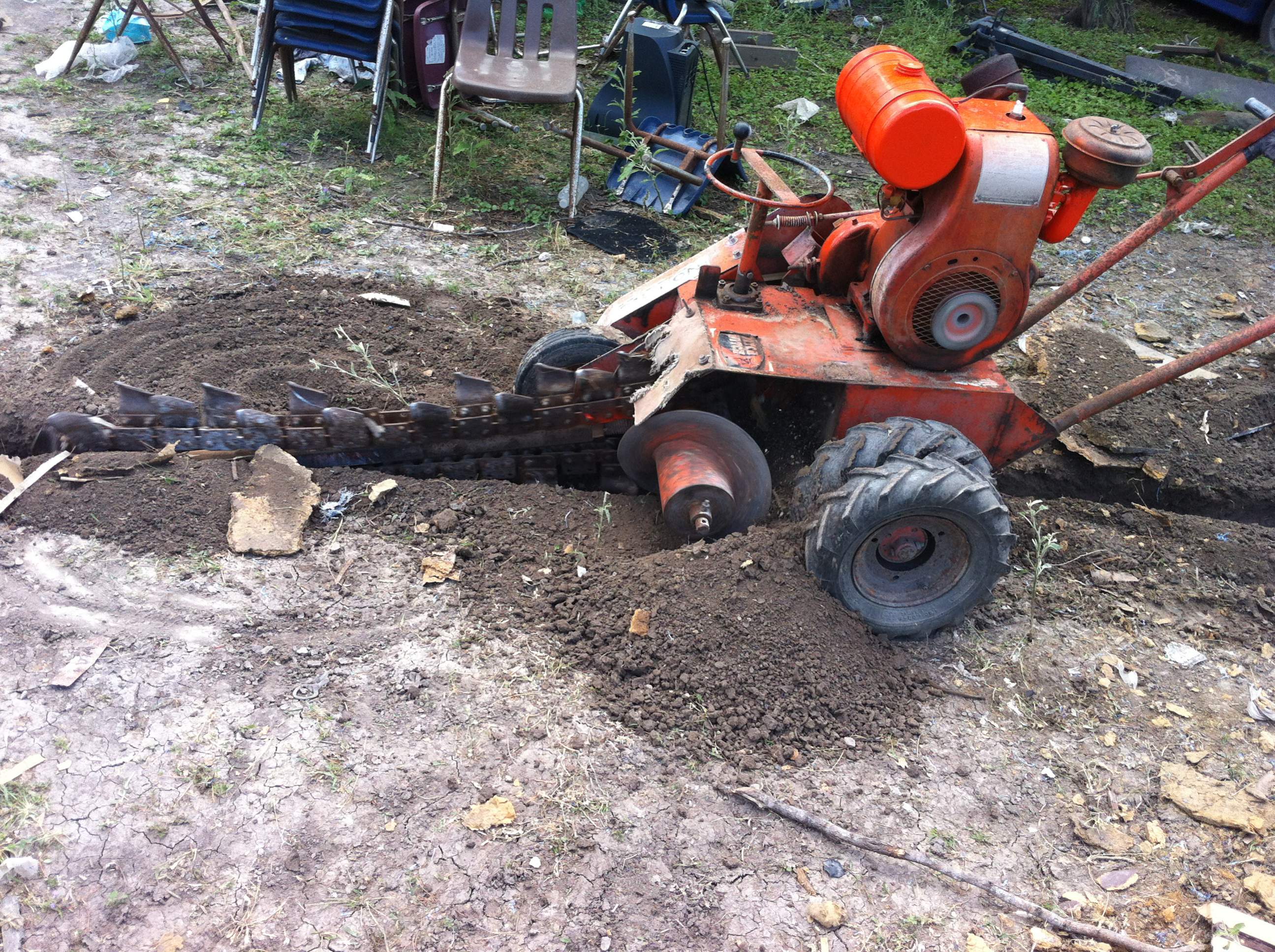

I have found that 1) I can trench more with rentals than I can possibly install in one shot, and 2) trenches do not age well.
The upshot is re-digging all those trenches out by hand with a contractor's shovel, or cobbling up something that allows the CUT to help with the chore. Neither have turned out well for me. Rain also disperses or compacts your backfill.
So, I bought a trencher off of Craig's List. Been stalking them for some time, but the $$ or condition put me off. Until now....
This "antique" Ditch Witch C-99 is an awesome little digger. It was $950 and I will call that good. The rope start kicks it on first pull every time (so far). It was well cared for and home-serviced.
Shifting forward and reverse is a little tricky. I can share one painful way not to do it, but it works pretty well once you get the hang of it. I can run an easy 2' deep when and wherever I want, and it's at least a little more maneuverable in some of the tighter places.
You trench in the reverse creeper gear, and once it's all going you can sit down and watch. It will just pull a straight line unless you hit something you should have known was there. Or an undocumented rock.

I just got a c99. Seems nice, but I haven't had a chance to use it yet because all of the rust in the gas tank keeps clogging the fuel line. I just finished putting another one on yesterday.
I have not been able to find the forward gear yet, which has made moving the trencher around very difficult. Does anyone have advice on this? I know where the control lever is on the axle, but either all the way up, or all the way down doesn't give me forward. It is also very "grindy" like 20 years of sand is spinning around in it. (And I'm sure that is exactly what it is)
