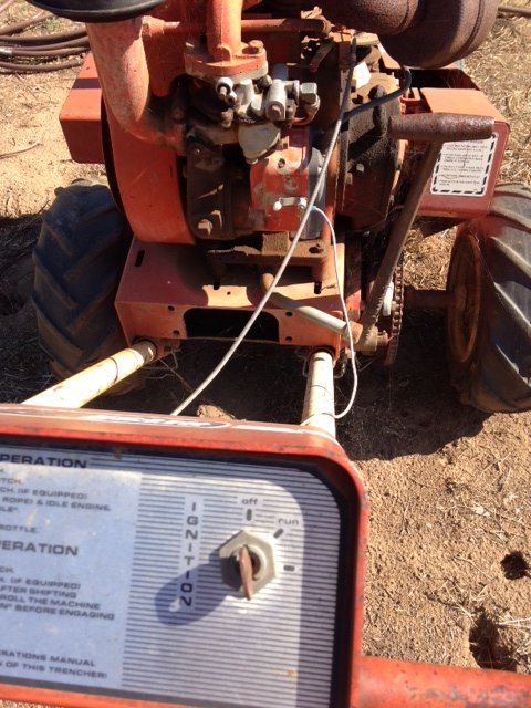

What is missing here, and how to fix it? Thanks in advance.
(Just got a C99. Haven't tried to crank it yet.)

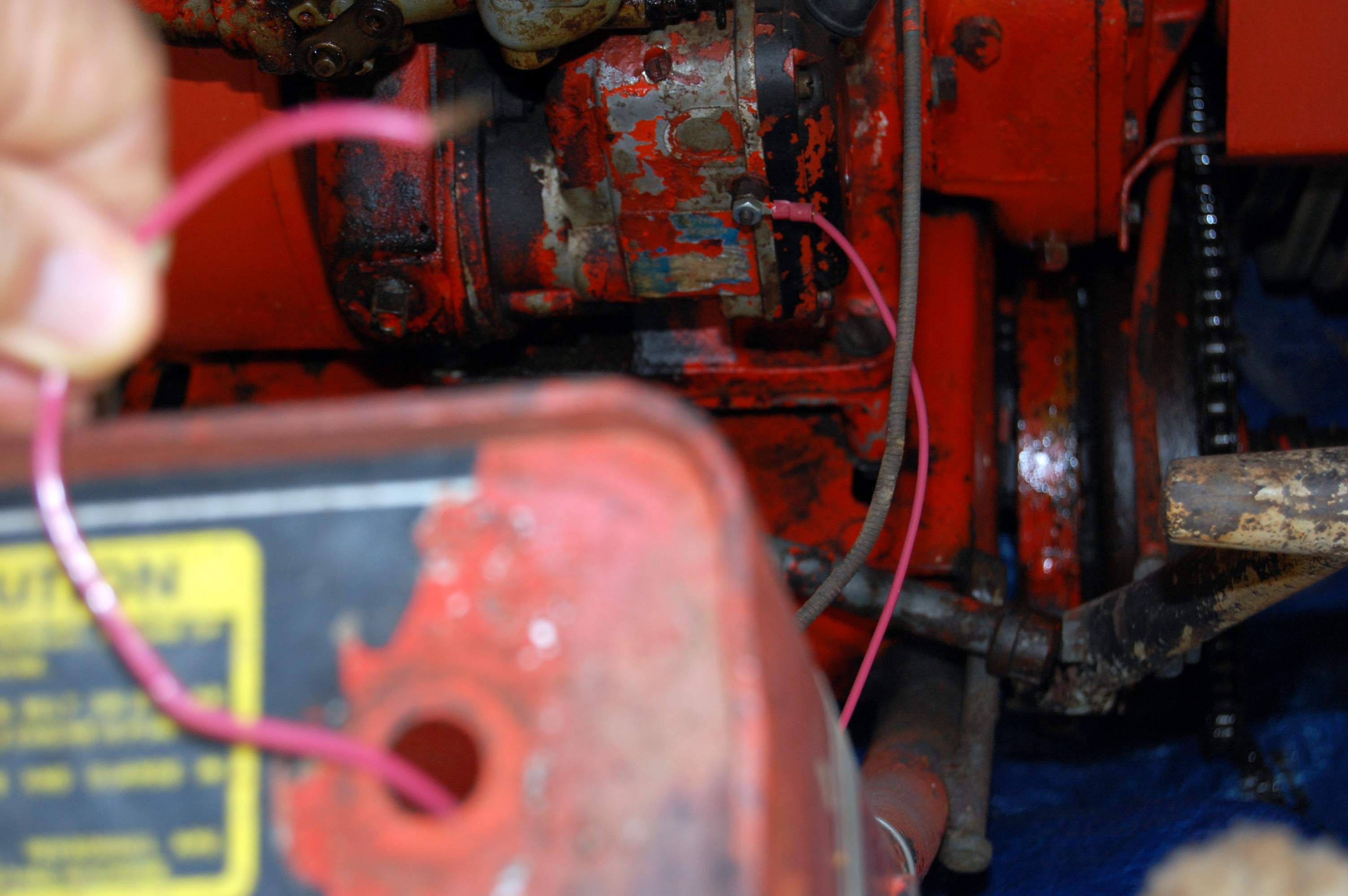

Looks like the old key ignition switch. A very simple device, that someone apparently bypassed. It does have to be connected if you're going to run it.
If you are blessed with the rope starter as I am, you should be able to just complete the circuit to allow spark. If you are burdened with a battery start (doesn't look like it) more attention would have to be paid.
Your trencher is basically hot-wired.

A poor cell pic of the back side:
You could probably wire in a Radio Shack toggle switch if you want to be fancy. A positive shutoff is a nice thing. You just have to remember to switch it ON before rope starting (wasted quite a few pulls that way).
