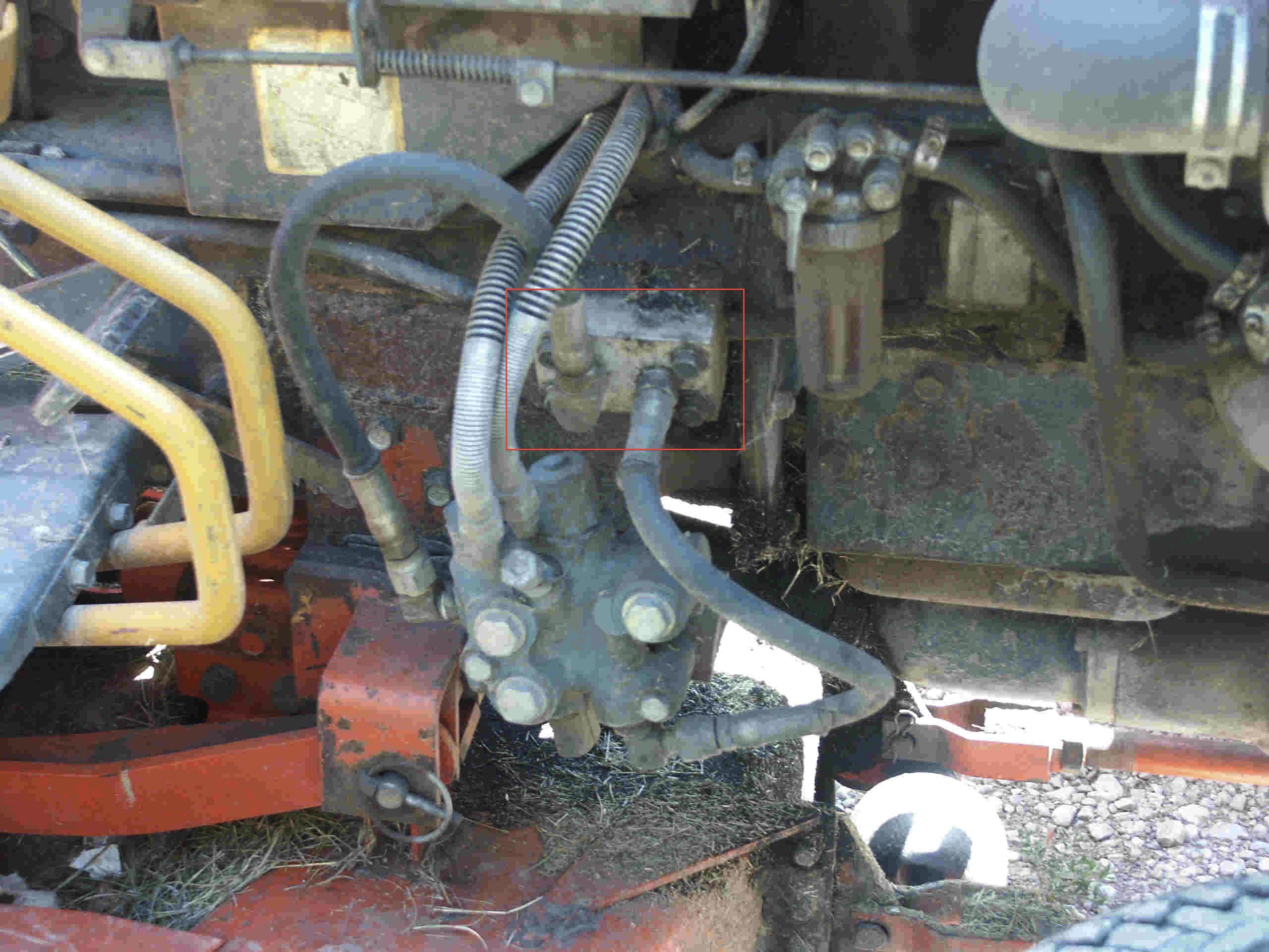

I am adding an aftermarket FEL to my B7100; I have the FEL with a four way control. The manufacture said it could be plumbed in to the hydraulics two ways. One is to cut the high pressure line and connect it with compression fittings in line. The other is to use the original connection points on the tractor. The problem is the tractor never had an FEL and the connection points are not there. I have found the part number for a diverter for the hydraulic system but not how it works. Can anyone offer in insight into this diverter?

Your b7100 should have the diverter to attach the hydraulic hoses. What you wont have is the correct cover plate with the holes drilled to attach the hoses to. You will need to buy that or build one as I did. Here is a pict of one on a b7100 with the hoses. I borrowed the pict from another post.

That's what I am looking for, I found the part number and have ordered it. Thanks for the pic!

I added hydraulics for my dump trailer and top link for my B7100. I don't remember the part number, but I bought it from Messick's.
Look at the parts diagrams. Mine cost $100.00.

That's what I'm looking for the ported cover plate
