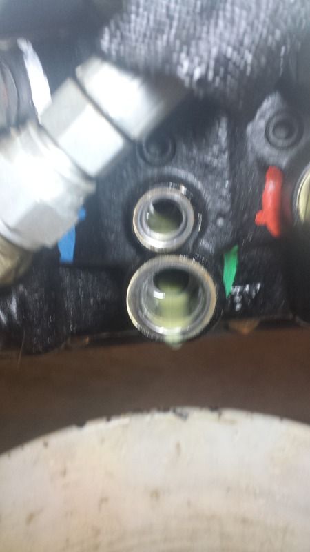

I just found out that that particular valve does not have a PB adapter.
The port for the pump flow is the green port and feeds the hyd block and then goes back for the remotes and 3pt.
I will have the schematics for the loader valve shortly.
So you should have no problems adding another valve in series.
This is the first loader valve that that I have come across that has a dedicated port for PB without a PB adapter.
