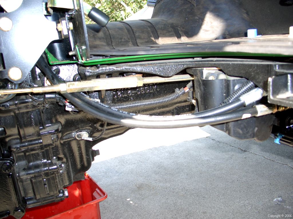

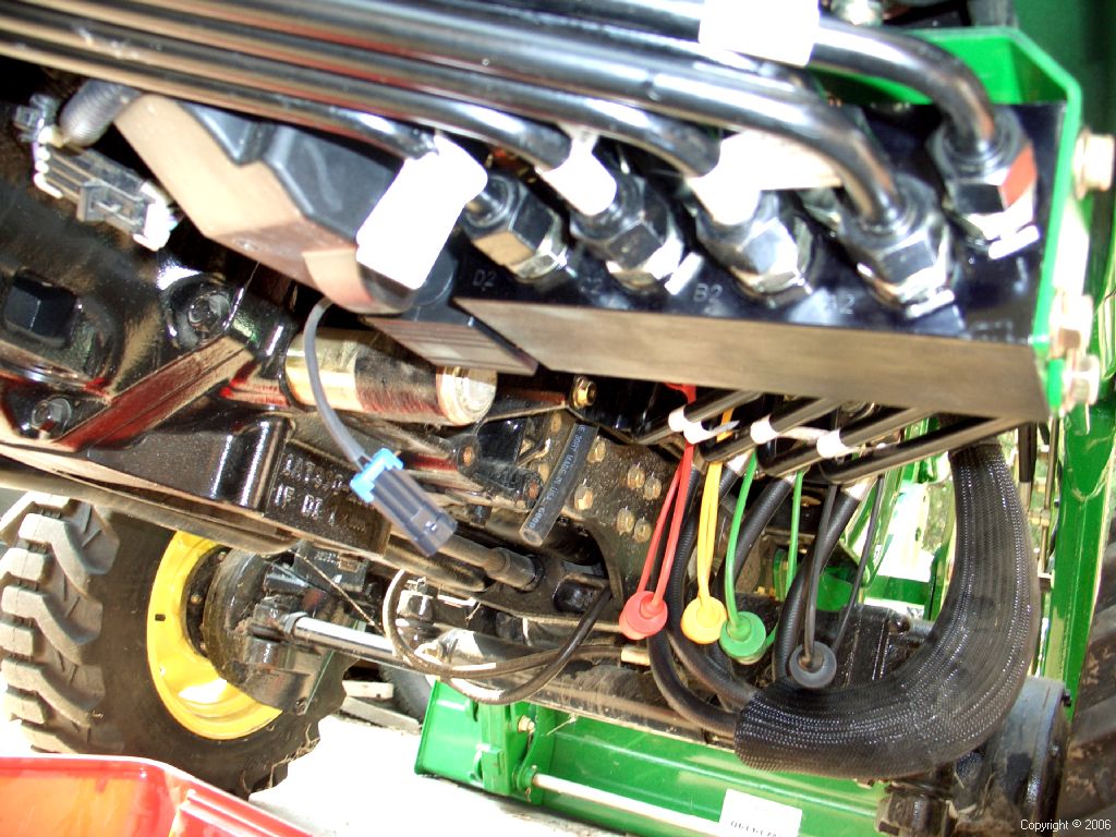

Next up is to install the first set of the 4 hard lines that goes to the dual SCV. This was uneventful. Then, the two flexible lines are then draped over the transmission to the other side.

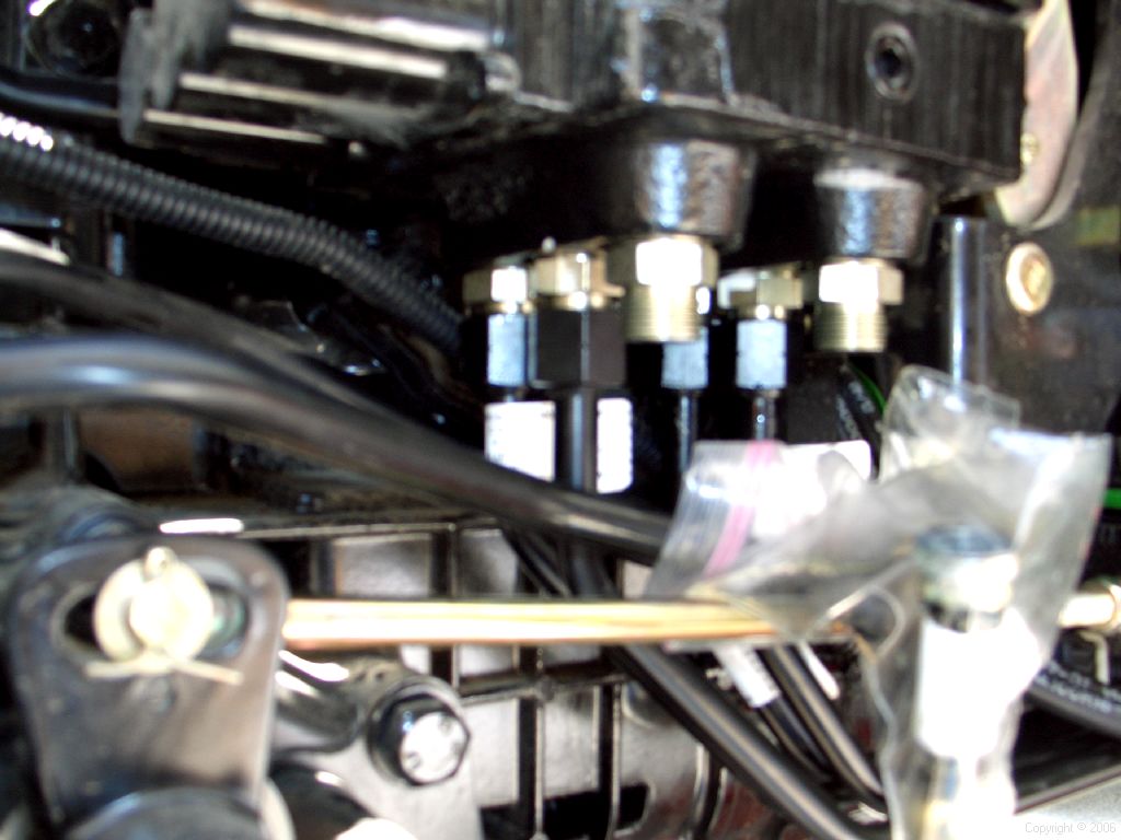

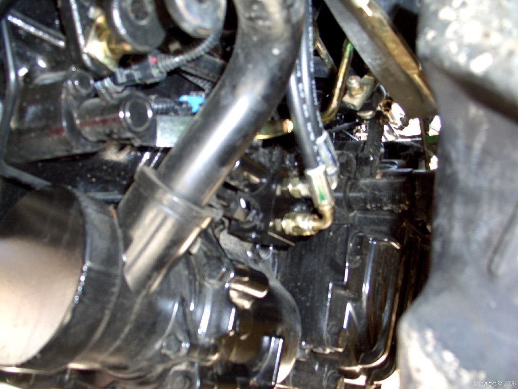

#12
Darn, more cursing! Manual now calls for removing two plugs and install two adapters into the mid PTO diverter. The two flexible lines that are draped over the transmission is installed at this location. PROBLEM: These two lines will not swivel to face the correct location with the lines cinched up at the other line. Required going back to the other side to loosen these two lines so that they can be swiveled to the proper orientation. Of course, by this time, the 4 hard lines are installed and now in the way. Again, I need to undo these 4 lines and the adapters so that the flexible lines can be properly installed at the other end first, THEN these diverter to dual SCV lines should be installed! Whoever wrote that manual should do a couple of installations first and rewrite it! If the order of the installation was properly prescribed, I the installation would have been a breeze!
First picture, lines not oriented properly and unable to swivel into position.
Second picture, line loosened at other end, correctly installed into mid-PTO diverter. then all lines re-attached/tightened once again.

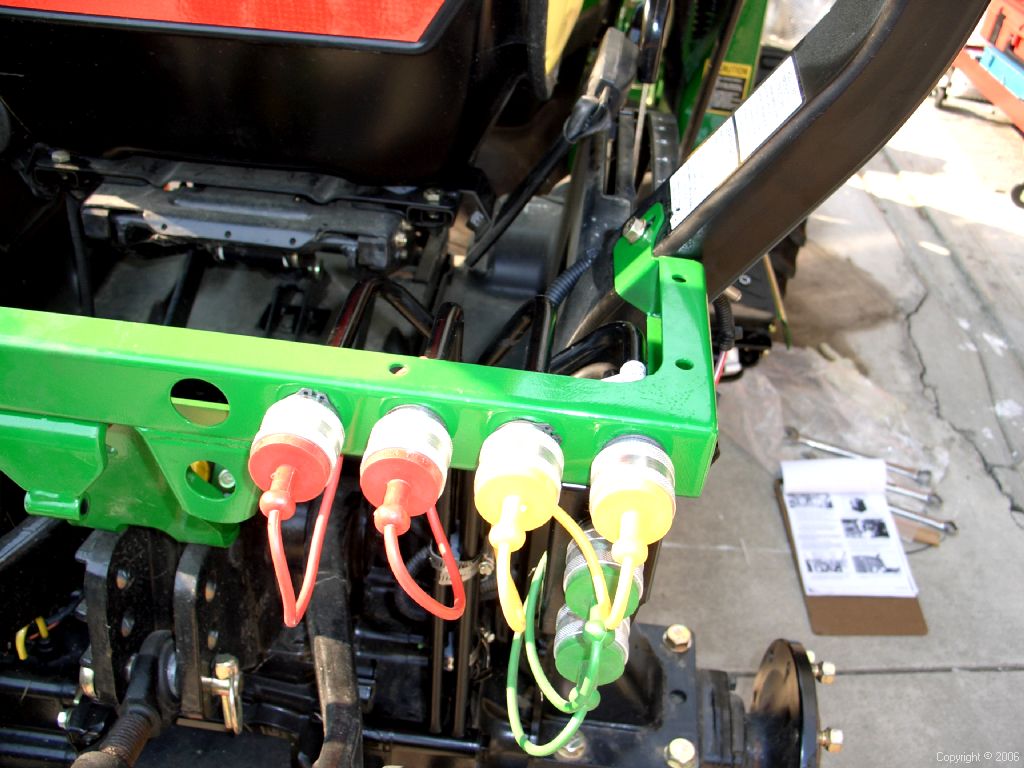

#13

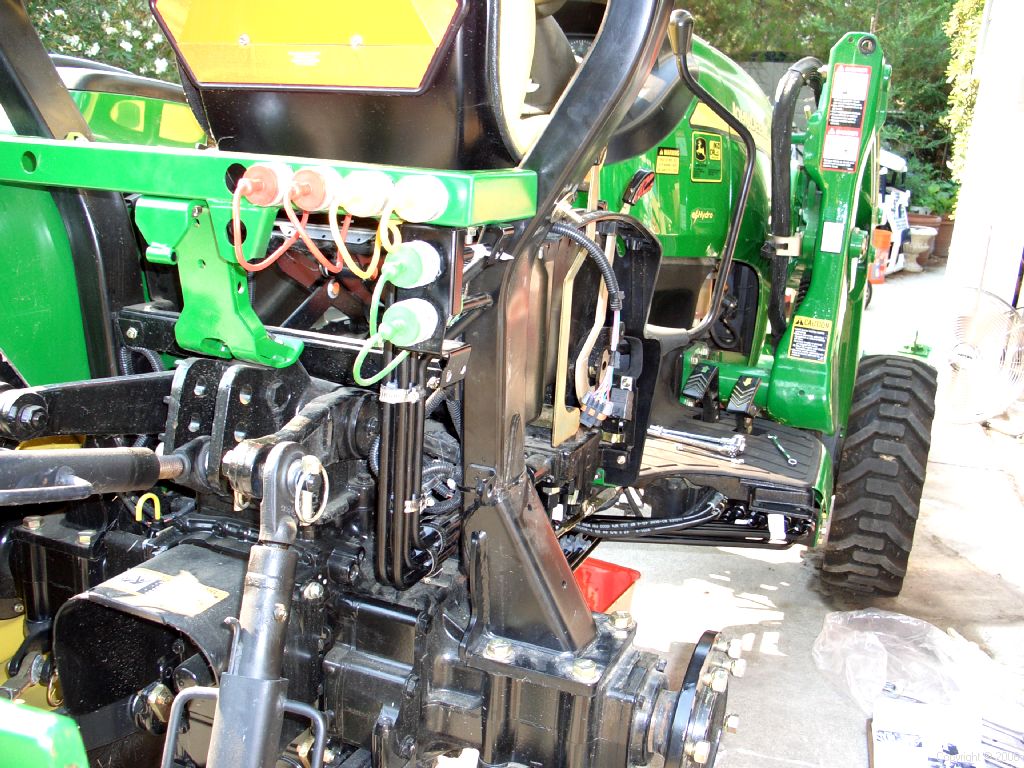

Diverter to dual SCV lines installed, 3rd SCV remote lines ready for reinstallation into front most two ports.

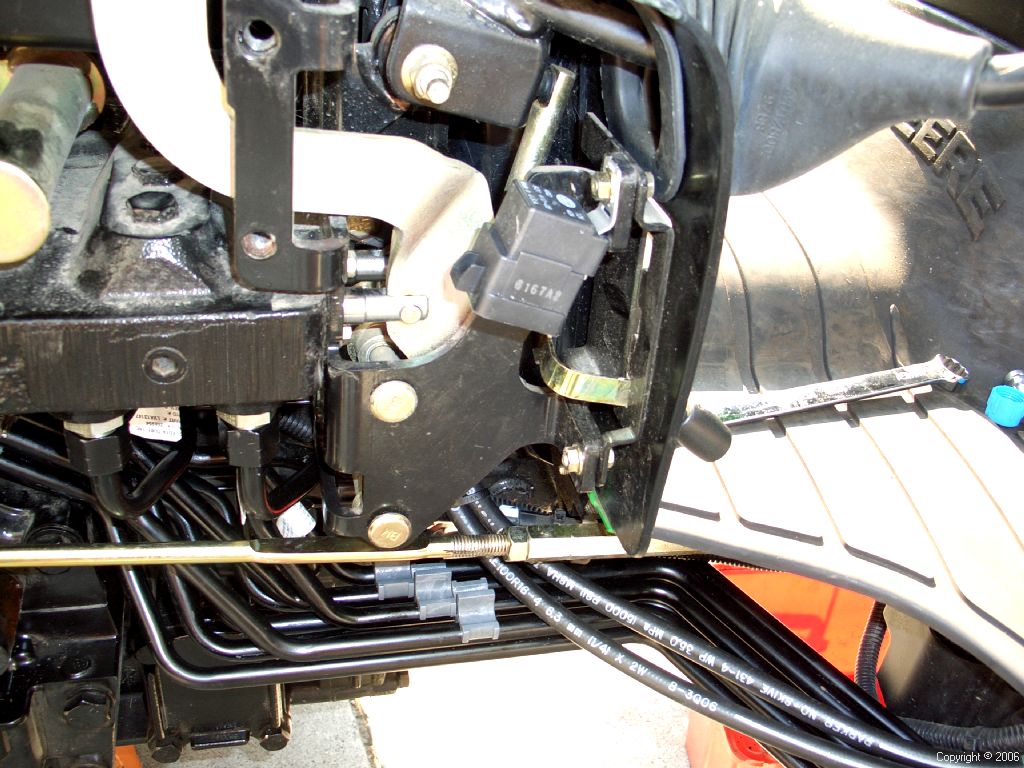

#14

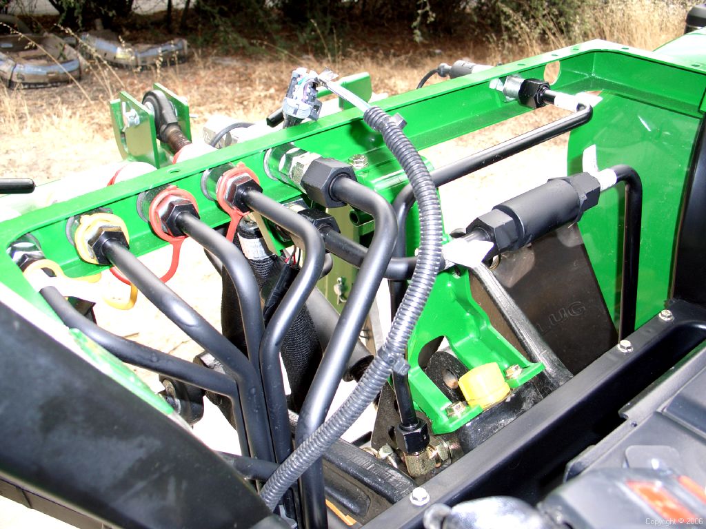

New rear remote bracket, lines, installed into diverter valve. These are especially long pre-bent lines that I found somewhat challenging to route properly. Don't be discouraged, it CAN be done. Spacers are installed to keep lines seperate.

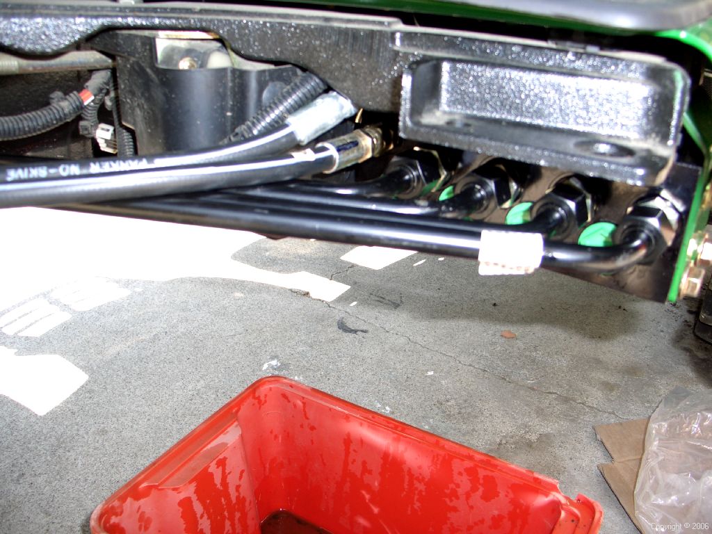

#15

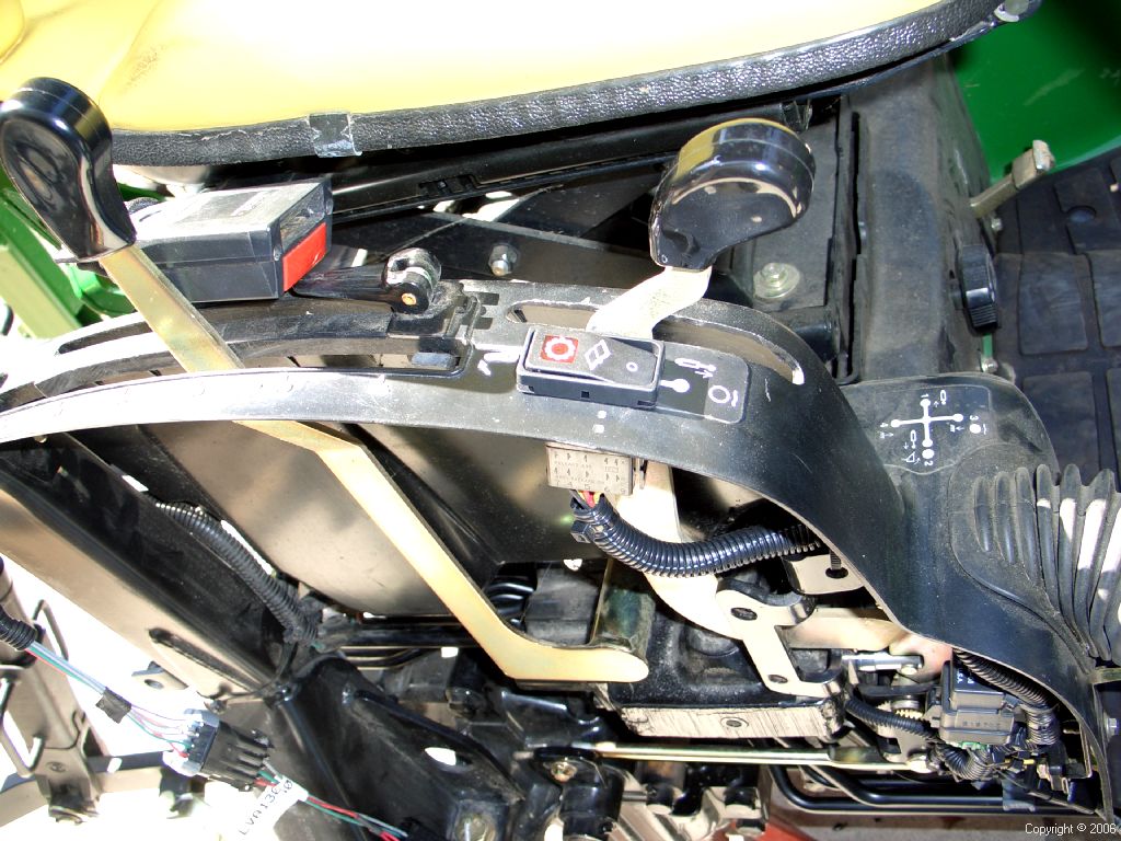

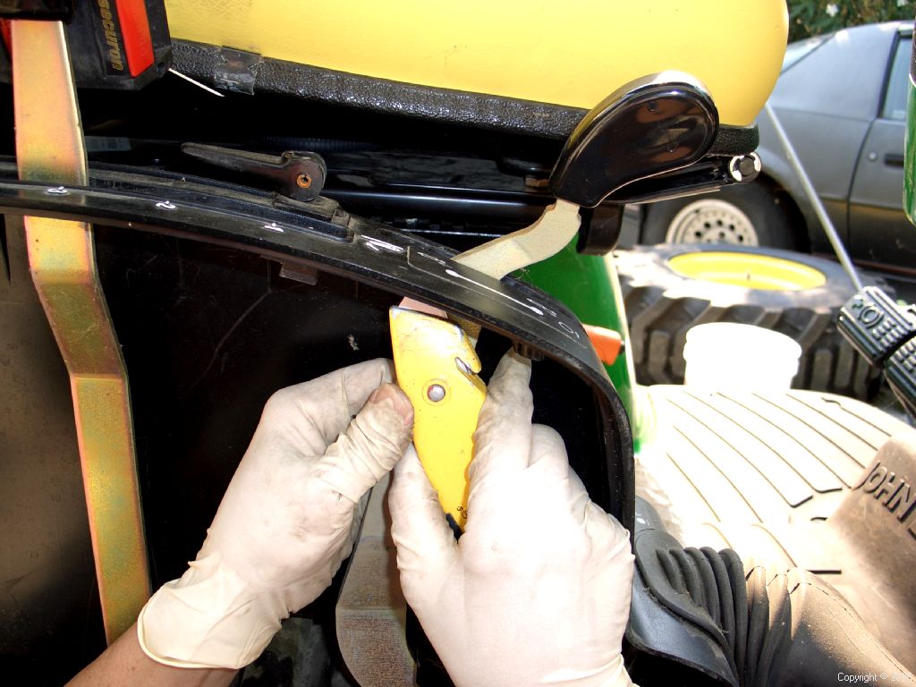

Next up, install the relay, make cutout for switch, route wiring harness. Notes: relay, when installed into specified location, can rub against joystick lockout valve lever. I looked to install at various alternative locations. Eventually, I settled on installing at specified location and bending mounting tab to relay so it is angled slightly which results in an acceptable clearance to everything. I spend a long time, too long, trying to make the switch cutout with utility knife. Eventually, had to dust off and utilize my dremel tool with cutoff wheel. Harness was another beef. The ground lug location was supposed to be installed under the footrest support bracket bolt, that is now completely hidden beneath all the hydraulic hard lines, since installed and torqued. Even if I was able to access the nut (not), it would not be possible to unscrew as the hard lines were only 1/4" or so from the surface of that bolt. Needless to say, it was impossible to utilize the specified location without disassembling 1/2 of the work already performed. I looked for and found an alternate location about 3 feet away -- too far away as the harness clearly was designed to utilize THAT specific location. The harness needed to be extended to use the new location and required a trip to NAPA to find weatherproof connectors and such to make a good splice. Weatherproof shrink tubing over soldered splice hopefully ensures a lasting repair. This part of the installation really tested my resolve to refrain from calling the person who wrote the manual downright stupid. I lost another day and had to modifiy the kit simply because the manual couldn't specifiy the correct order to do the installation steps.

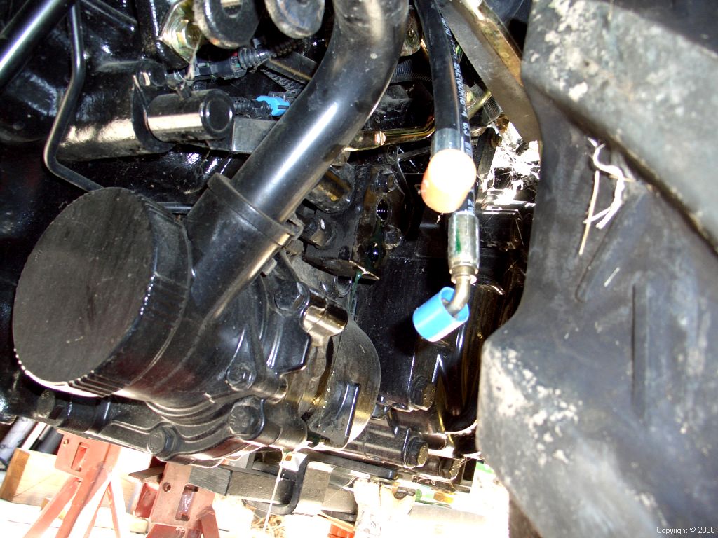

#16
TESTING TIME:
With the harness installed, now is the time to test the installation before buttoning everything up. Tractor started up fine and a quick peek revealed NO leaks -- hallelujia! But tractor dies shortly thereafter. Oh no, what gives. Oh yes, I forgot to turn the fuel line valve back on -- problem solved. Operated loader, no problems. Flipped diverter valve switch but it does not light, oh-oh. Sure enough, operating the joystick still operates the loader. Time to recheck the harness installation. Checked and rechecked -- everything A-OK. Tested for power at relay, OK. Hmmm. Tried it again and this time, pushed button more forcefully -- voila! Button lights up and circuit is diverted to rear remotes! Yes! The switch is a special 3 position design where there is an OFF-HOLD-ON with the on position being a momentary position. You must push down on the switch to the momentary ON position activating the valve. The switch then bounces back to the hold position where it remains (valve remains in divert position) until you turn it off. If you shut off the tractor while it is in the Hold position the valve will remain in the default mode (non-divert) until you activate it again by momentarily depressing the button to the on position. I guess this ensures that the tractor is always in the default position until you expressly activate the divert mode, no matter which position the switch is in when tractor is started.
Re-installation of the removed parts (fenders, etc) completed the installation. The attached image shows how your tractor will look when opened up for accesibility before reinstalling fenders, control pod, and wheel.
Also while the tractor was open and accessible, I decided to add power beyond at the same time. I'll try to post that installation in the future. With the console pod off, I also installed the cruise control option (automotive style), which was a piece of cake.
Hope you all find this interesting and informative. I thought I would convert the entire post into a pdf. If there is sufficient interest for a pdf version, I'll be happy to post one (or email you one.)
