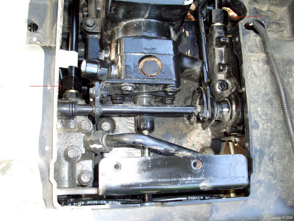

In my opinion, the 3rd SCV and power beyond are two seperate installations entirely and do not overlap. Therefore, install it if you want but doing it at the same time as the 3rd SCV won't make it any easier.
Wait, I take that back. During the Power Beyond installation, you will remove a bypass line that loops fluid from one port to another. You've already got all your tools out and already in the wrenching mode mindset. I am the worlds biggest procrastinator (had the kits forever before actually doing the install) and if you're anything like me, this is the perfect time. The installation involves removing the seat assemby as you will need to access the area under the seat. The attached image is of the opening with the seat removed. If you look very carefully at the image, you will see two very thin red arrows. These point to the two fittings of the line which needs to be removed. These are very large (I forget the exact size, 24, 27, 30? ) and there is very little room to swing that large wrench around. Needless to say, the availability of offset or other clearance enhancing wrenches are limited and expensive. I improved the clearance by loosening the plastic shroud (that you see around the opening) although I did try to remove it entirely to the extent of cutting off the vinyl boots on the end of the levers (there was no other way to remove the boots, I tried and spent way too much time on that). In the end, I just worked around the loosened shroud and got the line off. The rest of the installation is to replace that line with new ones. In other words, instead of fluid looping around from one port to the other, it now takes a detour through some quick-disconnect couplers and through a new flexible hose-loop that remains connected all the time, then back to the other port. Going duck hunting beginning of next week so I'll see if I can't get the power beyond installation posted by this weekend.
