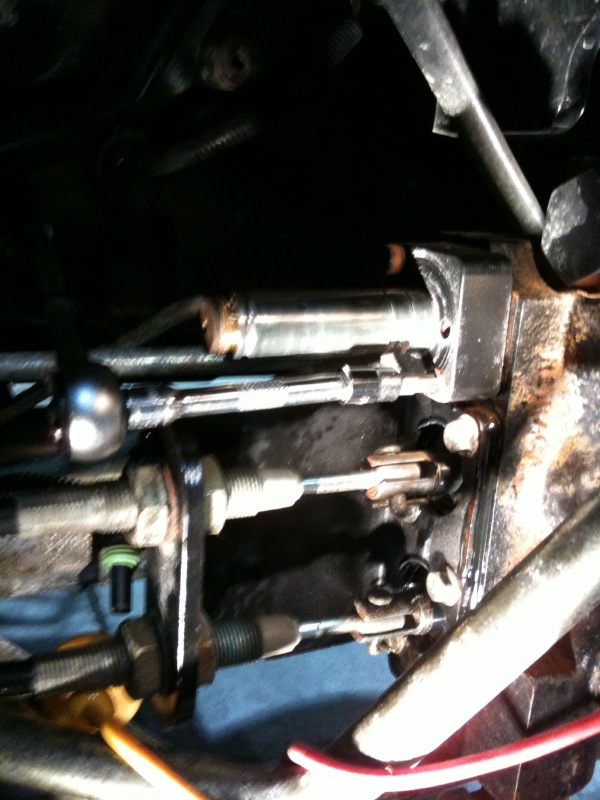

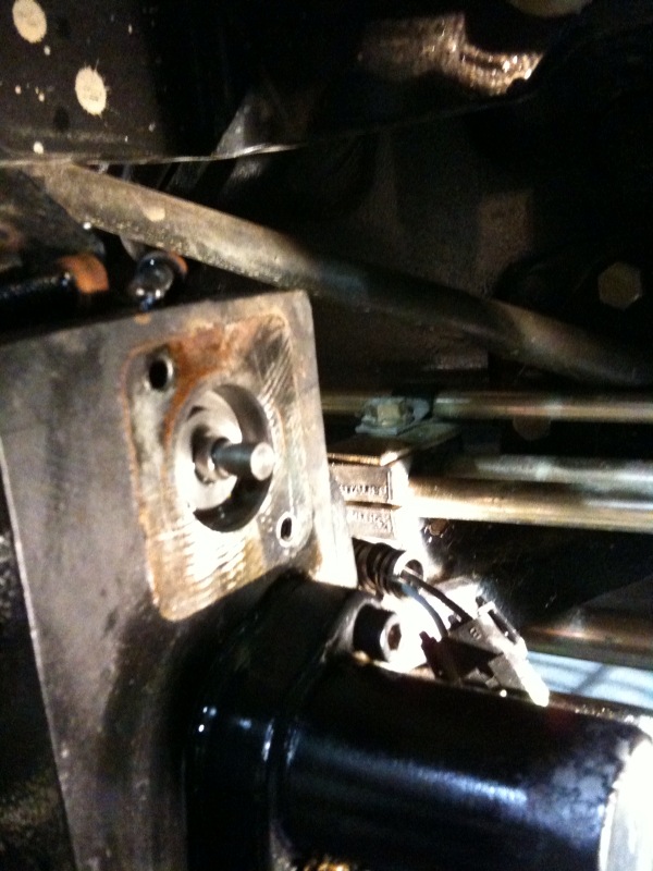

They had to order the parts. They'll be in tomorrow. They aren't anywhere close to normal ones like the ones you linked. They are round steel cylinders that slip over the outer round plunger rod with the windings inside them and a plastic boxes on one side. Here are a couple of pictures I took with my phone so I'd remember where things went but they don't include the solenoids. They go over the round part sticking out in the first picture. The 2nd picture shows the valve that just slides out. It looked just fine.
*edit*
I just realized when looking at the (bad) pictures that in the 1st picture there is a 1/4" drive and extension with the Torx end on it sticking out of the bottom screw holding the plunger on the valve body. The tool makes it really confusing when looking at the picture.

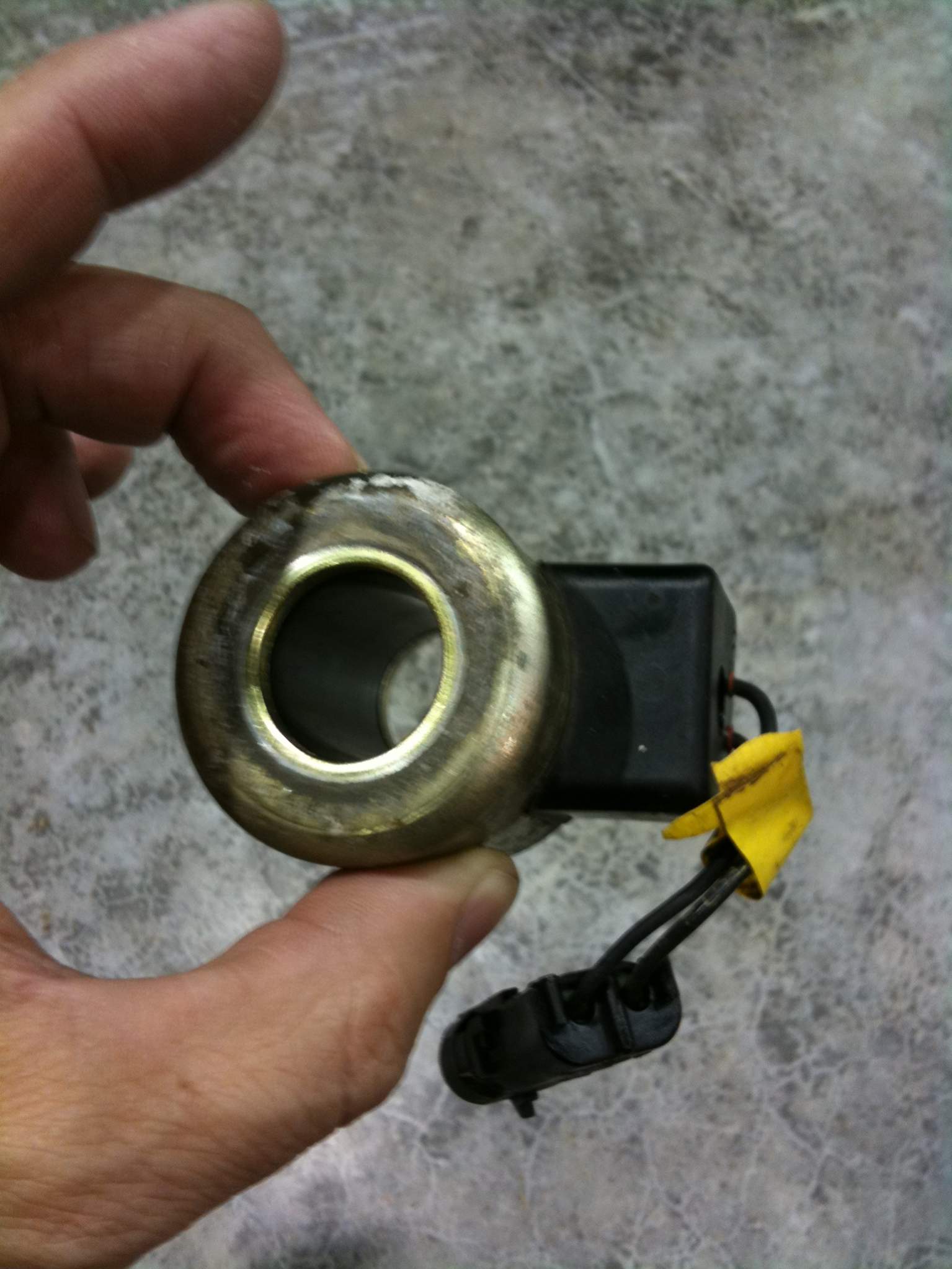

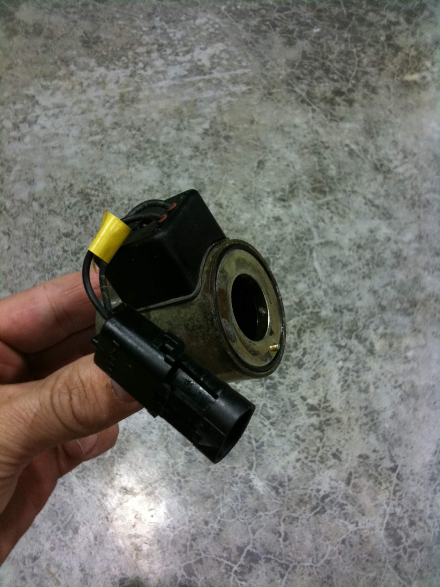

New parts came in today and I had everything working within 10 minutes. Here are a couple pictures of the offending solenoids.
