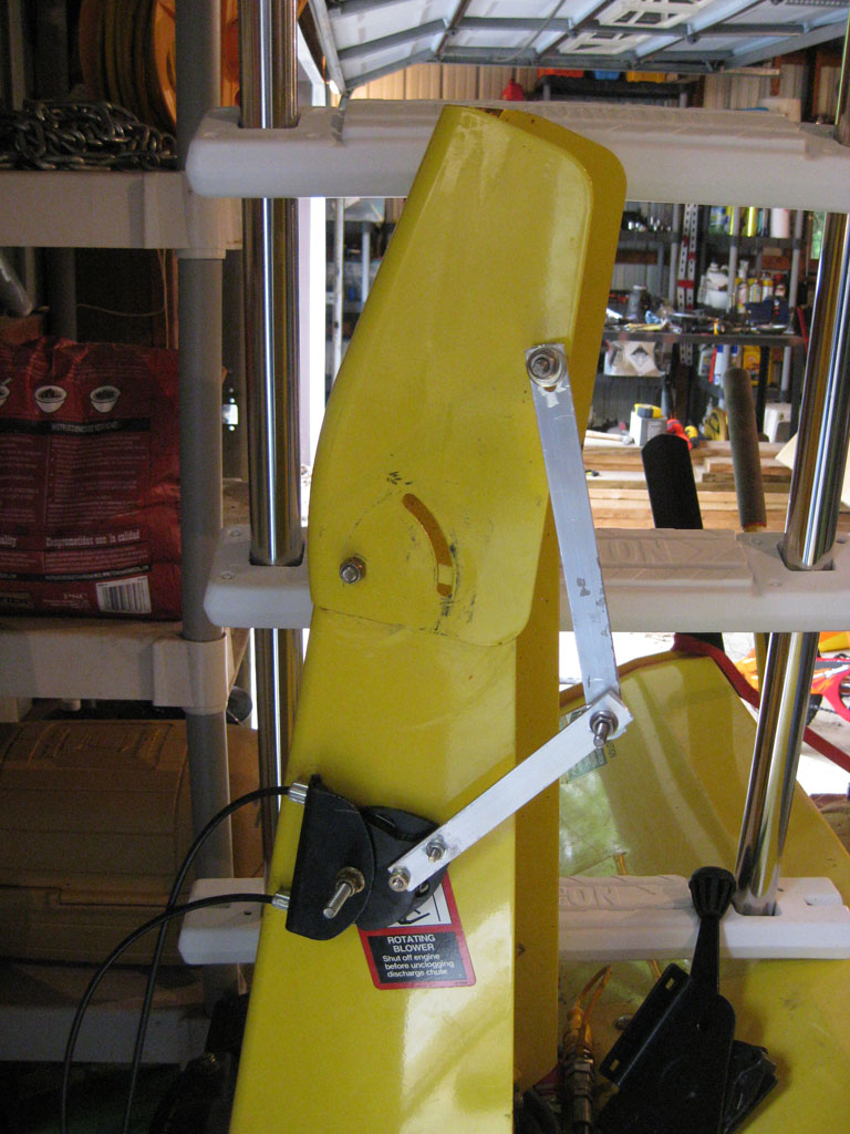

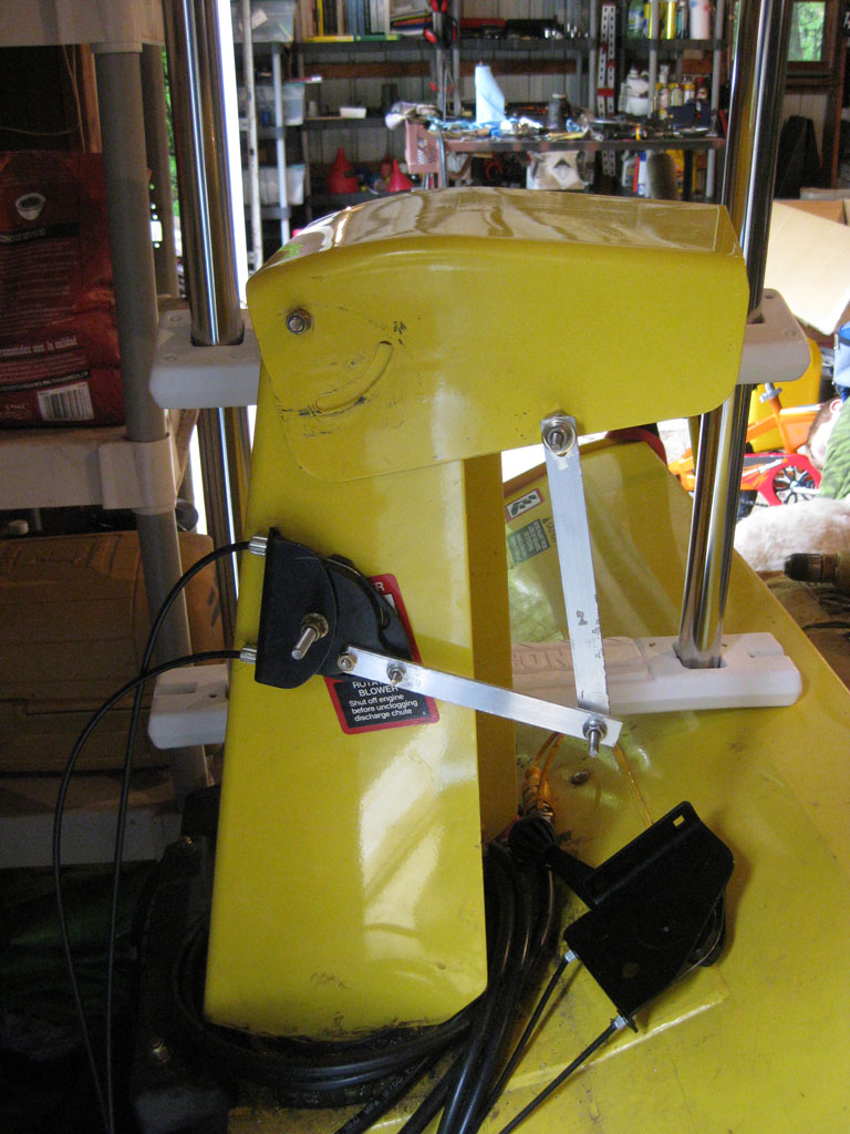

Some progress pics... [got other projects to work on at the same time and this one has the least priority]
I bought some aluminum because I didn't have any small pieces of steel laying around. Good thing too. As Ensoll said, the torque on the cam is pretty high, BUT it does work. Considering I've tightened all the pivot points pretty good and it still works, this is very encouraging.
I need to finalized the pieces to the puzzle now... cone washers, lock nuts, grease, etc. However, now that the proof of concept is working, I'm likely not getting back to this until August.
If anyone has any suggestions, I'm all ears.

The shorter you can make that first leg (the one attached to the rotator), the better your chances will be of it lasting a couple of days...er...I mean...years. Get every last millimeter out of it!
In other words, be sure that when the chute flap is all the way down the rotator is all the way down and when the chute flap is all the way up, the rotator is all the way up. The length of the secondary leg isn't as critical but you really need to minimize the load on that primary leg as much as possible.
   / DIY 59" Snowblower Manual Chute Adjuster
#19
That doesn't sound like a ringing endorsement.... :)
   / DIY 59" Snowblower Manual Chute Adjuster #20
I'm a mechanical engineer who lives on a min factor of safety of 2. I can't tell the integrity of that rotator with only a 2D photo to go by so it's just my observation but judging by the distance between the two bolts holding the primary arm, I'd have to guess it's not meant for real heavy work.
To be frank, heavy wet snow puts a LOT of force on that chute flap when it's pulled down. I'd venture to guess that 100Lbs won't be at all impossible with that big blower of yours. The longer your primary arm, the more that force gets multiplied onto the rotator in the form of torque. Ice cold thin plastic under cyclic fatigue due to varying loads of snow....I dunno.
I really hope it works great for you. I hope you get to put up a video of you blowing 3/4" gravel into a cement mixer with a beer in your hand and giving me the finger. :drink:
