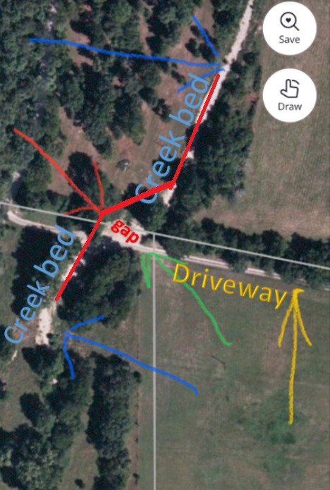

Downstream neighbor says I can do anything I need, except cut down a bunch of trees. New upstream neighbor says I can work on it below his water gate as long as I don’t dam up the creek and cause more back up to the creek. His water gate is about 50 feet from my easement line, so that gives me room to get a dozer in there.
Would your neighbors allow you to straighten the creek bed to get rid of the dog leg?
Yes. I can take out the doglegs so the water doesn’t run down the driveway but it will be at a slight angle.

If it is possible,it would be best if the stream flow is straight across your driveway, and any direction change (which slows water and deposits sediment) occurred upstream or downstream of your driveway.

  1. So, is this your primary residence now?
  2. How many days/year is it currently impassable?
  3. Does the stream flow North to South or South to North?
  4. In the areal photo, the stream bed is amazingly straight. Was that path created by man or nature?
  5. Can you move that dogleg upstream or downstream so the creek flows straight across your driveway?
  6. When the water is high across your driveway, is the current still, slow or swift?
  7. Can you move your driveway to an upstream or downstream crossing?
Lots of questions I know, but related pieces of the puzzle.
1. Yes, primary residence.
2. Days / year when it’s not possible varies. There are probably a total of only 4-6 days where we can’t cross it in a 4WD F250. When that happens it’s usually just a day at a time, two at most. There’s probably 6-8 WEEKS a year that we can’t get the cars out. That’s usually a week or two at a time. Last spring/summer was pretty wet here and we probably had to leave the car on the far side of the creek for about 6 weeks.
3&4. Creek flows North to South and was created by nature.
5. Can’t move the dog leg as in only have a 30 easement. Can try and do away with it.
6. The current is usually not so swift that I can’t wade across in chest waders. Only one time that I remember when it was too swift. My wife is 5’9” , 110 pounds & it’s too swift for her at times. If either of us would happen to slip or get knocked down, we’d be in real trouble. Plus we heading into our late 60’s now.
7. The crossing is at the NE corner of my property. The property runs 1320 ft south but the distance between my land and the road increases. I haven’t talked to that property owner about the possibility of moving the easement or selling me a swath of land at my southern border. It would also need a lot of dozing but there’s no dog leg in that area.

Part of the problem is, over the last 20 years, the creek has moved a bit. It used to just flow across the drive after heavy rains. Now water runs and hits my driveway at the east end (bank) of the drive then doglegs west, with half the water turning south after about 30 ft and the rest of the water running down my drive 40-50’ before running south. I have an easement 30 ft wide X about 200 ft to the county road. The creek has another dogleg to the east just after my easement. That property owners has told me that I can have the area dredged to help with the flow.
Thanks for commenting.
Would that property owner let you dredge/move that dogleg upstream (or downstream)?

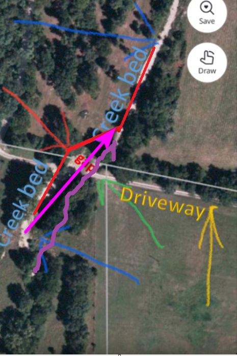

I wonder how that dogleg came to be. The tree line suggests that the creek may have moved in a different path along the trees at one point.

I wondered about that as well. It looks like it is back against the treeline farther south.
