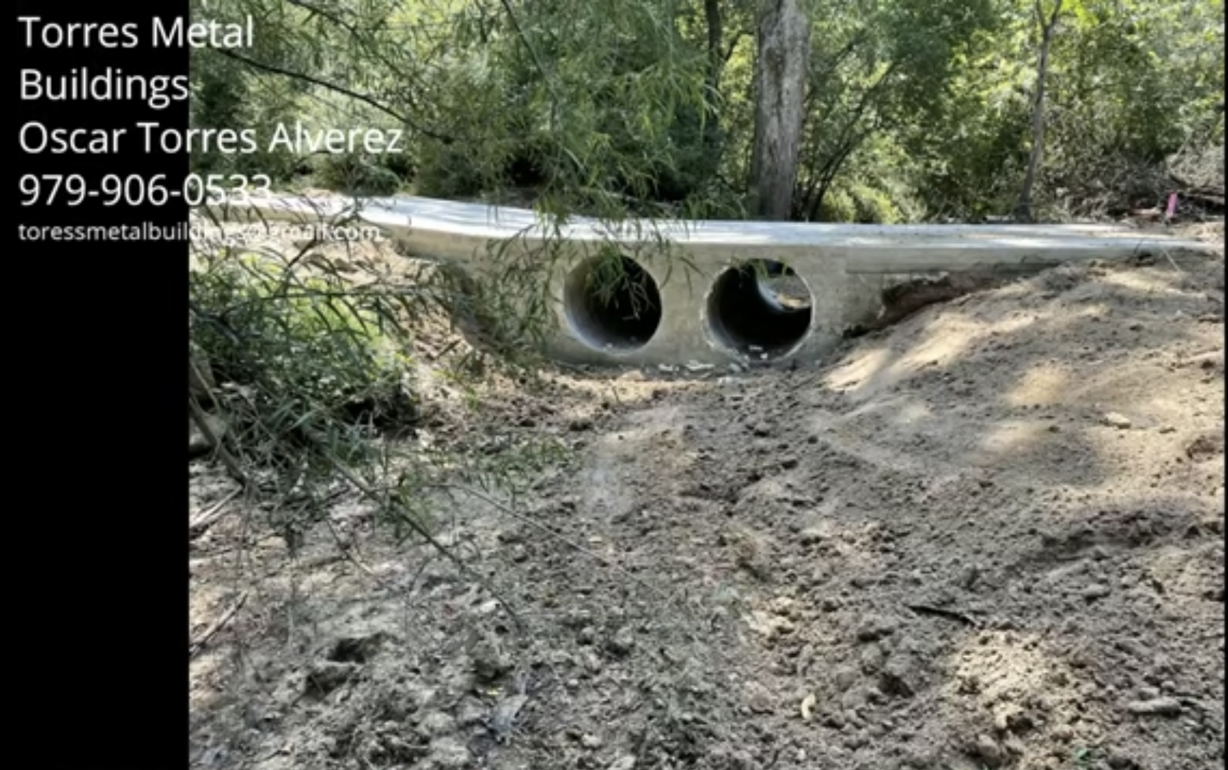

I have a fry creek that runs across my driveway. After heavy rains the water runs through & will get up to 3-4’ deep and might run 60-70’ wide. I want to hire a dozer to come and clean the creek bed up (push gravel to the banks and straighten the run a bit. After that I would like to install two 36” HDPE culvert pipes. The plan is to trench out a footing on the upstream side 24” deep under the culverts, pour concrete in the trench, pour 12” of concrete on each side of the culverts as well as between them. Use 3/4” minus to fill any voids in the driveway and ‘level’ it out. After that I’ll pour a 6” concrete slab on top with #3 rebar 12”OC. The upstream side would be concrete (to keep the water from getting under the bridge) & footings would be on each end of the slab. This is the only access I have to my house & property and it would need to be able to stand up to occasional heavy traffic. ( concrete trucks, logging trucks, triple axle trailers & such) Will in work? Am I going overboard, do I need more ‘fill’ over the culvert. TIA for your help.I will try and post an example of the bridge I thinking of.

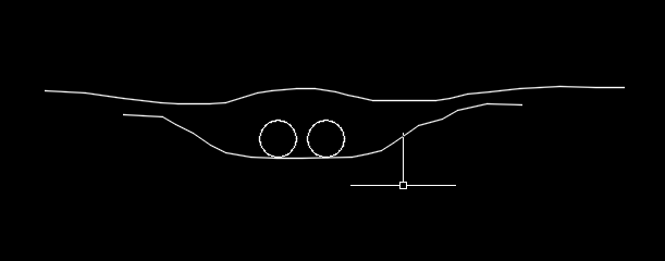

The MAIN point I want to make is your crossing has NO protection on the bottom side for when the water goes over the top. Water will dig out the botttom side, and the erosian will work it's way upstream.

It is hard to estimate without knowing all the data necessary to do the calculation... in order to calculate you need to know the 100 years storm precipitation for your area, the stream basin area, the upstream volume and the flow of that volume... without these it is impossible to calculate... so if you don't know and won't find out then overkill it, perhaps have three pipe and have the road build as demonstrated below so if it's overflow it will flow on each side of the culvert on the road.
other than that, my opinion is most of the concrete work seems over kill.. thrench out 12 inch below the culvert grade and back fill with A gravel, compact, back fill the rest with A gravel and compact every foot... if you want a up stream and down stream concrete bulkhead fine but the rest is over kill.

I would strongly recommend that you contact the National Resources Conservation Service (NRCS) or Local USDA office. I am in process working with them to engineer a similar structure. This will be an expensive endeavor and you will want to get it right. At least here (Texas), there is no charge for this. They can offer a detailed plan for construction and are able to view not only your soil types, but maps that can estimate the water flow amounts and speeds (drainage) you will encounter.
So, some may tell you how-to and I respect their opinions, but one mistake can lead to total destruction. You can compromise the plan they offer of course. But it is definitely a good way to start. My 2 cents.

Would like to build it to function as a low water crossing (after a heavy storm/rain with water washing over the slab) with the hopes I would be able to cross it sooner. Have not read all replies yet but many are saying the downstream side of the slab will probably need the same amount of concrete to keep things from washing out whenever water spills over the slab.
