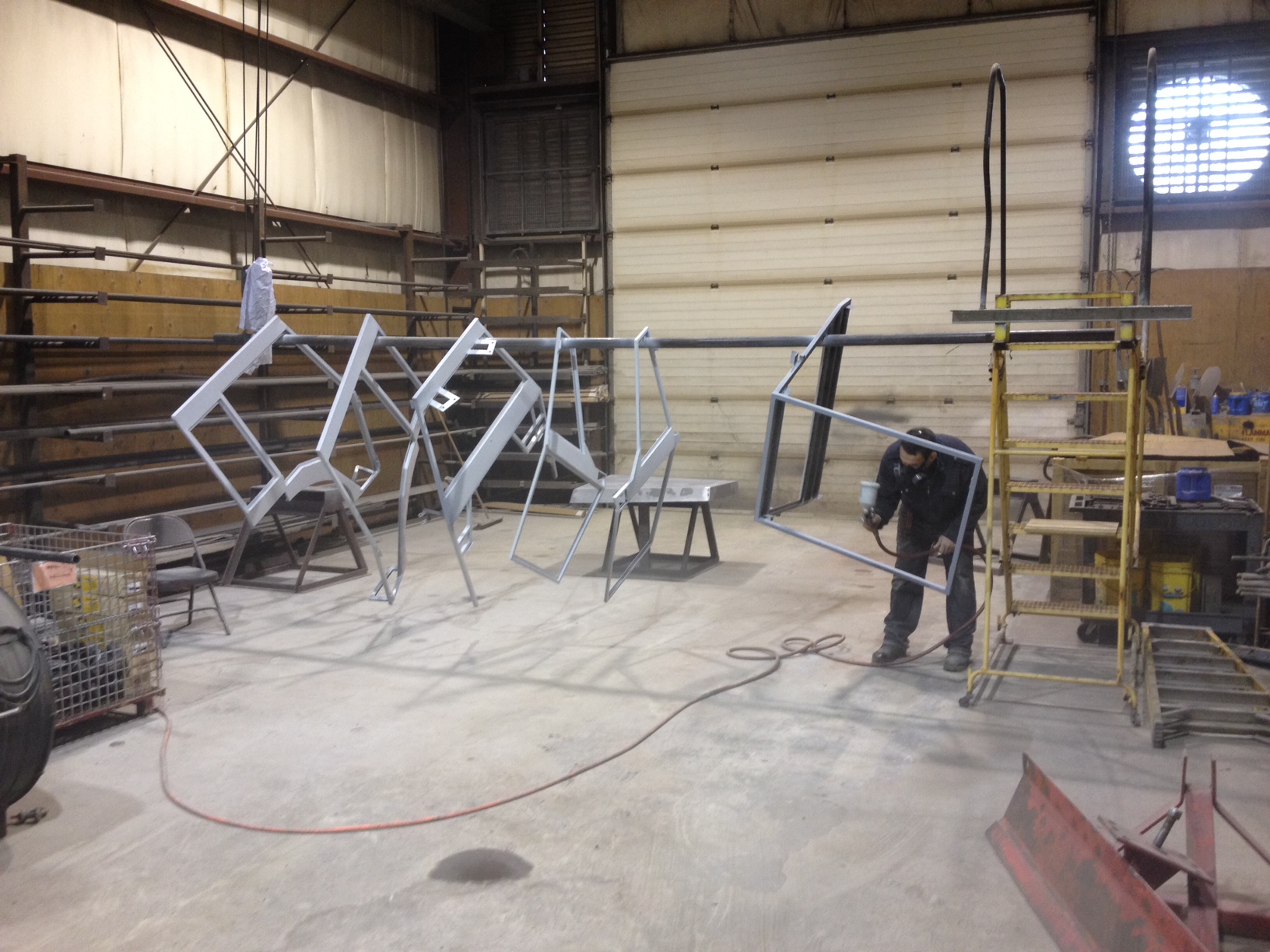

How do these projects end up taking so long to complete? I thought the cab would easily be finished before Christmas, and now New Year's Day will pass before the thing is done. At least it's getting closer all the time. I was off work this past week using up vacation days. Managed to get the heater "plumbing" ready to mount the heater, finished light mounting brackets, did a layout and made a small switch mounting plate and with some assistance from Santa's elves completed the bodywork and shot the primer. Finish painting is scheduled for Monday - fingers are crossed.
When we do the finishing touches and assembly I'll take more pictures. Some of you may find different facets interesting and perhaps useful. I know that I benefited from researching cab builds others have done. If there's something from my build that can help someone else that's great. It's been a lot of fun most of the time. Probably the most challenging thing (except for estimating the completion date) was working with the odd shape of the tractor. It wasn't like building a dog house or installing cabinets in the laundry. Not much of anything on it is anywhere near close to square, level, round or plumb. Like most tractors, the Kubota is a combination of different angled parts joined with French curves.
Here are the sections. Left to right are the right side, left side, front, right door, left door and "Picasso" is priming the back/top. The roof is on sawhorses behind the other parts.
