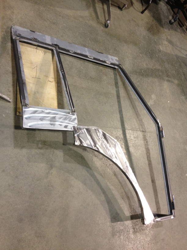

Another great day of "Staycation". Finished tacking the left door frame today. I'm glad I did the right side first because of the learning curve. The door that will be used has the benefit of some experience. I wanted "suicide doors" but wasn't able to go that route because of the shape of the cab. It could have worked but the hinges would have looked really goofy.

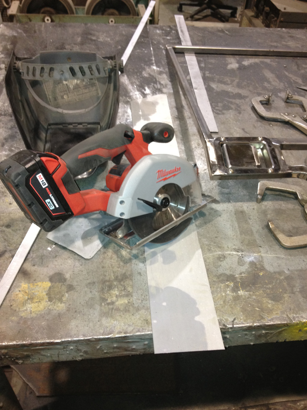

There's a really nifty saw I was using today. A Milwaukee rep dropped it off for us to play with. I forgot to get a picture of it. It slices through the 14 ga 1 x 1 tubing and sheet metal effortlessly. No sparks and the metal stays cool.
Picked up the paint, the amazingly nice gasket came from McM/C, a bud in the sheet metal shop bent a top today and it looks like painting could happen as early as tomorrow. Still some welding and finishing to get out of the way. So far I (actually "we" because a couple of the guys in the shop can't resist jumping in) have around 70 manhours in it and will probably have near 100 till I'm done with the wiper, heater and some revised lights.
Here's the left side with door:

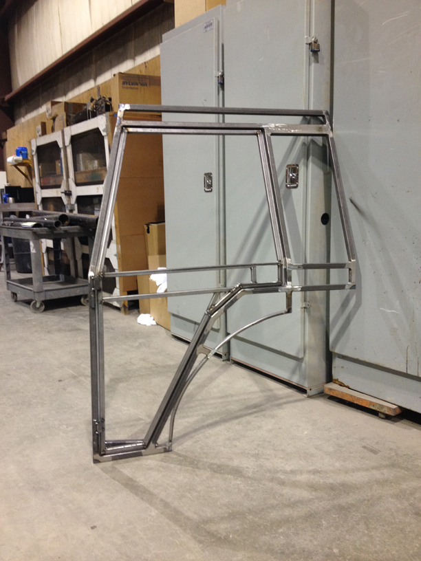

Life interfered with fab work at the end of last week. I did make a little progress, but I'm almost a week behind a self-imposed schedule. With temps nearing 70° today it doesn't look like snow will be an issue this week.
Here is a picture of the hand-held saw that was very useful. The big shop saw is an awesome machine, but the little Milwaukee "cold saw" is a better saw for what I'm doing. Fabbing the cab and door frames meant making many cuts of different angles on 1x1 and 3/4x3/4 square 14ga tube. The little saw cut through the 14ga like butter and made nice clean cuts.
The other picture is the right side panel without the door and the metal skin on it. The door will have a band of skin near the center to accomodate the latch and probably a gas liftgate cylinder to control opening.

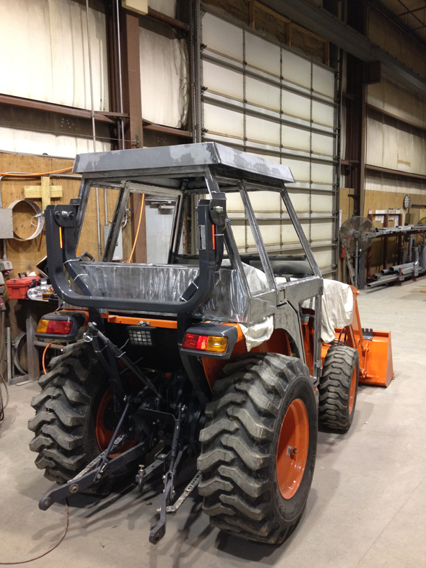

Unfortunately, the project is behind schedule. After spending all day this past Saturday and getting some assistance from the "elves" things are turning around. All the strips have been welded in for the support of the glass. I dropped the patterns (cut from 1/4" luan underlayment) with the glass guy on the way home from work today. Here's where it stands as of today. The component pieces are reassembled into something resembling a cab. They had been disassembled for welding the window support strips, metal skin, etc. There are a couple small things remaining and then it will be disassembled again for painting. Should have paint done later in the week. I'm doing the frame and skin gray and the top orange. Picked up a couple cans of gray trunk paint for the inside.
Here's a shot looking at the rear:

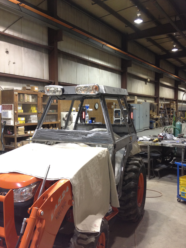

Here's the front. The lights are only sitting there to see how they look. They were freebies from a de-comissioned plow truck at work:

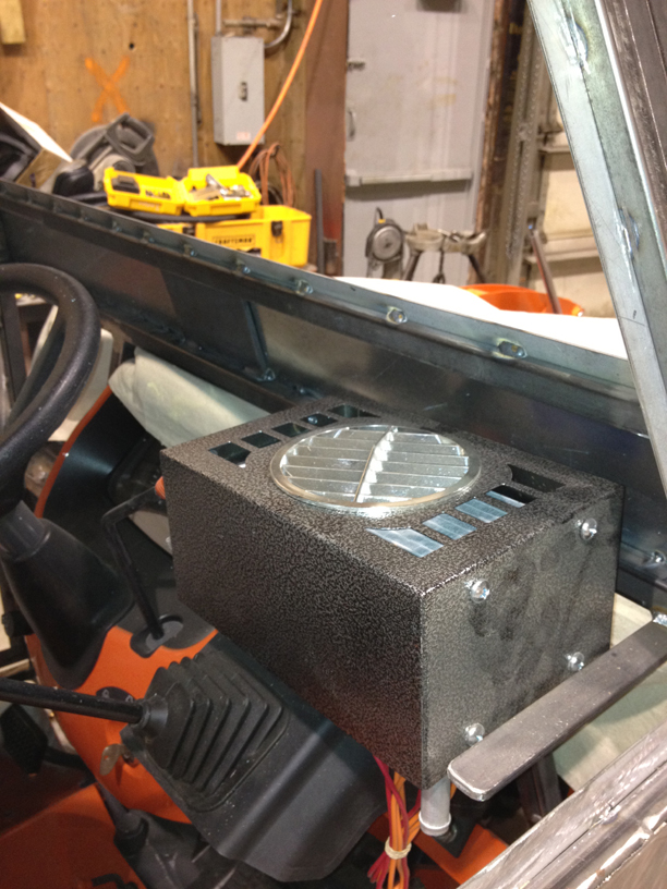

Here's the heater, also just sitting there. Need to do a little plumbing when we reassemble:
