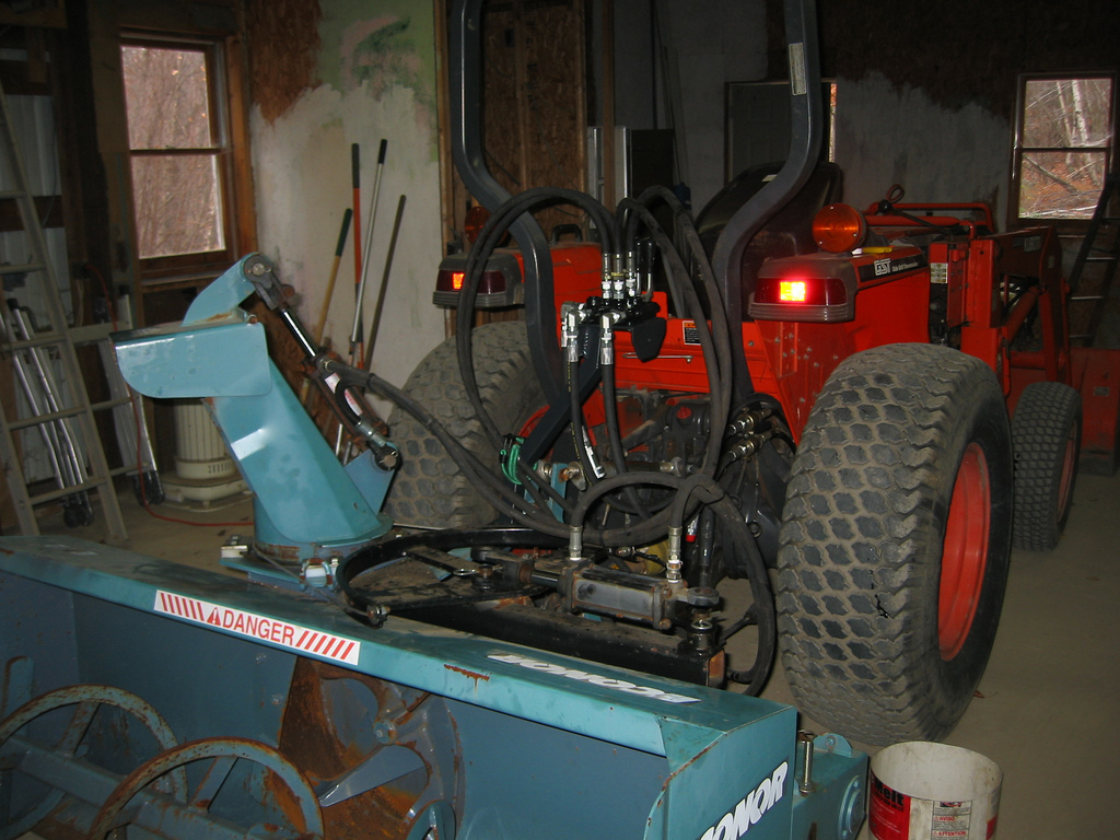

Worked my setup for about a half hour. Turned great. Will be going out today to move some drifts. Temps are in the 20's. If it is going to freeze up today would do it. Will post what happens.

I hope all of you are GENEROUSLY greasing the bearing surfaces of your chutes. I use MOLY-GRAPH grease applied with a little hand grease squirter I got at Harbor Freight. The first time I re-lubed it there was a major improvement, less but much more consistent resistance, That's when I converted to my gear motor drive system (see Hydraulic conversion of a PTO snowblower)-but I won't forget to keep it lubed.

I went the easy route and bought Meteor's electric chute rotator kit through my dealer. It was pricy - $490 for a 12V, 2000# winch with the reel & cable removed and replaced with a gear that mates to the teeth on the blower. It also included the steel bracket to bolt to the blower and steel covers to go over the teeth. I will say that everything fit perfect and works great.
here's a link to the same winch (but with reel & cable): Superwinch, LLC - LT2000 - 2,000 lbs/12V
I'll add some pics if I can remember to shoot a few.

I just bought a 10AMP auto cycling overload relay today. It is the correct size to fit right in the spot that my in-line fuse it right now. So I'm going ot put that in line & hopefully if I go too far or something jams up it will trip on the overload then come back on in a few seconds.:cool:
FYI - I don't know what you are using for a winch, but a typical 2500 pound ATV winch pulls 15A at no load. ~160 amps full load. A chute should be close to no load, but you probably need something in the 20-30A range if your winch motor is similar. I like the breaker concept, but I suspect that you will have short-cycling problems - if so, go a little bigger.

I put a HF 2000lb winch on mine and use a 20 amp in line fuse holder, basically looks exactly the same as the Superwinch.
I also used 3/16 inch galvanized because thats whats been on the hand winch for 6 years from the Smyth factory.

Looked at it again. So the spring is pulling it counter clockwise when you spool out right? What happens with the spring gets all full of slush & ices up? Have you used this is the real world yet?
Not crapping on your design just don't want to copy it if it hasn't had a real world test season yet. ;)
Hey, I'm not sure how this turned out for you, but one idea may be to encase the spring in a bicycle tire tube cut to the length of the spring "extended" and maybe secured with tie wraps (cable ties) It may take some experimenting with where to tie it off as to not get pinched by the spring on recoil, but it would be a cheap option.
I'm trying to sort out a way of remotely turning my chute. I currently have the manual rotator handle cut and welded an old massey steering wheel to it. It's easy to turn and within reach, but I'm still out in the elements getting covered in snow. (cab on the drawing board)

I have used it quite a few times now in cold,wet blowing snow and have had no problems.
