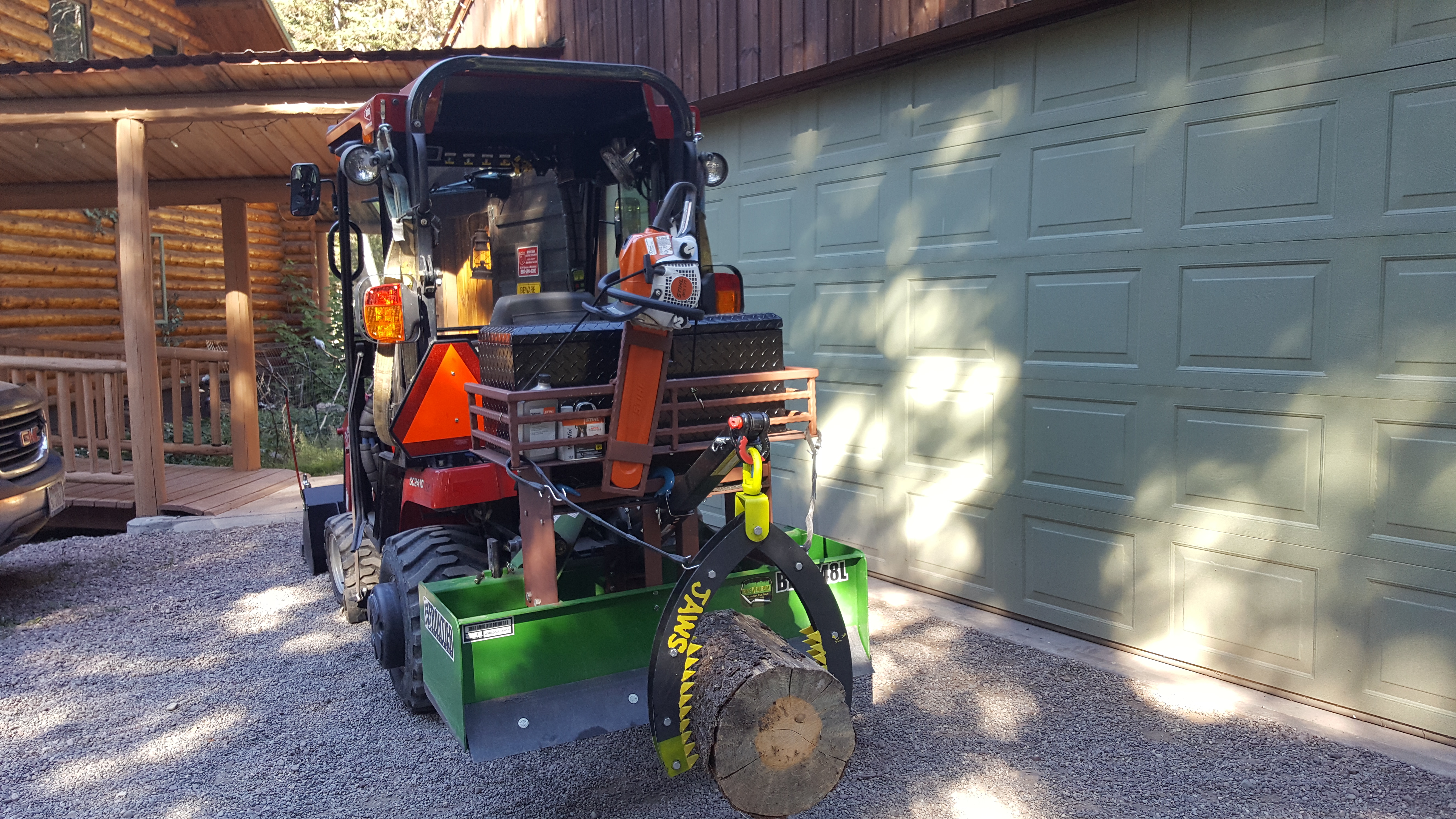

This is what I use for ballast;
my home made weight box, approx.. 600 pounds,
or my Frontier 48" Box Blade (BB2048L), 275 pounds.

Oh man I'm too old for all of that figuring, glad you could do it.
With the Box Blade, sometimes the rear would feel light, but not anymore, because I installed a 1/4" plate platform on top of the box blade with an ATV storage box.
Also when spreading road mix I now have no trouble quickly completing a smooth level driveway in a few passes, because of all the extra weight.
With all of the crap inside of the box, chains, shackles, chainsaw, 2" x 2" tube hitch, JAWS, etc... , I believe it's weight is now about 400 to 500 pounds.

Here's a photo of my modification:
