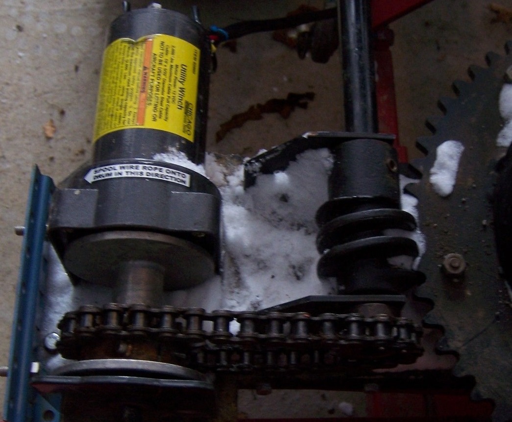

Hello everyone.
Just mounted a new $40.00 winch on the blower and it works fine. I took the spool off the winch and mounted a 8" sprocket to it and used # 40 chain attached to the chute. It was trial and error and took a few days to get it right. I would suggest using a cable instead of a sprocket and chain as a cable is a lot easier and more forgiving to work with. My set up got a bit more involved than I planned. Since I have done mine , I have seen another winch set up that would take at most , 2 hs to install. The winch was bolted to the bar (in this case) that the crank handle is attached to and the guy drilled another hole in the spool and attached the cable in the same way as on the crank and then to the chute. No picture. About the only time I didn't take one.

I managed to get a couple pics of my setup, hope it helps illustrate what I did. I timed the rotation, with the sprockets I had it is about 15 sec to rotate 180 degrees.
Sweet thanks!
Nice set up. I can see why it takes so long now thoguh. It is the type of rotator you have It like a worm gear. It takes a lot of revolution of the crank handle to rotate the chute very far.

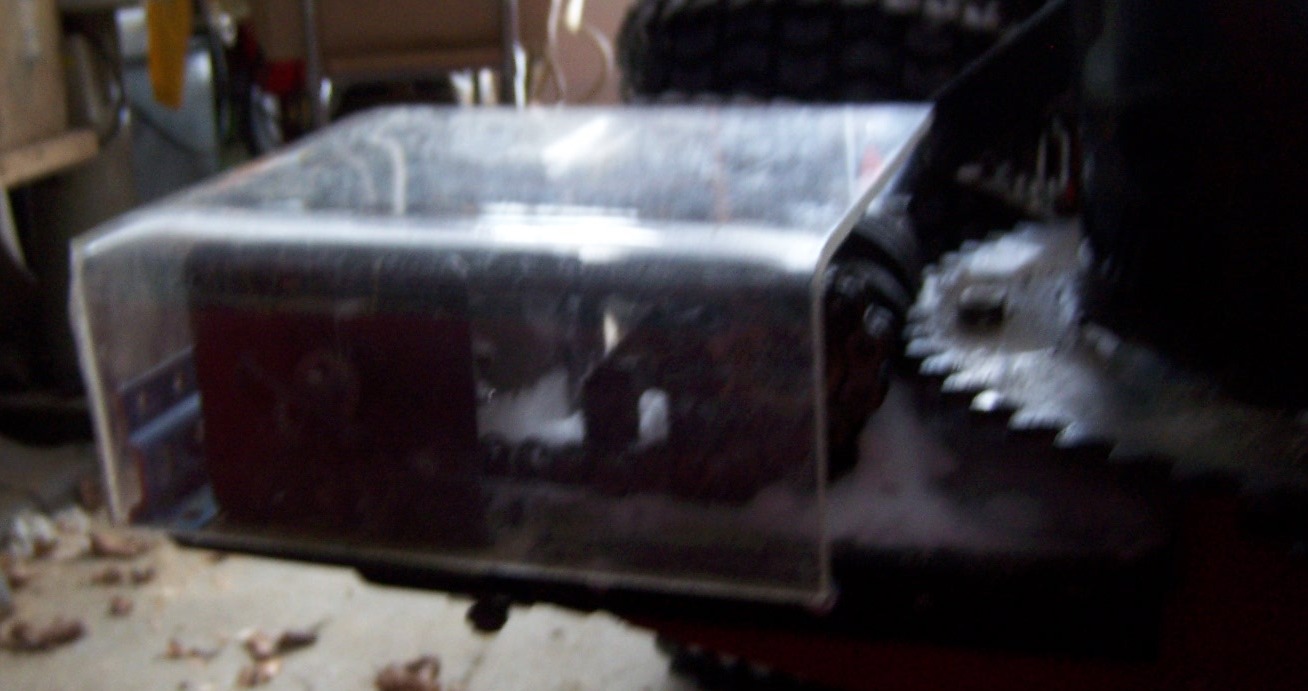

Your 'snow shield' is clever. Need to add that on my 'to do list'
I also use chain/sprockets on my set up and find that ice occasionaly clogs the chain enough to load the motor and blow fuses. (on mine the drive sprocket is horozontal with the chain wrapped around the shute base)
My routine has been to squirt oil liberally before laying up the blower after a storm.
One other thing that I did was to fab a large custom washer from PVC sheets I had that is below the snow shute where it sits on the main frame.
This way the shoot rotates on PVC rather than metal on metal- helps a lot!
I also find (on mine) that the cheap joggled press steel guides that loosly guide/clamp the shoot to the deck are a bad design in that they tend to jamb rather than guide the shute while rotating.

Yeah I worried about snow building up on the chain too. The plexi shield was a scrap piece that I heated up with a heat gun (slowly from both sides) and bent sandwiched between wood blocks. It is held on with a couple wing nuts for quick removal. Knock wood, snow build up hasn't been an issue since I got it going. Used it for 2 hours yesterday cleaning up.
