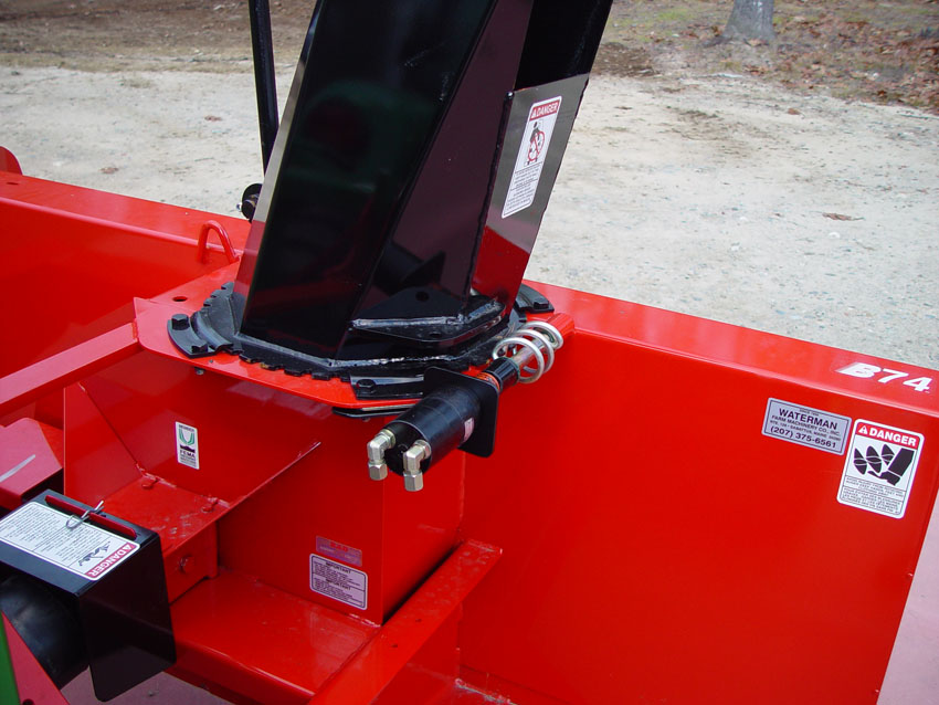

I did the search, read the threads. Stillnot sure which way to go with this.
I have a brand new Pronovost Lynx rear mount blower. The manual chute rotation set up is pretty sweet BUT,..it is REALLY ergonomically unfriendly to try to crank the handle while your already twisted around driving backwards. another thing that happens is the chute rotates SO EASY that it turns on it's own as your driving along snowblowing. Also I'm going to be building some sort of a cab for my tractor so the hand crank won't work anymore.
So here is the current set up>
So,..I can't decide which way to go.
1. Mount a small winch vertically near the chute to rotate it with cables.
Pros- cheap & simple
cons- don't want to mount a winch vertically on the blower & would loose the sweet geared rotator design, & not sure where the cables would go on the chute (not designed for cables)
2. Drive crank shaft with a electric winch.
Pros- cheap & somewhat simple. Keeping geared rotator. If winch motor fails free-spool winch thenuse manual crank.
Cons- would have to make diameter of crank shaft larger some how or it would probably wouldn't turn right. Mounting winch out near the crank shaft may be an issue.
3. Drive crank shaft with a gear reduced drive motor (wheel chair or car window motor)
Pros- cheap or free to buy. Could be directly coupled to the crank shaft.
Cons- May be hard to find the correct motor. Rated for outdoor use?? No back up if motor fails.
4. drive geared chute witha geared down motor (wheelchair motor) with a gear that mates with the gear chute.
Pros-THis would be a SWEET set up!
Cons- hard to find a gear the would mate with the chute ring gear AND fit on the motor gearbox shaft. No manual use back up if this set up fails.
Also couldn't I use some sort of a belt to drive the the rotator crank shaft off from a motor? Like a cogged flat belt around the winch spool & around a cogged gear on the rotator crank shaft with a spring keeping tension on the winch away from the shaft so it didn't slip unless something went wrong.

Pic of Mine:
All I did was build a motor mount to mount the motor to the Blizzard manual rotation worm gear using a Lovejoy coupling.
I Can tell you it works slicker then heck

Making a sprocket to match the teeth on the shute would be easy as those teeth are big and coarse.
I'd consider 2 'washers', say 3" in diameter with a spacer to keep them apart.
Drill holes thru the 'washers' (discs) and simply use 1/4" bolts as your teeth.
Trick would be to space evenly, but that could be layed out using a compass for even angles and wherever you get the proper spacing is where you drill holes to accept the bolts!
Another method (that I use) is to wrap a sprocket chain around the base of the shute leaving you only to get a sprocker to match your wheelchair motor shaft.
Downside is the sprocket/chain gets ice builup.
But then again the 12 volt winch could be treated the same way.
Not to forget that they are rated at 2000#, so ice buildup is not a problem.
Not that I have done it, but the a ATV winch with a dozen or so coils of cable wrapped around along with 2-3 turns around the snow shute would work real well.
You would cut a length of winch cable long enough to make desired turns around both winch drum and a couple of turns around the shute base.
You would then re-clamp the cable on the winch exactly centered and add desired no of turns on it to allow at least one complete rotation of the snow shute. (might be 6-8 turns both rt and lt)
Then do 2 turns around the shute and clamp the overlapping ends to the shute.(a small cable clamp could accomplish that task)
Lokking at your photo, I'd mount the winch vertically approximately where the decal/label is on the backside of the blower looking from the tractor side.
That way you still keep the factory crank as well!
The beauty of the winch is that all the switching and wireing is done for you.
You simply need to provide +12volts and a ground!
Don'y forget to fuse the + side!
Good luck.

First of all thanks for all the replies, advice, etc.
Yes I am capable of fabricating something. I worked in a metal fab shop in high school & have always build my own stuff. One of my last hobbies was four wheelin. I built a unstoppable Suzuki Samurai out of stuff from junkyards etc.
Money,..ah,..don't want to spend too much,..I just bought the tractor last year, had the tires loaded this summer, bought a engine heater last week & the I bought the blower this winter. Gotta lay low for a while (married);).
One thing I should mention is how easy this chute spins. It is a great design. Even covered with snow & slush a toddler could spin the crank. So I can't really see where I'd NEED a bunch of power to rotate it.
I was thinking about it today & I think a very important thing to me is how fast the chute will rotate. If it rotates too slow or fast it's not going to work good for me & I will have wasted my time & some money.
So,..a full swing lock to lock seems to be about 330 degrees.
That is equal to 3-1/2 rotations of the crank handle.
A good full rotation duration is 2 to 5 seconds.
So,..a speed on the rotation crank shaft of 1 to 2 R.P.S. (revelutions per second) would be good.
Does anybody know the RPS on : a small winch, most electric window motors, windshield wiper motors, wheel chair motors????
Now,..I'm not an engineer or anything so I need so opinions on this...
If one of those small winches rotated at say,..2 RPS,...and winch drum is say 2" OD, and the chute crank shaft 1" OD.
IF that was the specs & I hooked the winch to the shaft via a chain, belt, or the cable wrap method,...does that mean that the chute crank would be turning at 1 RPS???

Sure a window or wiper motor will do as long as there is no snow or ice, but guess what? you are blowing snow! and snow freezes and becomes ice, and the colder the harder it gets!
You do need torque!--and lots of it.
Even now I occasionally blow 25 amp fuses trying to break the ice loose.
One trick I have adopted is to liberally squirt oil all over the chaindrive and shute guides. Helps a lot.
The chain links do get iced up easily and that is one reason that I'd prefer the winch/cable setup.
Yeah I SHOULD be able to adjust sprocket sizes to get the desired speed. Like you said a belt may not be the way to go as it may slip once it gets wet to be stiff in really cold temps.
I still don't think I'll have a lot of troulbe with the chute getting stuck because of the design where the chute rides on small blocks of HDPE.
If I go with a short chain & sprockets I know where I can get teh parts for cheap as there is a motorcycle junk yard 10 minutes from my house. They have cardboard boxes FULL of every size sprockets known to man for cheap. I could fab up a sheet metal cover to protect the winch & chain from snow/ice build up.
Thanks for info & advice!
Ok an update. There are like 50 brands of small 12volt 2000# winches out there from $40 to $189. They all are teh same winch from China I think with just different labels on them.
The specs on all of them are:
10.5 FPM cable speed unloaded down to 4.2 FPM full loaded. 153:1 ratio. The drum is 1.25" diameter X 2.86" wide.
So,...engineers out there what is that for a RPS on the winch drum???
