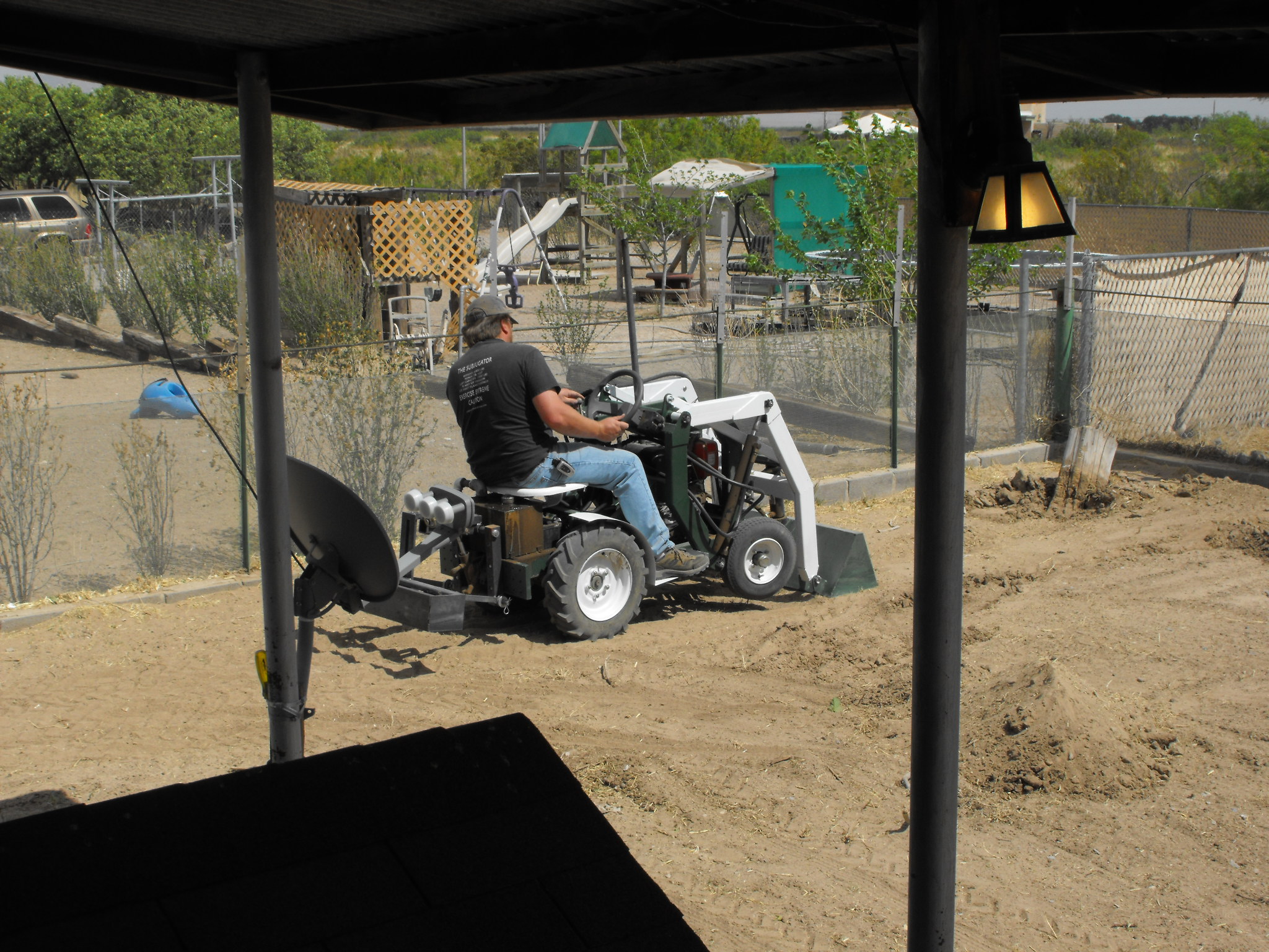

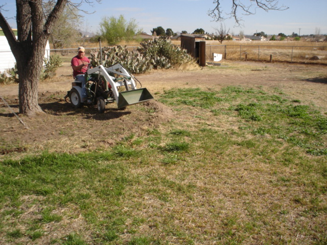

Great tractor! Its looks like it'll be a real workhorse! You really did inspire me, I went ahead and built a small tractor, just on a smaller scale. I have a lot of walk-through gates, so I had to keep mine under 32" wide. Using quick disconnect hydraulics to attach implements, and hydraulic motors to run things like post hole diggers and such.

I'd like to see more of your tractor.

Very cool little machine! Is that a self leveling bucket?

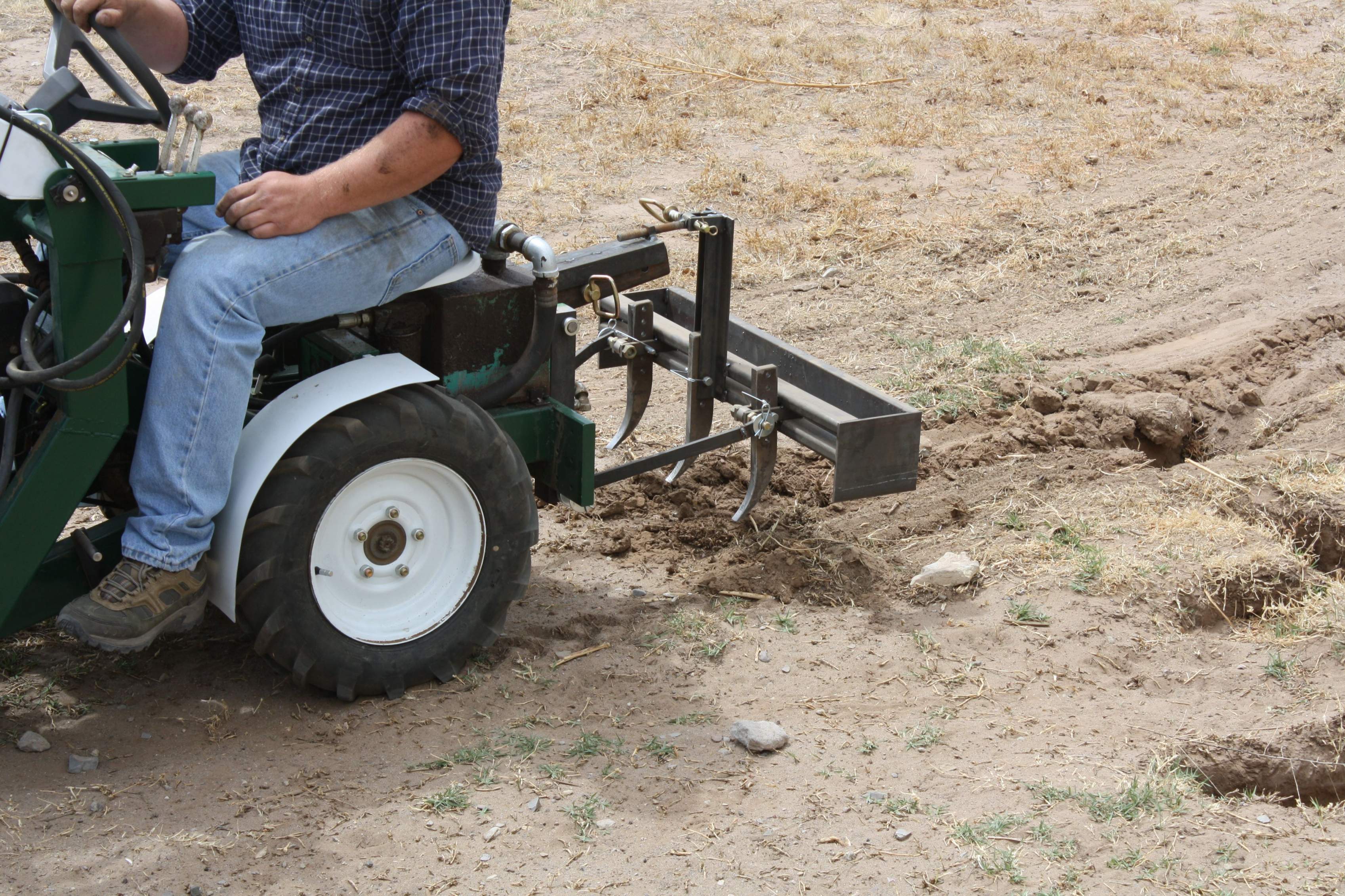

how heavey is that bb and does it have scarifiers?
Its around 80 lbs with the scarifiers. I put three of those on there for now, spaced about 10" apart on a 34" bb width. I didn't really know how deep they should be, so I drilled a row of holes 1" apart so I can set the length with pins. I've been running them about 2-4" below the blade level depending on the traction, is that a good setting?
Thanks! I would call it a self leveling bucket, I set the linkage to give a little bit of an arc, so it does tip upward a few degrees through the travel. I really took a guess about that, but at least it doesn't dump the load on your head when its up all the way!

I'll attach a few more pics, have some video but I haven't figured out how to attach that yet...
