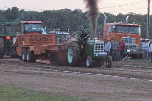

I am new to this forum and found this thread while searching the net on ways of building a homemade tractor. I am very impressed with the tractor that GT2 is building. I want to build a similar one. I have an Oliver pulling tractor and I want to build a small version of it to tow my puller around at the pulls. I would like to make it look very similar to my puller except without the rollcage. I also want the small tractor to be 4 wheel drive so that it has an easier time pulling my big tractor that weighs about 8,000 lbs.
I bought an 88 Suzuki Samurai for $200.00 to get my axles and drive train. This samurai runs but needs carburetor work to run well. This question is mainly to GT2 but others are free to reply as well. How would it work to use the Samurai engine, transmission, transfercase and axles? Would it be slow enough with the transfercase in low range? Our Sami doesn't run well enough yet to see how fast it does go. How short could you make the tractor using the whole sami drivetrain?
I also have another problem. My 13 year old son has taken to the sami and wants to jack it up and make a mudder out of it. I hope that once we get it running and he runs it around the fields for awhile that he looses interest in the mudder.

OP, My tractor has a 6' wheel base. I could have used the sami trans and transfer case but it would have had to been direct coupled to the rear diff to keep the tractor short. Also the whole drive train would have to be lower in the chassis to couple to the rear diff ( might not be a problem for you), resulting in less ground clearance.
The gear ratio might be low enough for you depending on tire size. There are aftermarket transfer gears that will lower the ratio a ton.
You will have to use the same tire size front and rear unless you change the rear diff ratio.

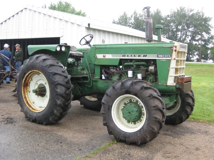

Thanks for the reply. I am wondering if you have gotten your tractor done? I did see where you had taken it for a test drive but I was wondering how it all worked out. One reason that I want to use the sammi transfercase is that I would like to mount my front axle back under the engine. This is how a real Oliver like mine was if it had 4 wheel drive. I was thinking that using the transfercase would allow this as the front driveshaft would not have to go up at such a steep angle.
I did some measuring on our sammi and if I got rid of back driveshaft and the driveshaft between the transmission and transfercase, I could shorten the wheel base to about 48". The main problem that I see is that both front and rear driveshafts are off center so if would shorten my axles the way you did, my output shafts on the transfercase would no longer be inline with the now centered differential of the shortened sammi axles.
I realize that I would have to change the ring and pinion in my rearend if I have different sized tires. Where did you get your slower gears at?
I have attached a picture of ann Oliver like mine if it were 4 wheel drive. I would like to make my small tractor roughly 1/2 scale of my big tractor.

Sigh, No my tractor is not done. I've been side tracked big time by my new property in Idaho ( which is ironic because I could use the tractor there!).
If the drive shafts are long enough some angle to the diffs is fine, but I suspect that your shafts would end up short. Maybe you could rotate the transfer case around to get a better shaft angle?
I got my ring and pinion off craigs list ( got lucky), but there are several aftermarket sami suppliers that offer them, google it.
Thats a good looking tractor!
