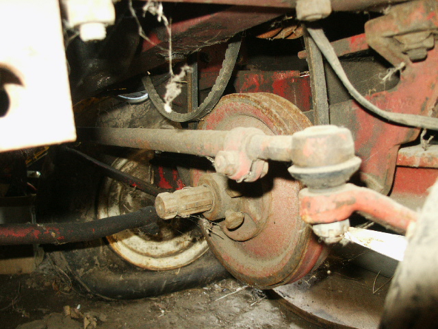

I want to ask if you plan on a front, mid or rear pto. I have a Wheel Horse D-250 that has a all the pto's on it. The front and mid PTO is on a belt pulley off the front engine crack pulley with a hand clutch to engage the PTO for a snow blower or mower and etc.

Here a few pics on how my Wheel Horse front and mid PTO pulley.
